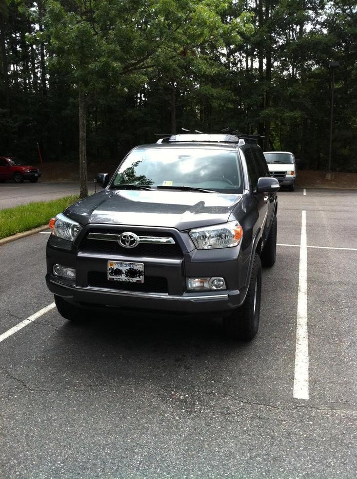

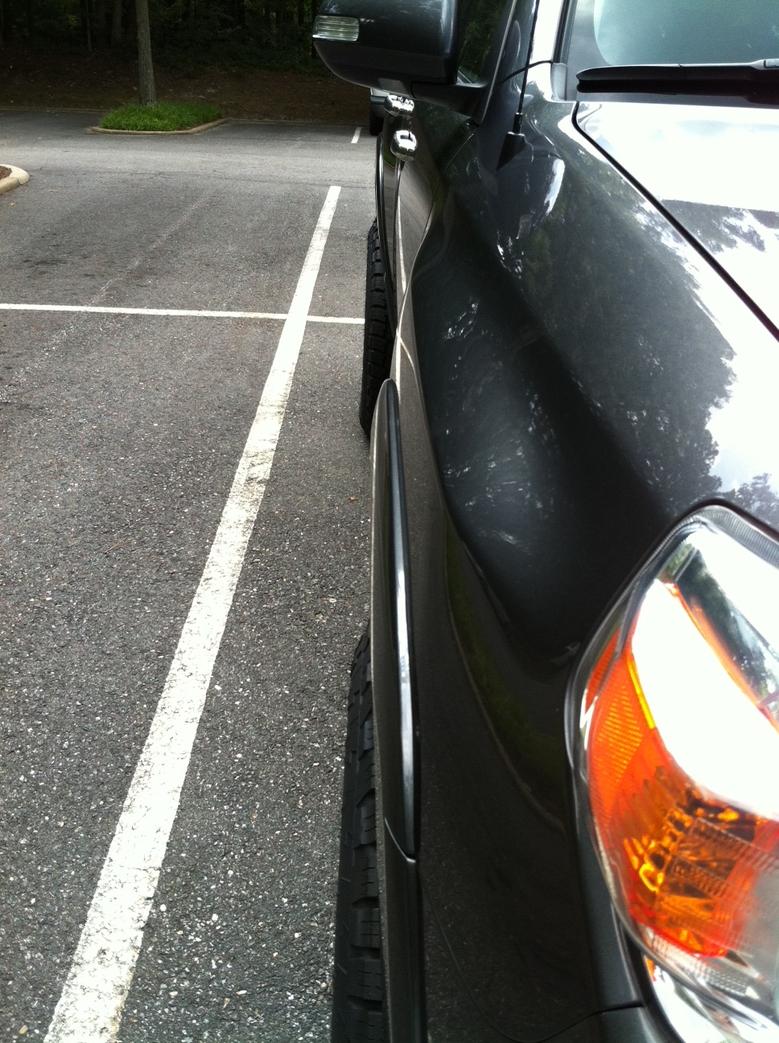

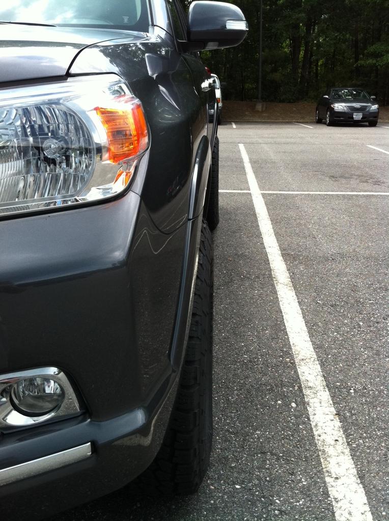

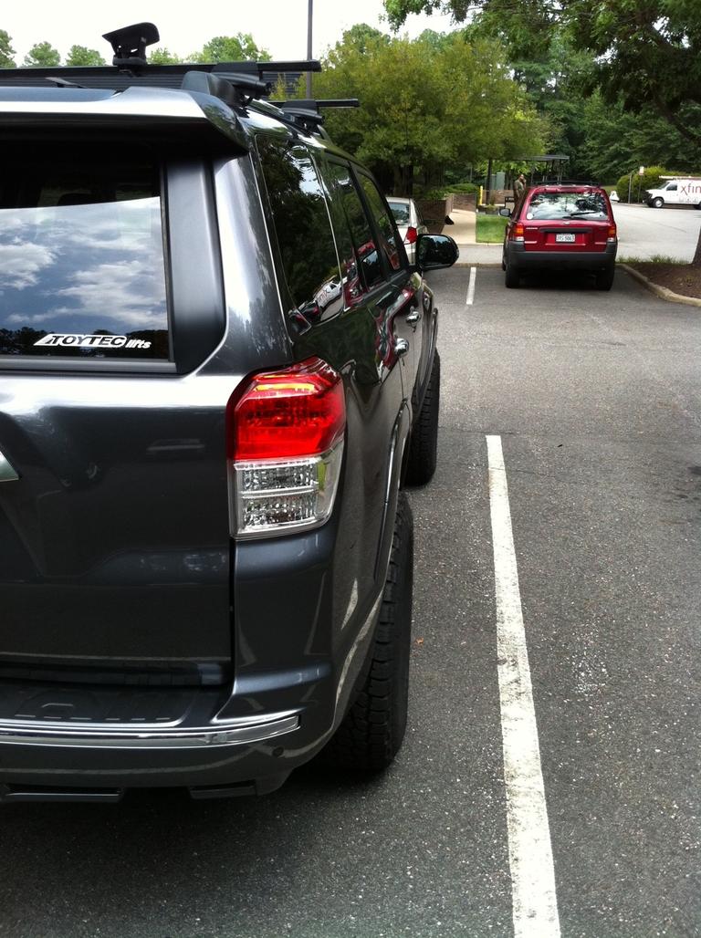

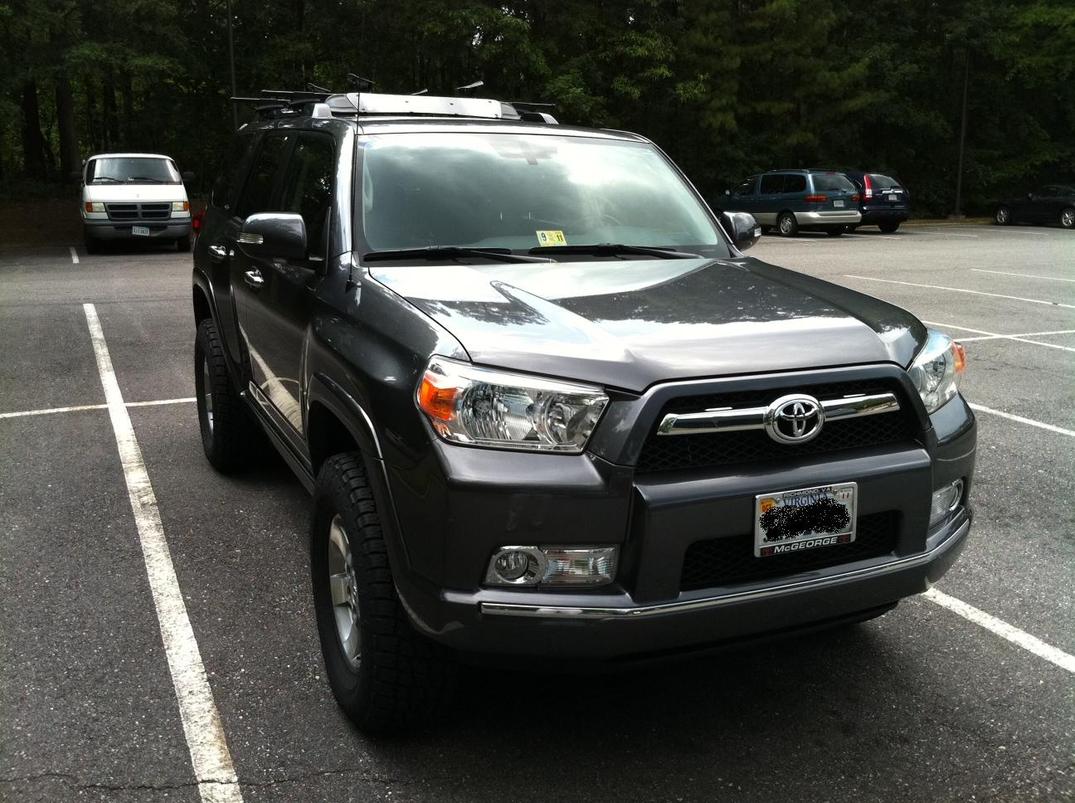

OK...so the last of my initial mods has been completed: added the 1.25" spidertrax wheel spacers ("adapters") which was a piece of cake and makes the stance look sooooo much better. When researching a lot of people wanted pics, but there wasn't much to go by. So...as I did when I installed the 2/1.5 toytec lift...here are some shots of the spacers. Enjoy and hope this helps. Drive feels great and performed well at the outer banks last week.

Looks good!
If my math is correct, your wheel placement should be similar to a 8.75" wide rim with a 4.5" backspace.
Any rubbing?
Yes...there is some rubbing. I had already moved my front fenders forward about 1 inch...I am going to push those forward a bit more to be safe. The major rubbing in on a small plastic piece on the back side - I believe I can remove this piece, but if not...might have to use the heat gun to flatten or trim.
looks great! how's the ride quality compared to stock? I added some bilstein 5100 on my tacoma at 1.25 up front and my ride dramatically changed. After returning to stock before trading it in for the 4runner, I was quickly reminded how nice the stock ride was. I am hesitant on lifting the 4runner, I am impressed with the stock ride quality, I still have the bilstein 5100 from my tacoma but I have yet pulled to trigger on installing them on the 4runner.
Well, the ride quality is a little stiffer after installing spacers, but not by much. Eventually I will get new shocks, etc to smooth that out. The wider stance actually gives me MORE confidence when turning...doesn't feel so top-heavy anymore. The spacers definitely makes the new 4runner look better...like it should look. Kind of like how the older models looked and even the landcruisers.
