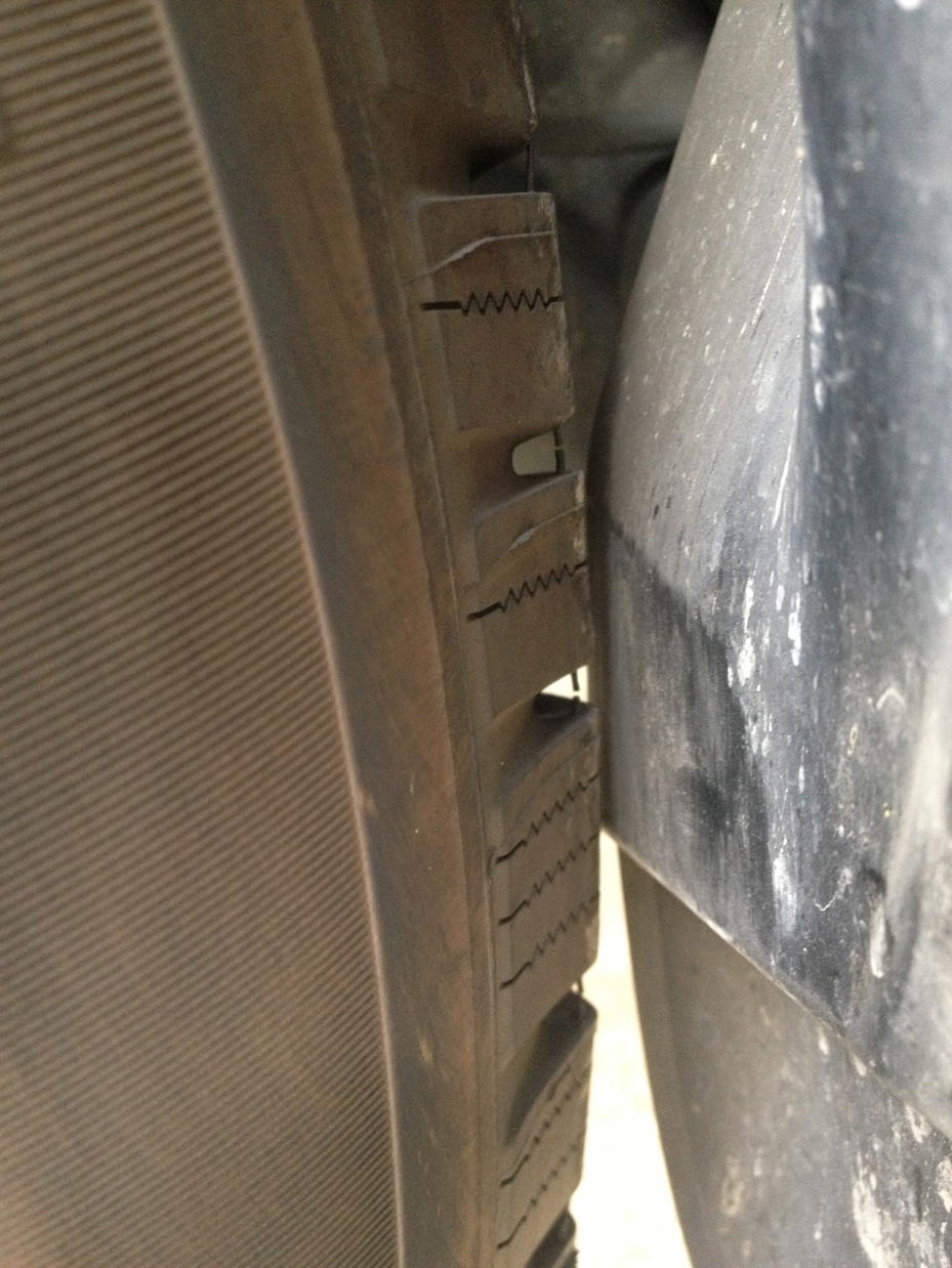

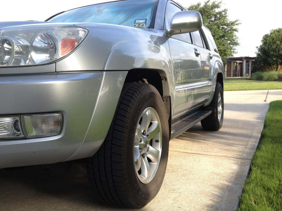

I put in spacers on my 4Runner last September for 1 reason. LOOKS! I was looking at getting a lift, but the 4Wheel Parts store in Austin was charging $750 for the lift/install. I'm handy, but not mechanically inclined. I take my 4Runner to the dealership for oil changes:) and I don't have tools for the job either.
I did all my research on JA's 4Runner website. Lots of good info there!
I asked the 4Wheel parts guys if there would be any rubbing with spacers and they said no- they are technically right. I have about a hairline worth of room in there. If I did need to trim, it's pretty straightforward. I don't off-road. My 4runner is on pavement 99.9% of the time I'm driving it. If you live up north where you get snow/ice, rubbing will be a problem.
My 2 cents. I love the look/stance. If something breaks down because of the spacers

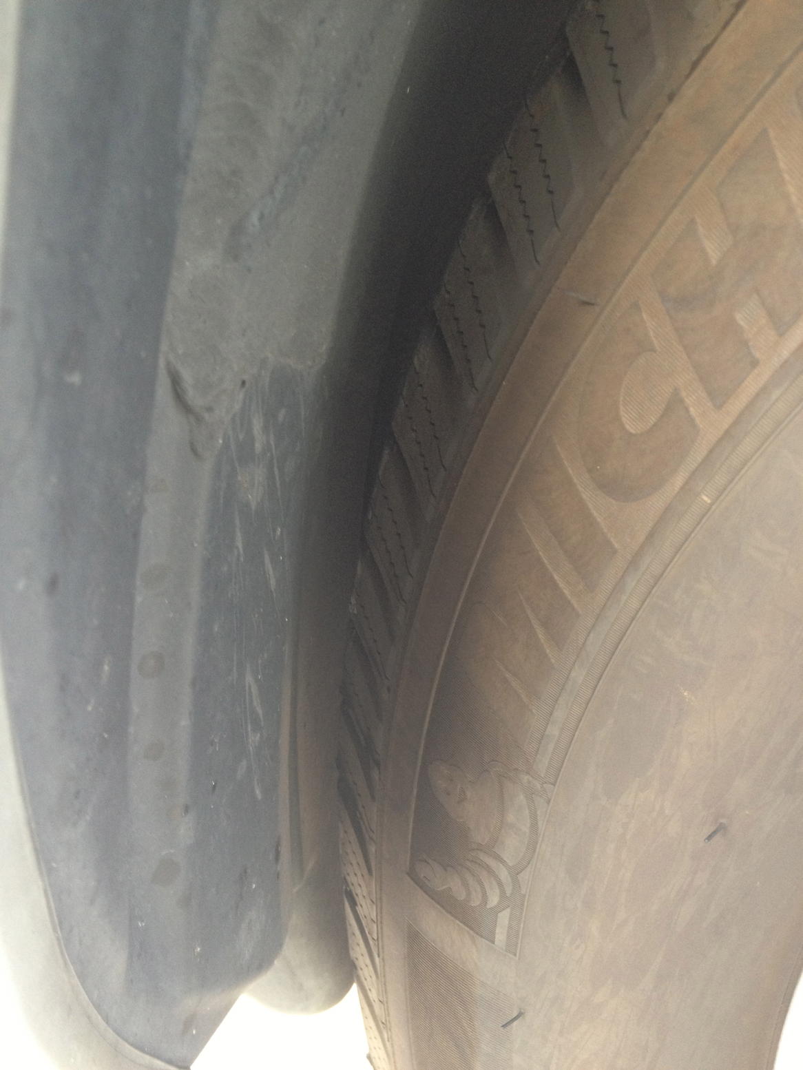

Forgot to mention that I have stock tire size. 265/65/17. I just bought these Michilan MS2 this spring and love the ride.

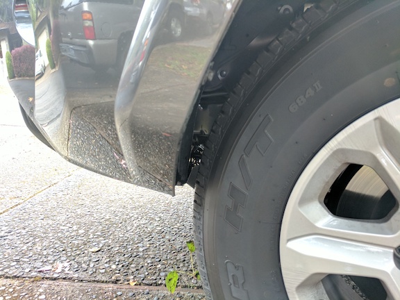

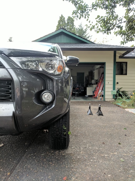

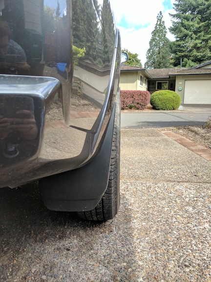

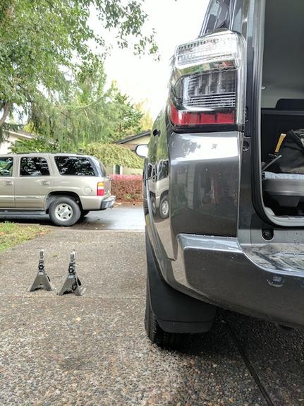

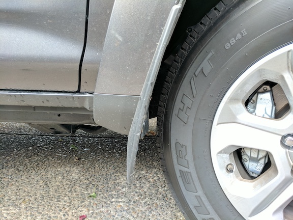

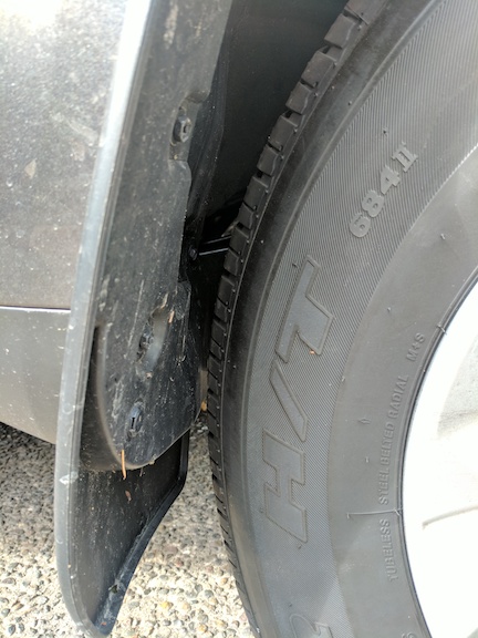

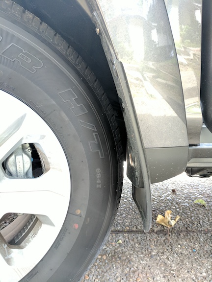

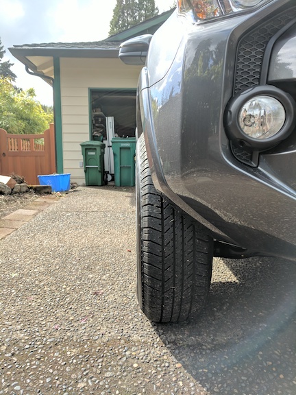

Stock 17 SR5 w/ Dueller HT 265/70r17 (Stock Tires)
Steering wheel is turned full lock to show clearance.
Before:

After:
