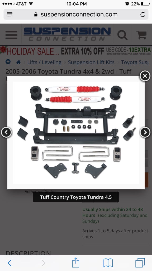

Spindle spacer?
That is some ghetto fab right there [emoji51]
Um, no; I wouldn't say that it would "correct wheel alignment".
It would do some real funky things with the suspension geometry, that's for sure.
I'm betting/guessing/assuming it's just one part in a bracket lift kit, and NOT to be used without the rest of the kit. With the bracket lift, the LCA's get dropped down. Because the UCA can really be dropped down, they add the spacer to keep proper geometry.
Again, just a guess, but I am pretty confident in that guess.
Edit-
Well, would ya look at that! [emoji12]
Thanks for the info! It does look ghetto but if an aftermarket uca corrects alignment why wouldnt this? I thought it corrected the caster and camber because it dropped down a couple inches lower?
