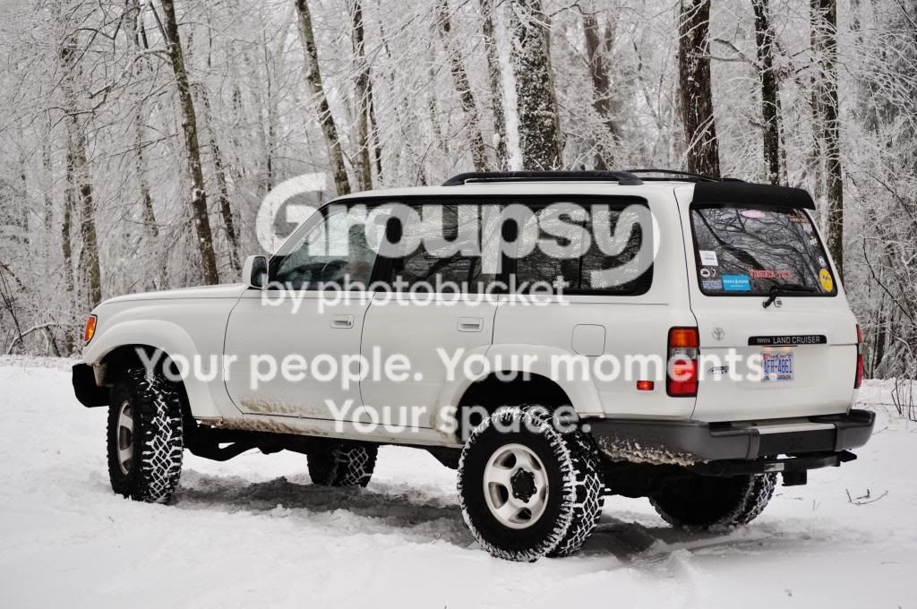

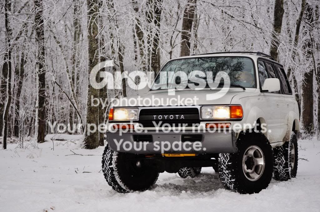

1994 Toyota Land Cruiser,
Front Axle is rebuilt, using OEM Toyota Felts and Seals/Gaskets.
New OEM Toyota Koyo Wheel Bearings
New TJM 50mm Progressive Coil Springs (Net ~3" of Lift)
New TJM Heavy Duty Shocks
New TJM 3* Rubber Caster Correction
NEW TJM Steering Stabilizer
New OEM Toyota Rubber Window Gaskets (x4)
New OEM Toyota Rear Heat switch
New OEM Toyota Center Differential Lock switch
New OEM Toyota Denso Spark Plugs
New OEM Toyota Denso Plug Wires
New OEM Toyota Distributor Cap
New OEM Toyota Distributor Rotor
NEW OLD STOCK, OEM Toyota Carpet Set for the Land Cruiser. This is a BRAND NEW OEM Carpet, Not Aftermarket (not installed)
Japanese Domestic Market Land Cruiser Second Row Reclining Hinges. This Allows the Second Row of Seats to Fully Recline!!!! SUPER RARE. The Third Row also has a recline feature
CSF All-Metal Radiator
Pioneer MP3 CD Player w/ Aux port
Alpine Type S 6.5" Front Component Speakers
Alpine Type S 4" Rear Two Way Coaxial Speakers
285/75/16 Goodyear Duratracs
Bumpers have been Repainted (front has a few scuffs now though)
Running boards and Mud flaps removed

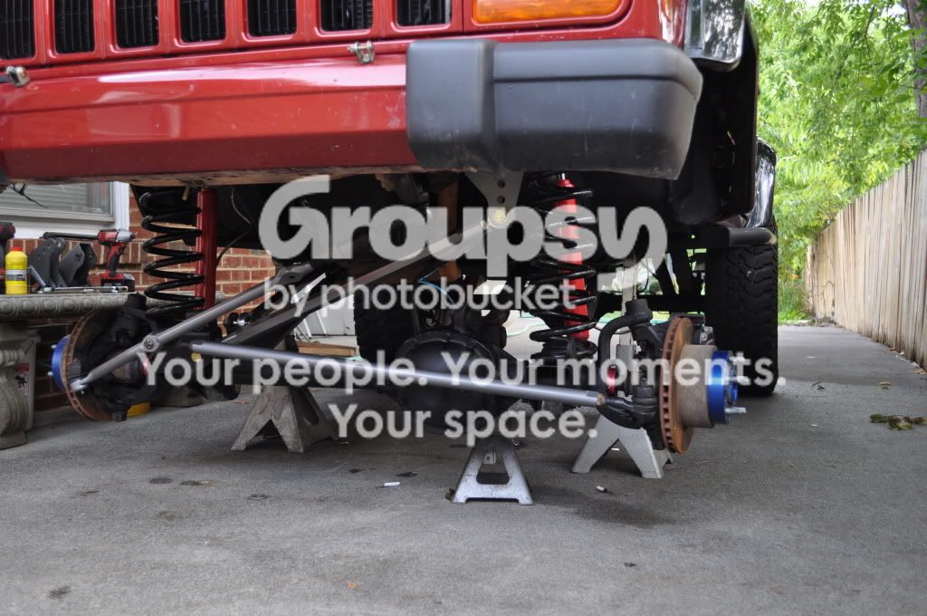

My 1998 Jeep Cherokee...
4 door
4.0 liter inline 6
Aw4 Automatic
np231
Dana High Pinion 30 Front
Chrysler 8.25 Rear
Chilli Pepper Red (2010 factory respray)
258,000 Miles and going
Rustys 6.5" coil springs
Rusty's 4.5" leaf springs
Rusty's 1.5" Greasable Shackles
Rusty's shocks
Rustys Cut Out Fender Flares
Froehlich Suspension Solid Hex 3 Link Long Arm Front Links
Froehlich Suspension Crossmember
Froehlich Suspension Solid Hex Track Bar
HD Offroad Frame Stiffeners
HD Offroad Shackle Relocation Brackets
RuffStuff 1.25" Heims on Lower Front Links Frame Side
RuffStuff 7/8" Heims on Upper Link and Track Bar
Ballistic Fabrication 2.63" Poly Bushings Lower Front Links Axle Side
Nitro Chromoly 30 Spline Front Axles
Nitro 4.88 Gears Front and Rear
ARB Air Locker (Super 30)
ARB On Board Air Compressor
Trac-Lock Rear LSD
RCV Standard Dana 30 Axle Tube Seals
Advanced Adapters Slip Yoke Eliminator
OEM Jeep Double Cardon Rear Driveshaft
JKS Quick Disconnects
Iron Rock Offroad Bar Pin Eliminators Front and Rear
Iron Rock Offroad Heavy Duty Tie Rod
Iron Rock Offroad Stainless Steel Brake Lines
16x8 Jeep Rubicon MOAB Wheels, painted (and baked) gloss black
Spidertrax Offroad 1.5" Wheel Spacers Front & Rear
305/75/16 Firestone Destination M/T's (33x12.50)
New front calipers
New Front Rotors
New front pads
New Master Cylinder
New Rear Shoes
New Rear Brake Hardware
Repainted in 2010
