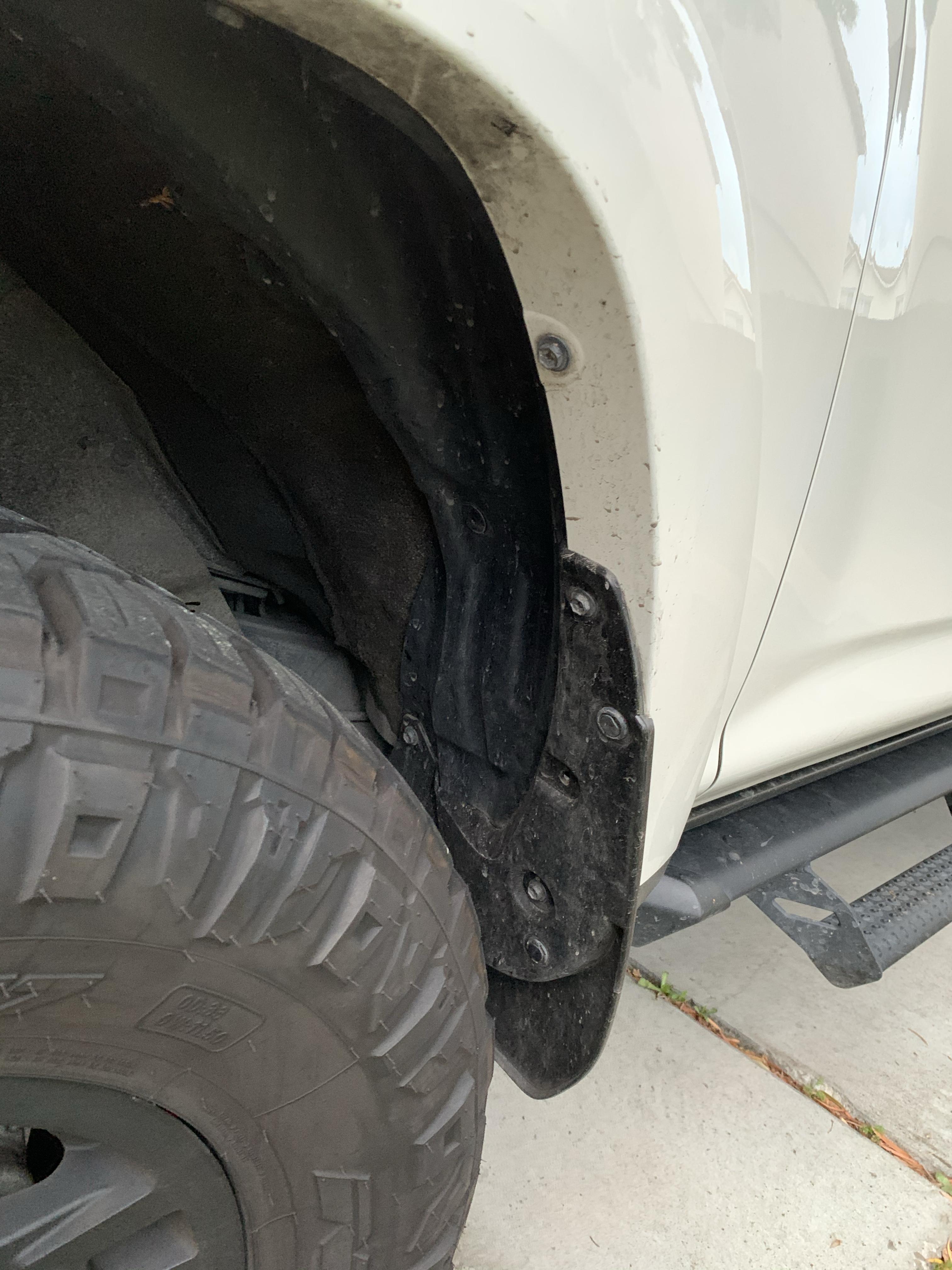

Thanks Daytonaviolet, are these oem guards? any problems?
I have Oem flaps on all 4 corners. I’m running 285’s on the ‘18 TRD pro suspension and Cornfed spacers 2.5/1.5. I had some rubbing on the bumper liner but nothing on the flaps. The fender liner mod fixed the rubbing. My caster is at 4 degrees.
