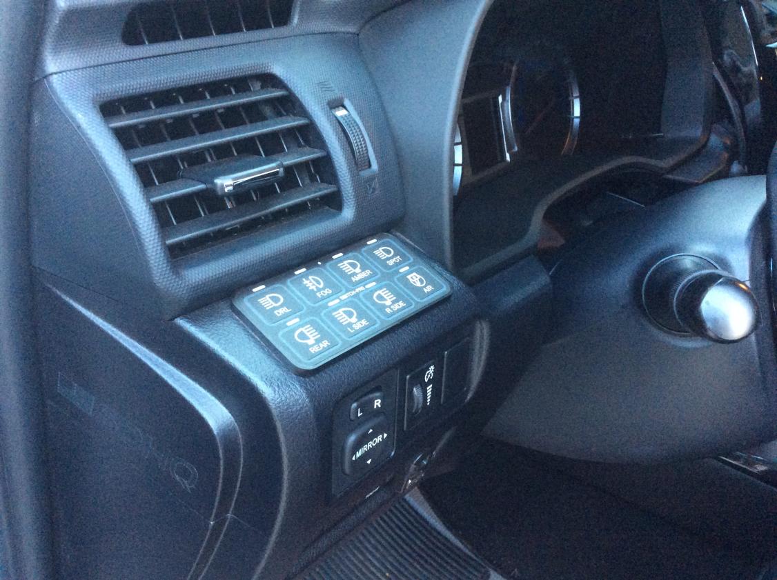

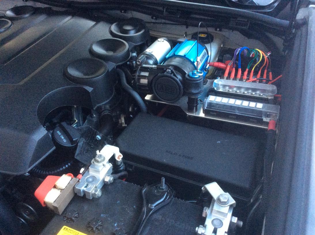

I really love my Switch Pros. It was super easy adding my lights and compressor. App controls remotely even 12 hours after turning the car off, great for camping. Change button colors, names on apps, load rating, etc. Location of the switch is perfect with the SDHQ panel. Here are a couple pics.

This is a really clean setup. Thank you for sharing it.
