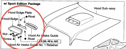

So I am looking at possibly getting a Sports Edition Hood, but it doesnt come with the hood scoop parts. I cant seem to find the part numbers so I can buy the part. I attached the image of the hood and circled the parts I am looking for the part numbers for.

I think it was only the Sport Edition that had the scoop in 03. At least my 03 Sport Edition has it.........
I will look on mine when I get home in the am and see if there are any #'s on it that may help you.
From http://www.toyota-4runner.org/4th-gen-t4rs/64647-sport-hood-conversion-s-answered.html
Scoop parts: Car Dealer Websites | Mobile Automotive Websites | SEO | SEM | Social Media | Video Marketing
-scoop (prepainted) $92.14 PN 7619235020
-scoop guide $13.43 PN 7618235060
-scoop plate $14.43 PN 7618135050D1
-3 rivets $1.50 PN 9026904054
Hardware store
-5 nuts and washers to thread on the scoop. already forgot the size and pitch. just take it into the store and get them.
edit - good luck with your purchase! I've been wanting one for a while, the hod itself is available on eBay for only $190, it's the painting I'm worried about. I was quoted $500+ from a few places.
