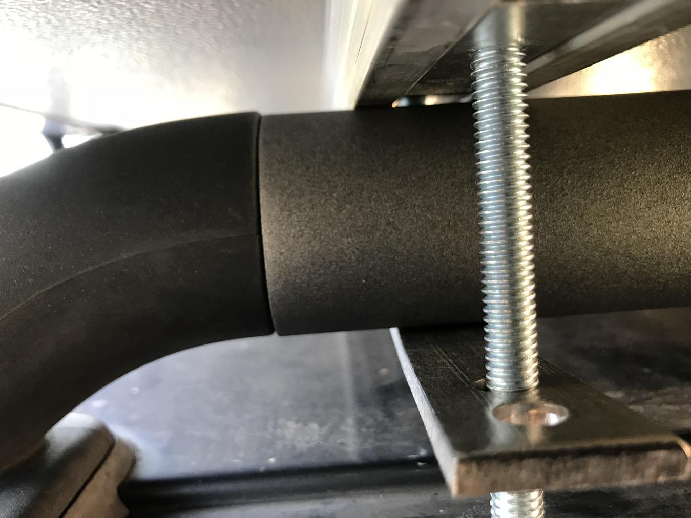

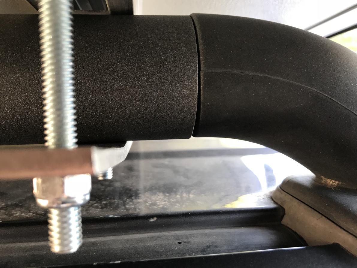

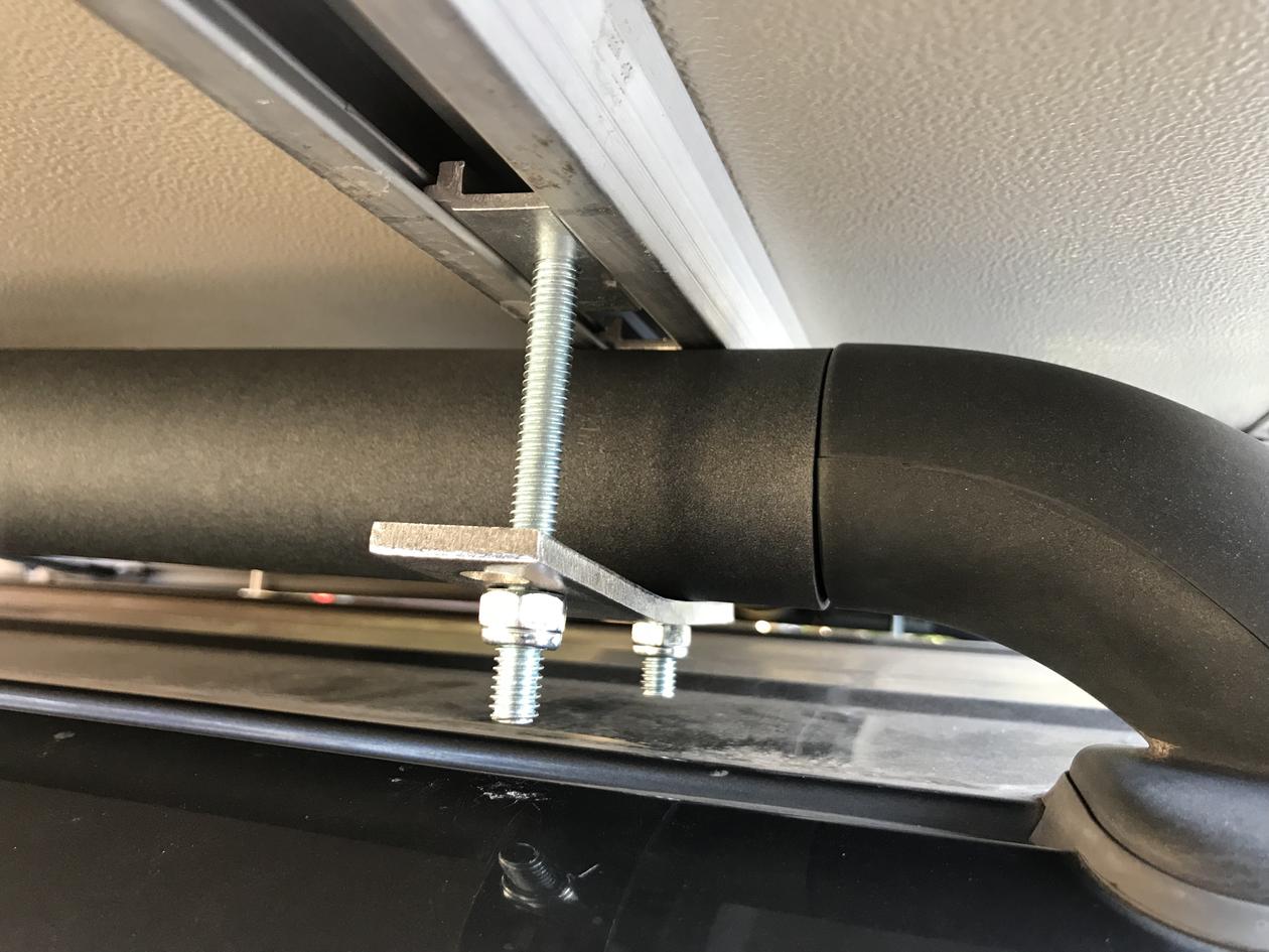

Rented a RTT to test out. Had to mount it opening over the rear, as that’s how the rails on the RTT were already oriented. Noticed after I got home my driver side rail looks slightly “crooked” compared to the passenger side. Not sure if it already looked like this, or if the rail didn’t like the load so close to the roof mounting bolts. Any thoughts? First two pics are driver side, 3rd is passenger.

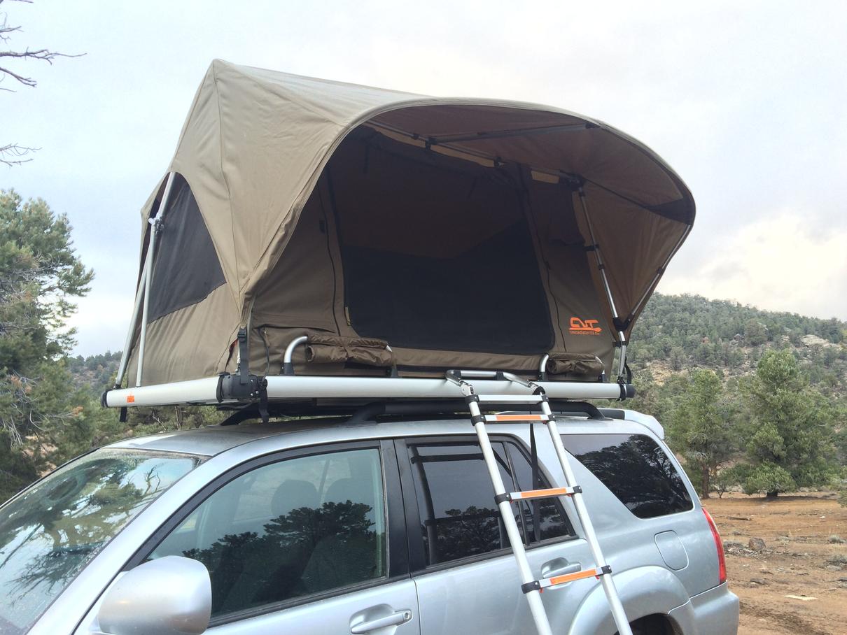

have had my tent mounted to my stock side rails for a few months and countless nights in them. Even survived in 70+ MPH winds in the desert. Zero bowing and im not necessarily light.
Had my CVT Mt Thielsen up there for weeks before getting a Prinsu. No issues at all.
