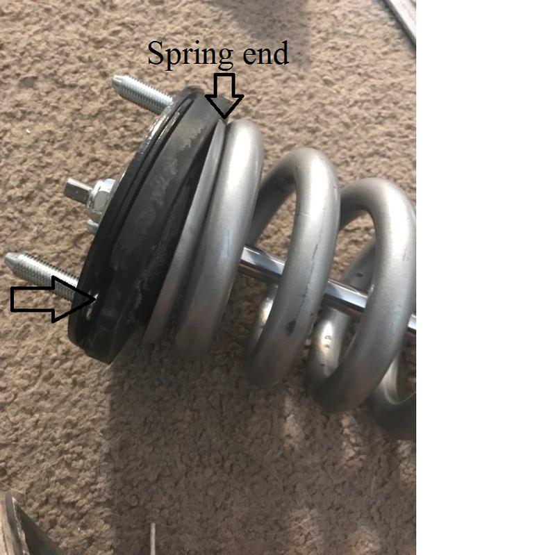

hey there this is my first time doing any of this stuff but im installing the springs on my new struts and it looks a little wonky the strut mount has a little insulator that wont seat straight. heres what im talking about is it supposed to be this way? or did i mess something up
I see the indentation is on the wrong side. Flip that to match the end of spring.

Though i may retract what i said previously.
If i remember right i read some where years ago when doing my lift that the coil seat isolator that rubber thing " correct me if im wrong" there are different sizes.
If you are using the original toyota rubber isolator it is to wide for the toytec coils, because they are a smaller diameter than the original toyota coils you are replacing. So you need the correct diameter rubber isolator. If you contact toytec they should be able to help you out with that problem.
Do not install or drive the vehicle till thats resolved.
