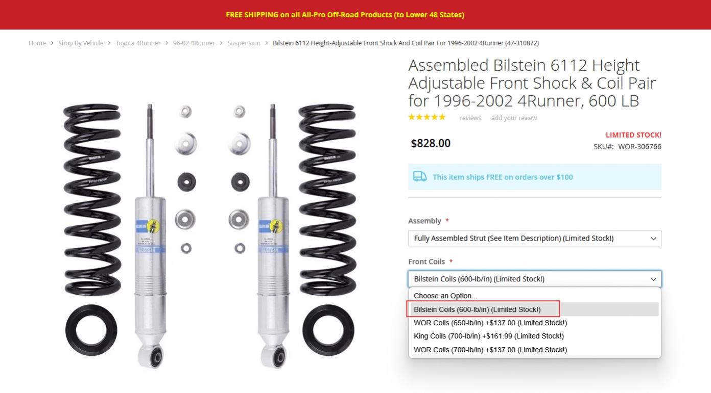

Is the bilstein 600lb coils enough for my setup?
Steel front bumper / skid plate. No winch.
Personally, I'd start with the stock springs (meaning 600lbs). You can always swap to stiffer springs later - keep in mind that the 6112's are not able to be re-valved - and they are valved for 600lb springs.
