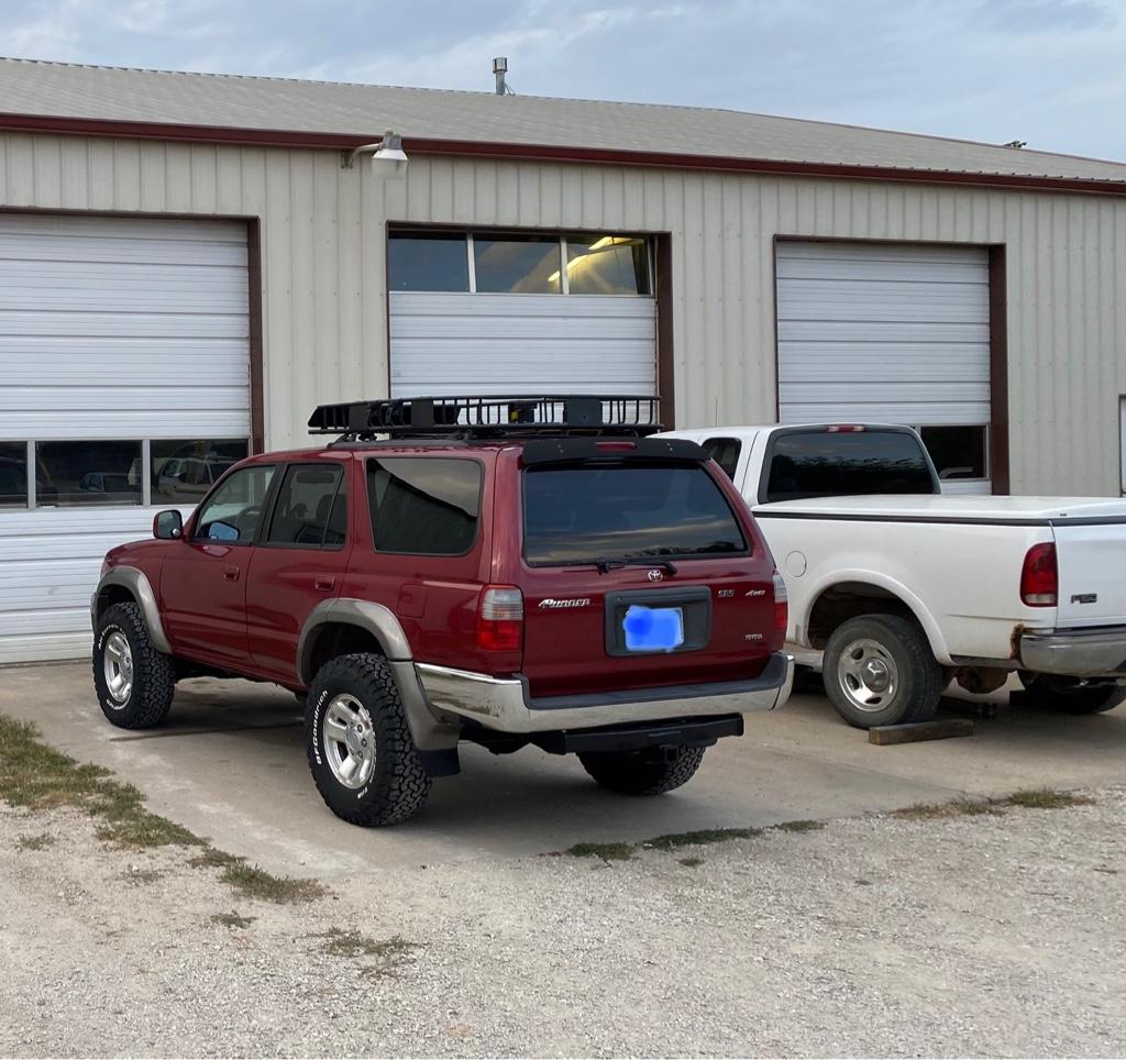

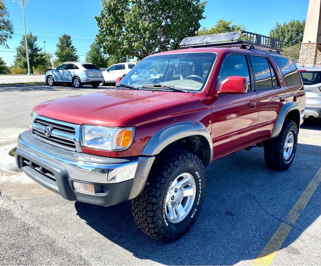

You wanted to see 906s: here’s my 2000 with Bilstein 5100s, OME 880 / 906 (often listed as 2880 and 2906 when sold as pairs, the 906s are side-specific to mitigate driver side lean), and 265/75/16 tires. I also replaced nearly all my bushings with poly and have [MENTION=28464]eimkeith[/MENTION] ‘s Panhard correction kit.
Not sure if it’s my oversized fender flares or my color combo or factory wheels, but visually the 2” lift really doesn’t seem too high. It looks pretty balanced to my eye. Rides nice. Fine for daily.
Of course, if you’re replacing original shocks, springs, and bushings, then virtually anything you decide on will be an improvement.

Thank you for posting these, this looks great and I could totally see doing this. I wouldn't want it any higher but I like the way it sits/looks. Did you have to do a diff drop for the CV angle or anything fancy? I see the panhard kit you mentioned I will definitely be purchasing that for sure.
With 880 not being side specific, how much of a ride height difference do you have in your front driver & front passenger sides?
