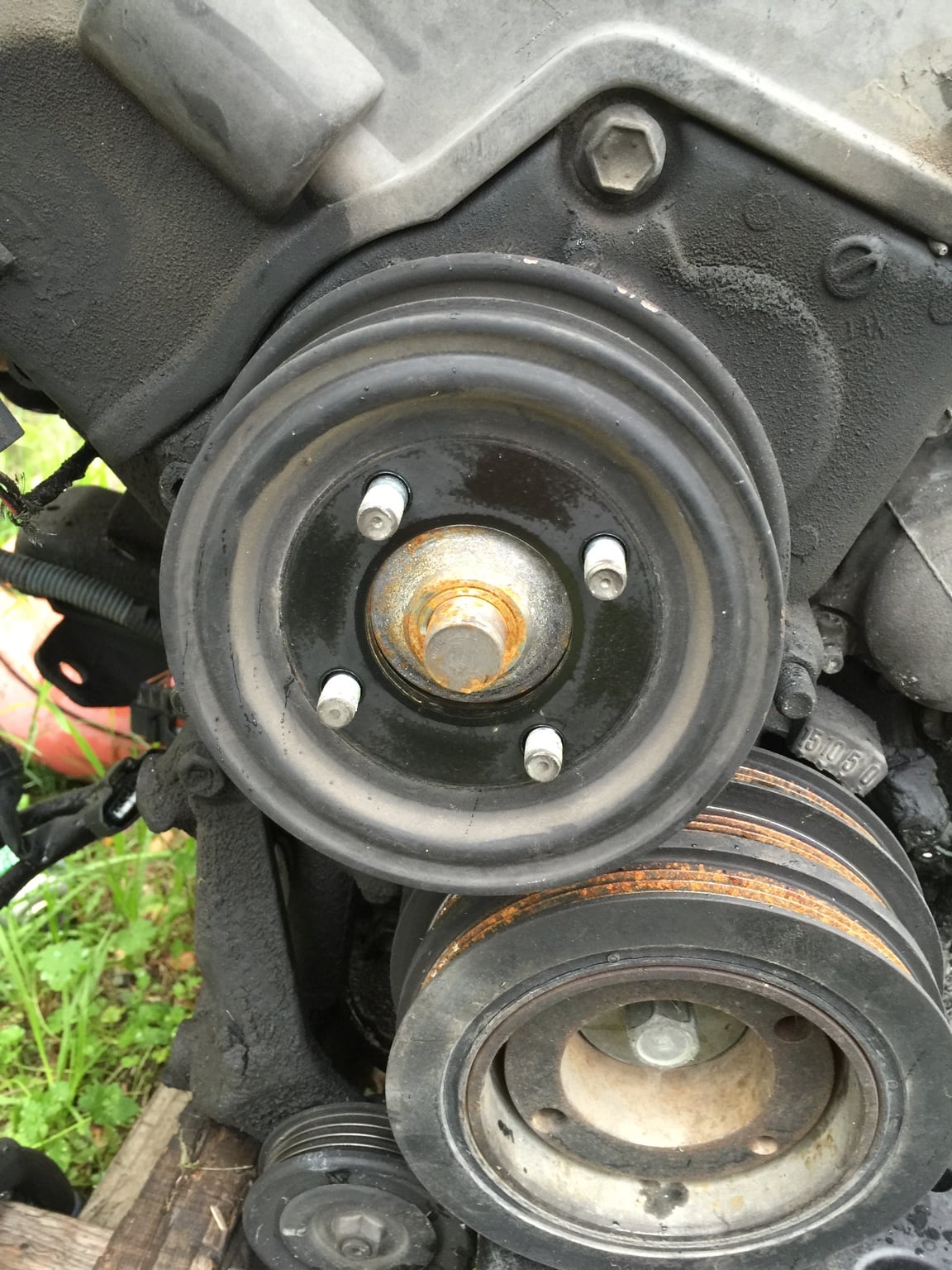

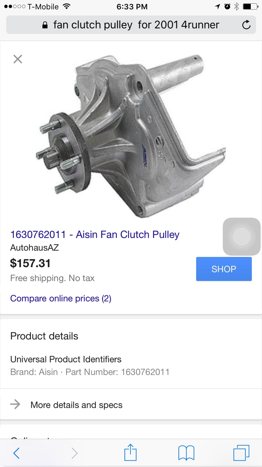

Let me correct my self, it's the pulley that the fan clutch,PS and Alt belt mount on. It's held by three 14mm bolts and you have to remove PS pump to get it off.
You have to remove all belts and fan & fan clutch
But that's your problem for sure.
Easy way to check is remove everything except your PS pump. and turn the pulley by hand and you'll hear the grinding.

Nope!! It has to be replaced. Yours sound it's ready to go, you need to trouble shoot it. Had it happen a couple of times. I have a couple of extras. Let me know if you get to it and turn it with your hand and you'll hear the grinding. Not suppose to hear anything.

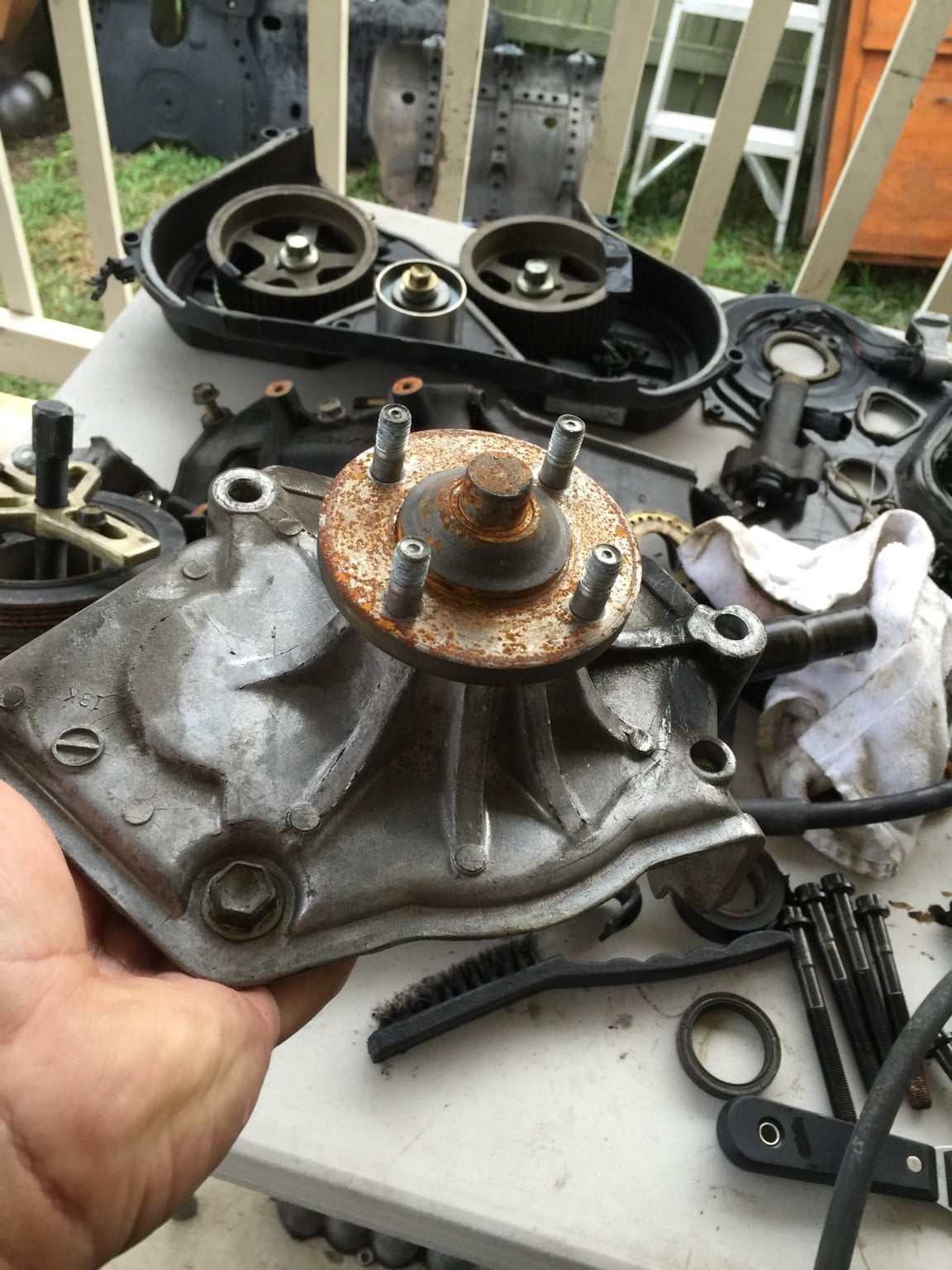

I had a very similar sound and it turned to be my water pump. It had been replaced with a very cheap aftermarket pump. It started with a very small coolant leak, so small it never dripped on the ground. I would notice when I did my oil changes that the coolant would be down about a 1" in the overflow. I never could isolate the sound even with my stethoscope. I finally dove in once the leak increased and the sound got worse, I could hear a low grinding when I was in the drivers seat.

This could be the issue. If not you might as well dive into the water pump. It's easy to check but you need to have the PS,FAN CLUTCH and ALT BELT OFF. since this are the two belts the pull tension front this pulley.
If you want the removal steps let me know I can give them to you.

That's a good point. It has been losing a little bit of coolant between oil changes but I've never seen a drop underneath the truck.
