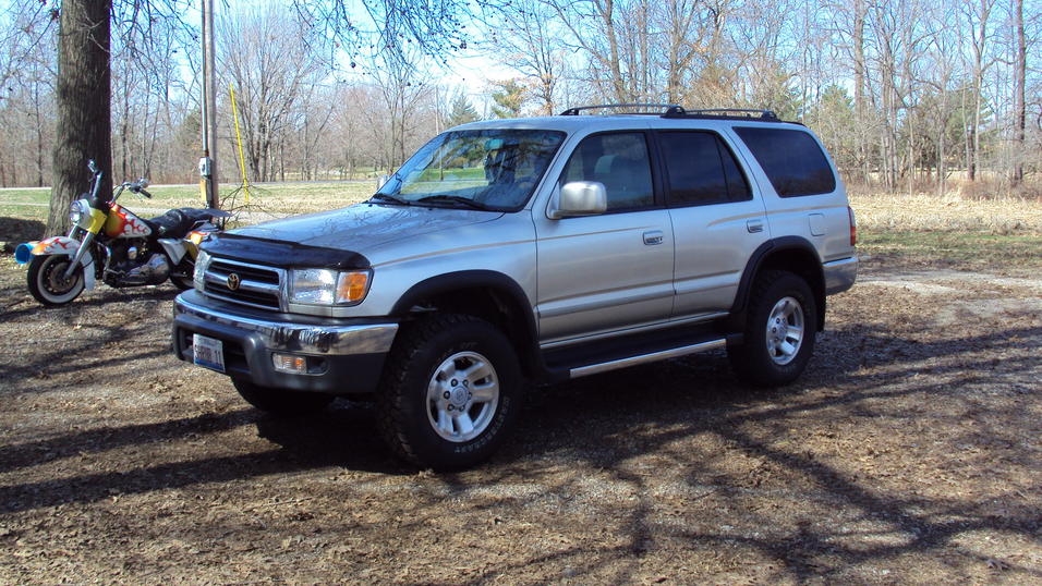

Yes it is most definetly a 4x4. I would never buy a SUV if it was't. I just posted pics a few minutes ago. I got her cleaned up just for the photo shoot.
Here it is!

I know I am a lucky gal. I fell in love with her right after I popped the clutch and took off down the road. She ****s and gets and that was what I was looking for!
