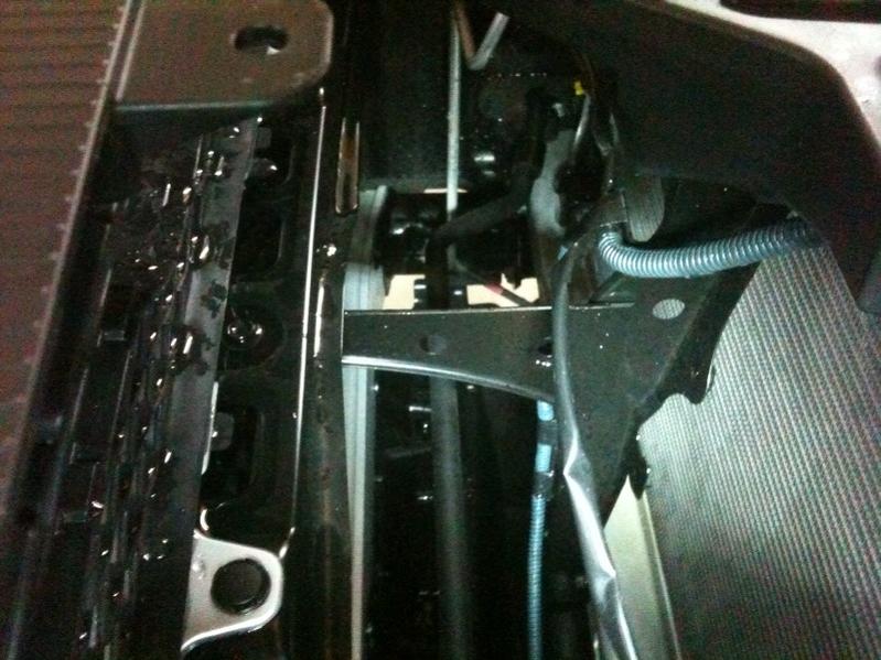

I installed mine last night... I put the two horns side by side on a piece of metal right under the hood latch. I will try and put a picture up later because I am going to redo the wiring harness that I made in a hurry last night. Let me know if you have any issues and I can give you a more detailed walk through.:hatsoff:

Im away on business so im not with my car for pictures but there are some on the forum in the other Fiamm thread
Here is the process the best i can recall
1) Removecowling by pressing down on the rivets while lifting the cowling (I pushed down the center of the "buttons" with a flat head and pulled up on the cowling)
2) Locate original horn and remove the wiring harness
3) remove the horn by taking out the bolt holding it in place
4) take the new horns and bolt on the brackets they gave you and make sure the horns are facing down at a 45 degree angle so water doesn't pool up in them
5) Making the wiring harness.You need a male and 2 female plugs (IE one that will fit into the factory horn wiring and two that will fit the Fiamm male connections), 3 pieces of wire about 4" long, electrical tape and a wire connector. Im not sure how familiar you are with wiring, but let me know if you need more details... First, take the three pieces of wire and strip both ends of each... Next attached attach the male plug to one end of the wire, a female to one end of wire 2, and a female to one end of wire three... attach the female end to the male ]connector on each one of the horns and the male to the 4runners original horn wiring. Keep the wire connector handy for later in the process
6) Locate the metal strip under neath the hood latch that was in the picture I posted. Find a nut,bolt, and washers that will fit through the horn brackets and the metal piece under the hood latch.
7) Take a rat file or some serious sand paper and sand down the piece of metal to give the horns a good ground connection
8)mount the horns side by side facing forward and down at a 45 degree angle (IE Horn then Metal under hood latch then other Horn)
9) Take your three pieces of wire with stripped ends and connect them using the wire connector
10) Turn on car and test horn
11) replace cowling and enjoy the new horns
