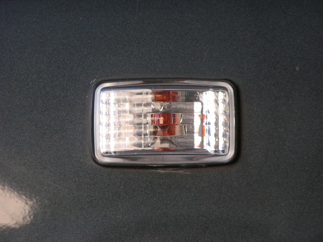

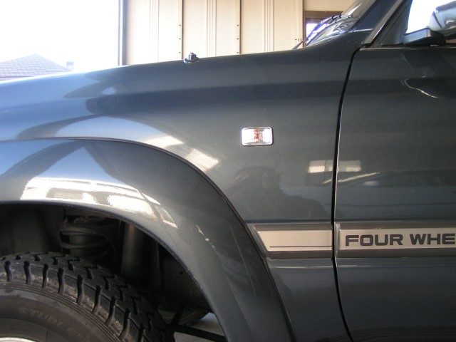

Thanks for the EWD link. I really like the SR5/Limited side mirrors and I know they will look pretty cool on TEs. So if the harnesses are different then I may have to go different route and more likely will copy the turn signal lights installed on fenders that you can see on JDM 80 Series Land Cruisers as seen on attached pics. I may have to cut a semi rectangular hole on the fender at a later date.

close up pic of the turn signal which will match the DRL/Blinker lenses.
