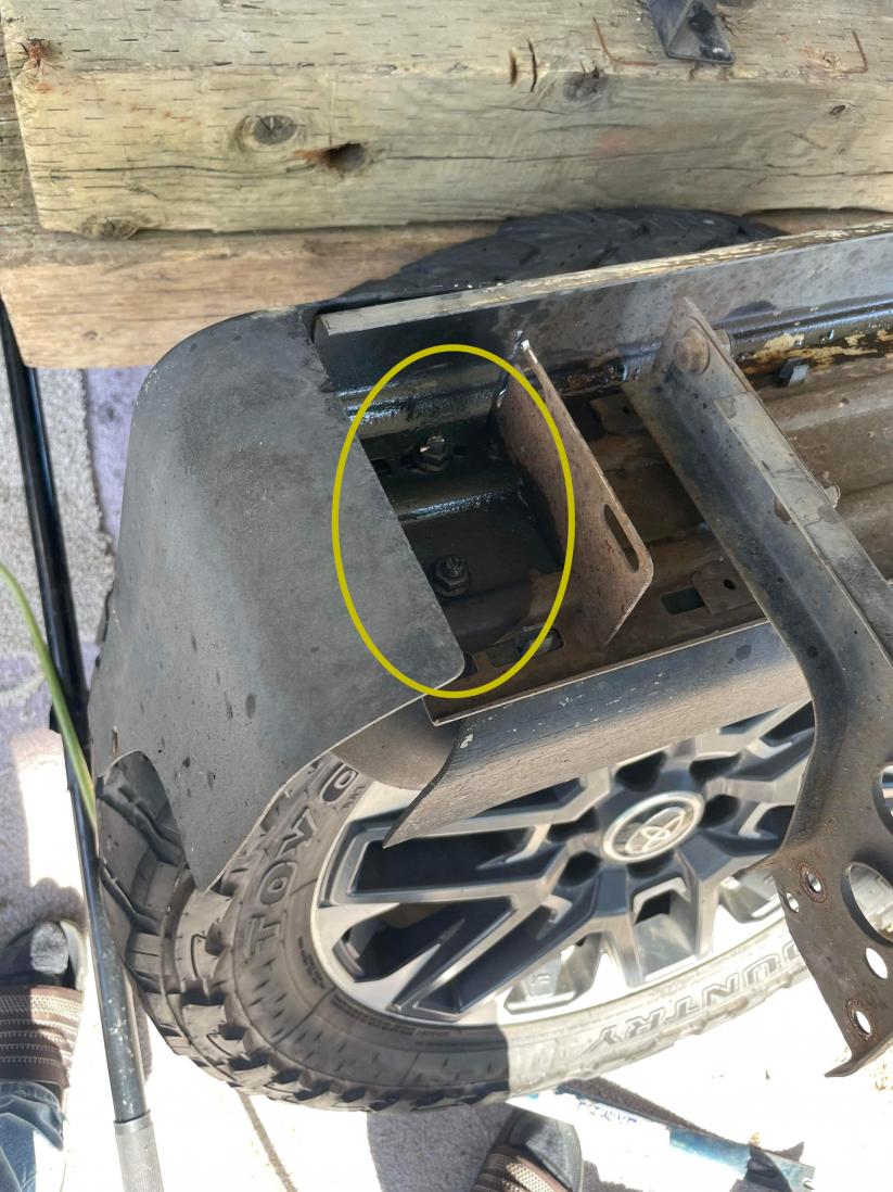

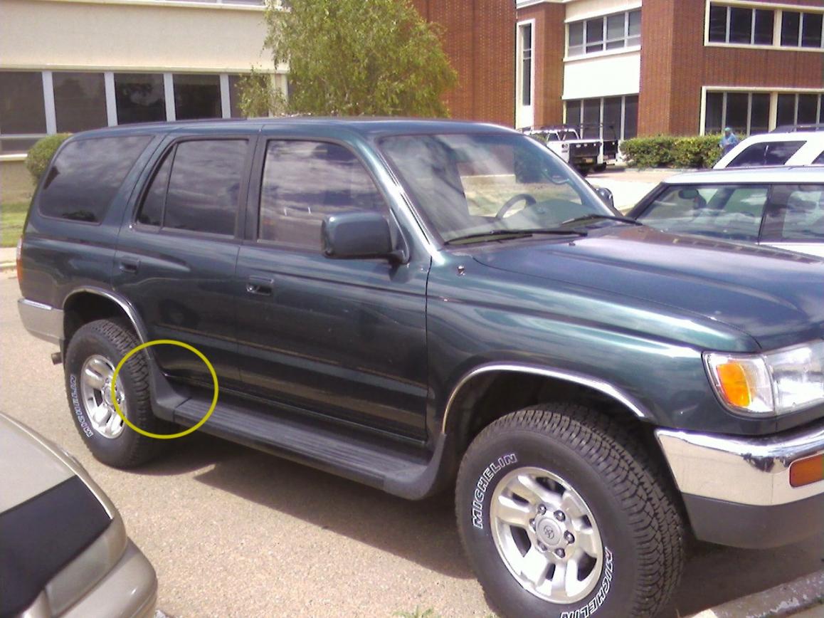

Trying to remove the running board covers on my 3rd gen SR5 but the nuts are seized and the bolt is just spinning on the spot. Any recommendations on how I can get just the cover off the running boards?

I think I’m gonna try to get at it with a flat metal chisel since I don’t have a grinder. The bolt is spinning in place so I don’t think heat and gun will do any good.
The "bolt" that holds on those end caps is molded into the plastic of the cap. If it is spinning in there, your only solution is to just rip the cap off at this point, sadly.
A nut breaker/cutter may also work if there is clearance.
