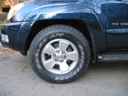

The tires added a dash of rugged to my rig. Ride great too :) 265 70 17

Thanks...fills the wheel well very nicely. Any rubbing yet during extreme steering or wheel compression??? This will be very useful for 4runner & GX470 owners because it is very hard to find stock sizes.
Thanks.
Not that I've noticed - I'll take a close look with the wheel maxed out sometime, but I think it is free and clear.
I imagine that in extreme off-trail conditions I might bump the wells once in a while, but not appreciably more often than I would've with the .5" smaller radius tires anyway.

I checked out the clearances at the steering extremes and there is still about an inch of clearance everywhere. No idea about compression rubbing but since the tire is really not radically bigger I'm not worried. Besides, I'm a fisherman not a recreational rockcrawler ;)

i like the look of the aggressive tires on the new models...are you sure there is no rubbing?
You will get rubbing if you use aftermarket wheels with less offset. Toyota 4Runner wheels are +30 so if you go less, the wheels stick out farther and you will get a bit of rubbing
