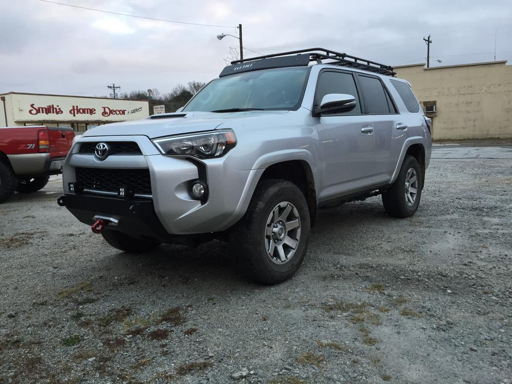

I went with TE because basically it has everything you'll ever possibly need. I have updated the front suspension to make it a little stiffer and to level it out and I did put on a Southern Slimline bumper and Warn winch with a Gobi rack, but have to say the only other thing I really plan on doing is when I need new tires get the BFGs KO2 and probably some sliders. Other than that, this thing is awesome and I LOVE it!! Interior is so much nicer and manual transfer case is nice as well..
