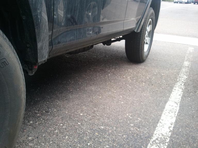

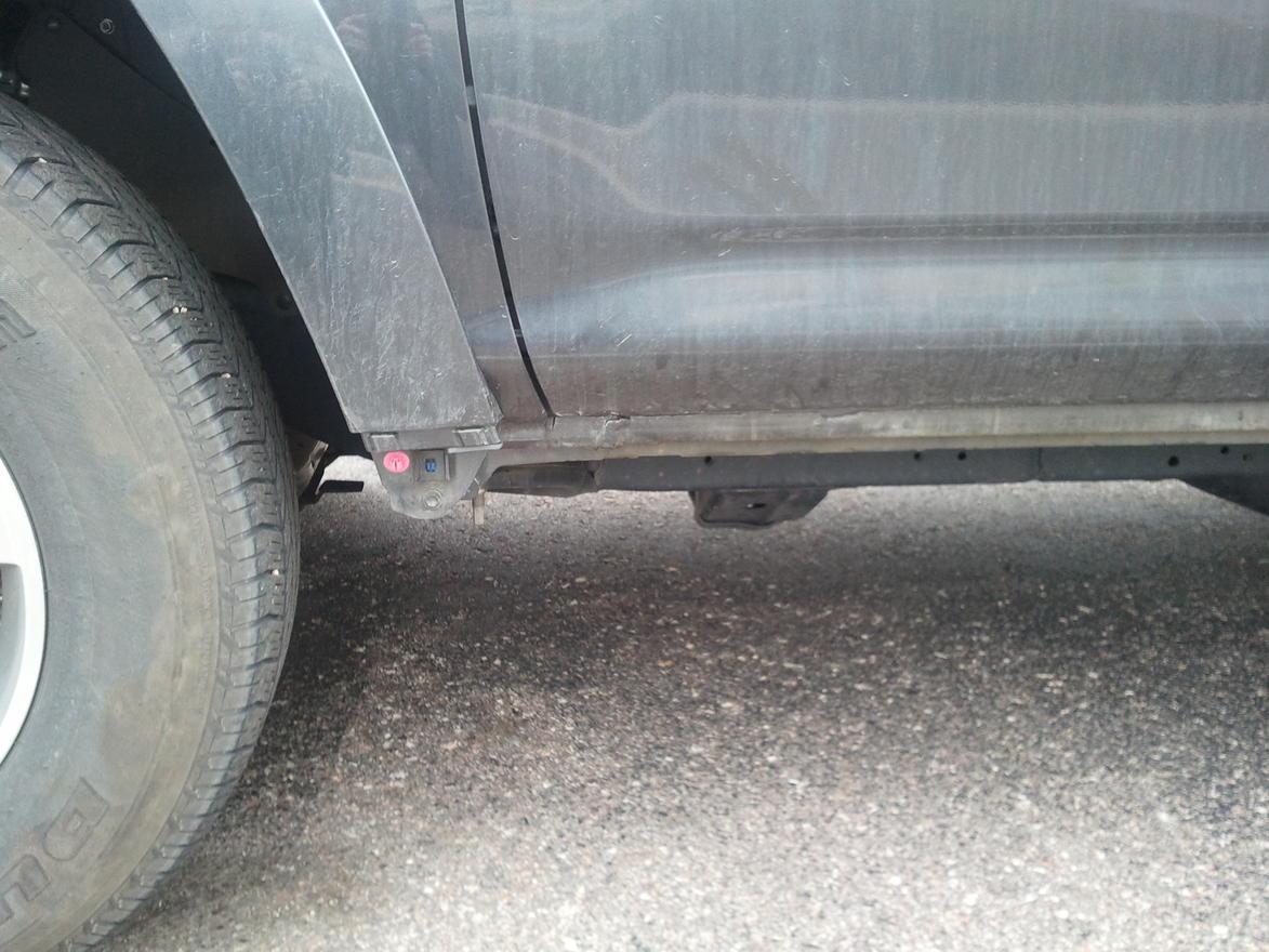

I just took mine off yesterday. I'd like to get the black mouldings that come on the TE, but I'm still searching for someone who will give me a quote without telling me it would cost less to trade in for a whole new vehicle. Oh, the lulz.

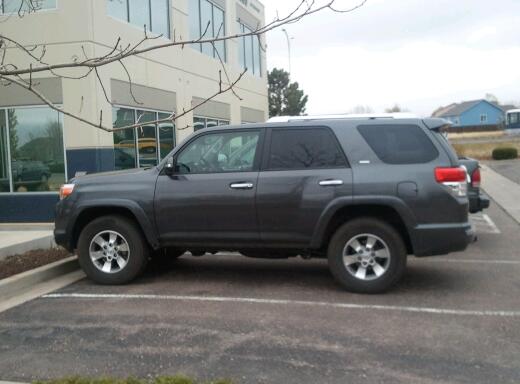

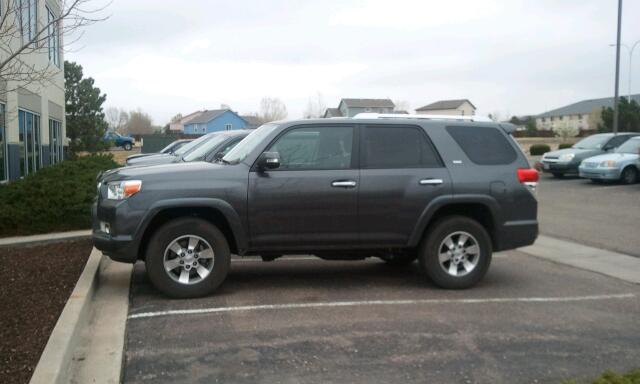

Here is a wider shot of my 4Runner for you, emsmatt. It's from a cell phone, so the quality is lax.
Thanks, here are a few more.
I thought that after a day or so of looking at it, that I wouldn't like it without the rocker panels and would want to put them back on. It turns out that it's not enough of an eyesore to even care. It's hardly even noticeable unless you're specifically looking for it. I like it without the panels now. I'll be picking up the black mouldings that you can get like the ones on the TE, but it's not crucial.

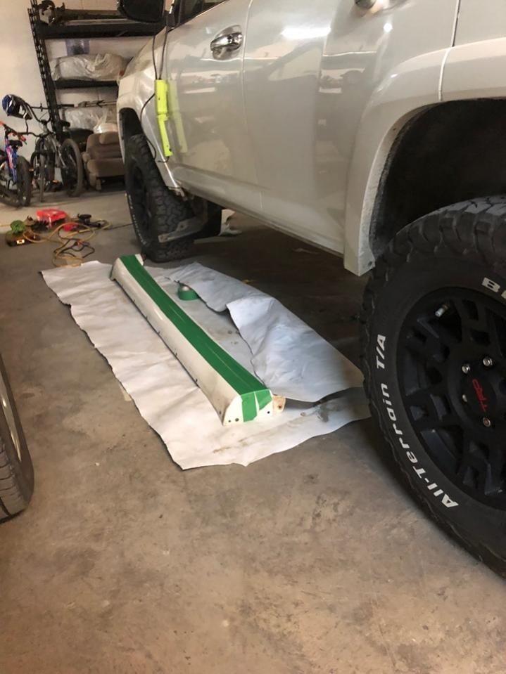

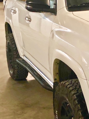

4 runner limited side skirt issue with rock sliders fix
So i have seen many post on the subject. i was at a loss until i found a solution online here. it is actually a very easy and in expensive fix.
i have a 2014 limited. i bought Greenlane off road rock sliders, which didnt come close to fitting because of the side skirts on the limited.
if you remove them its ugly, if you try and rpelace them with the TR version its craxy expensive.
so the easy fix is. just cut the limited skirts, it was a simple fix and looks great.
remove the skirts, empty the guts of them and the take a angle grinder and cut them. 1 inch below the chrome trim is what i did.
problem solved. have a lot
