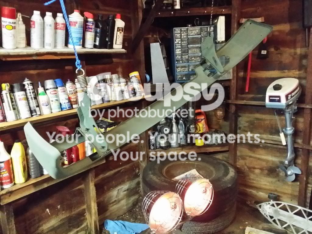

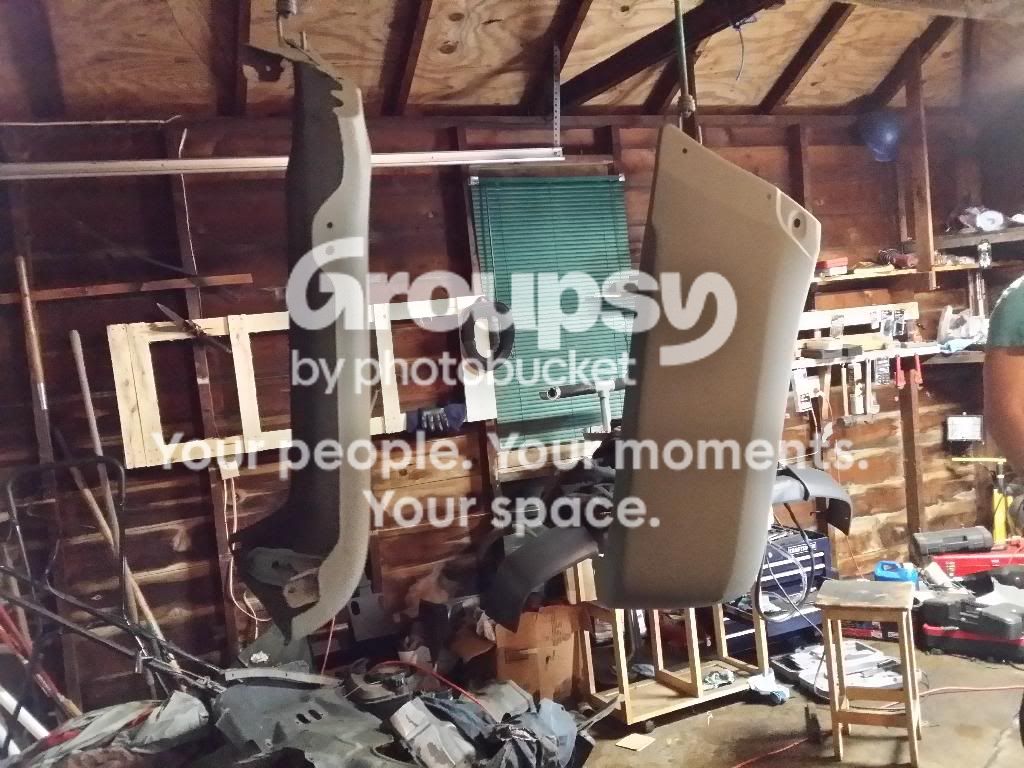

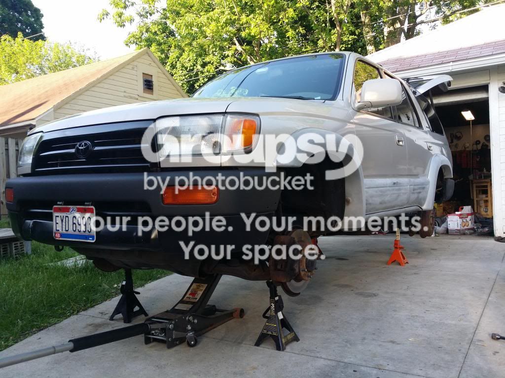

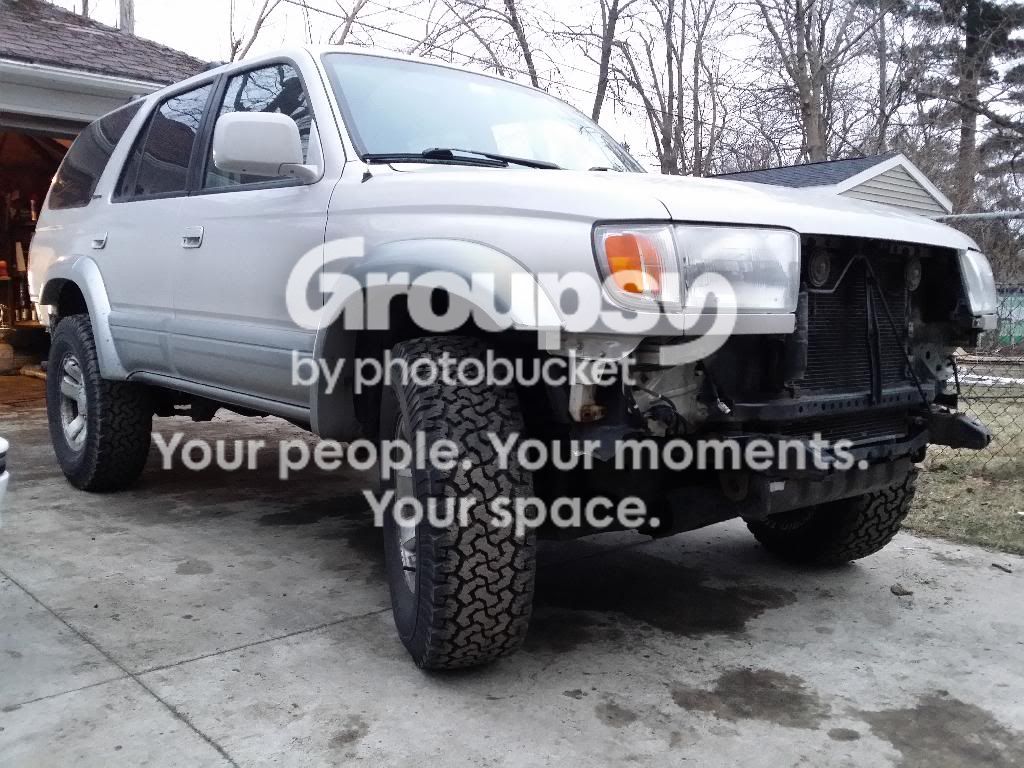

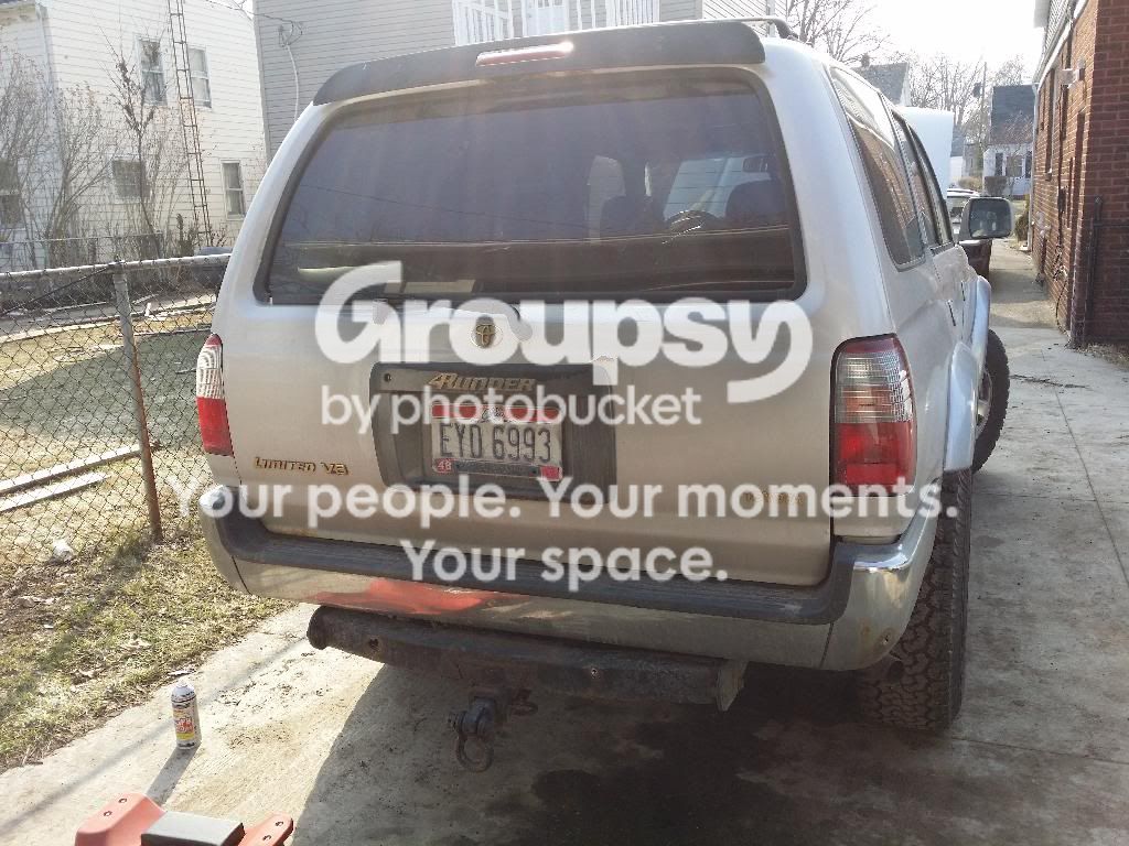

Front and Rear bumpers plus the grill are going in for paint.
Ugly trailer hitch.

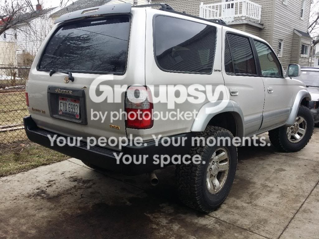

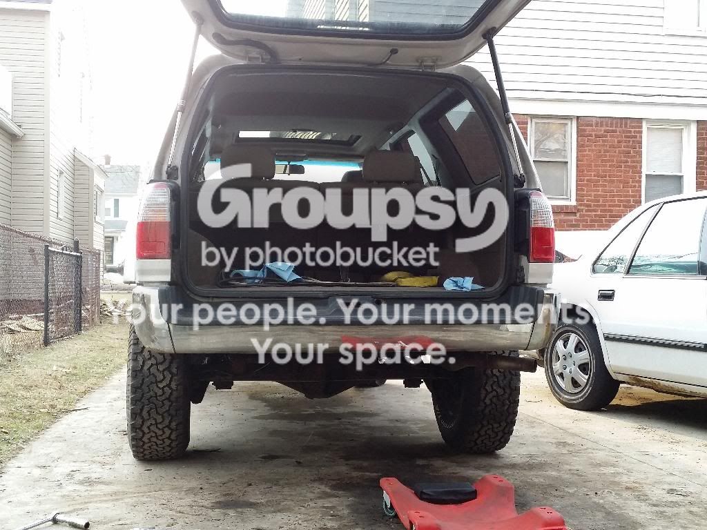

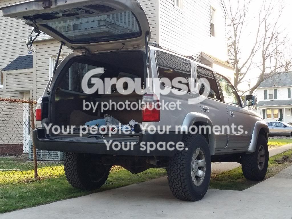

Bad spare tire and trailer hitch removed.
All of it gone. Looks a lot better this way. Ignore the rust.

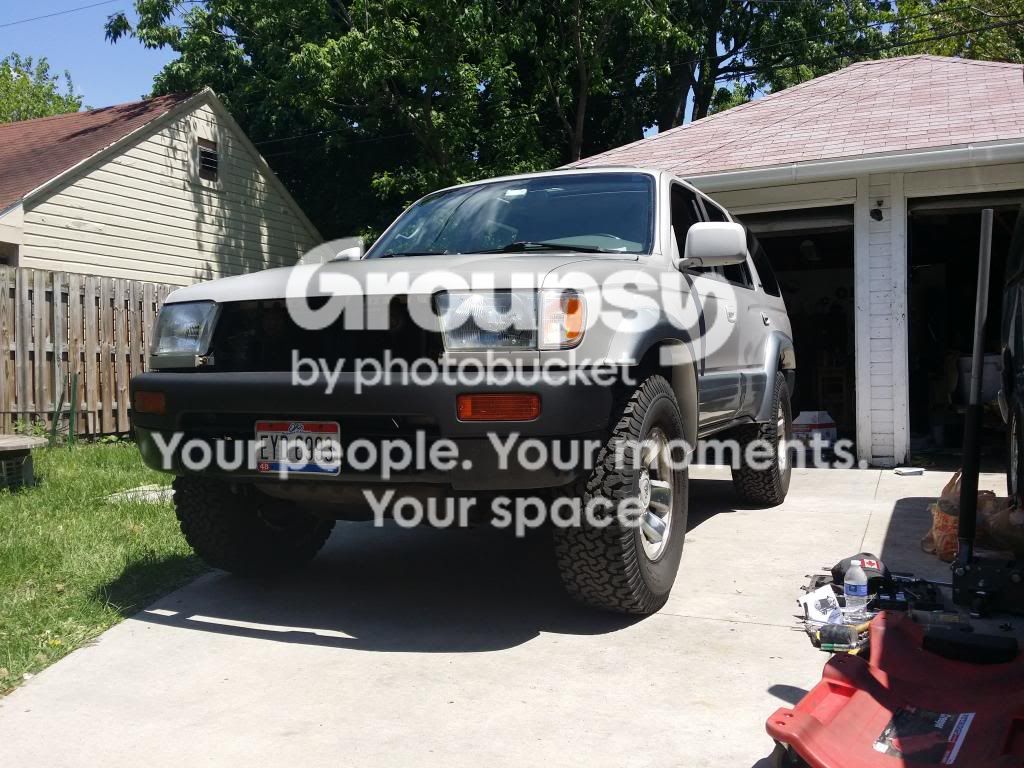

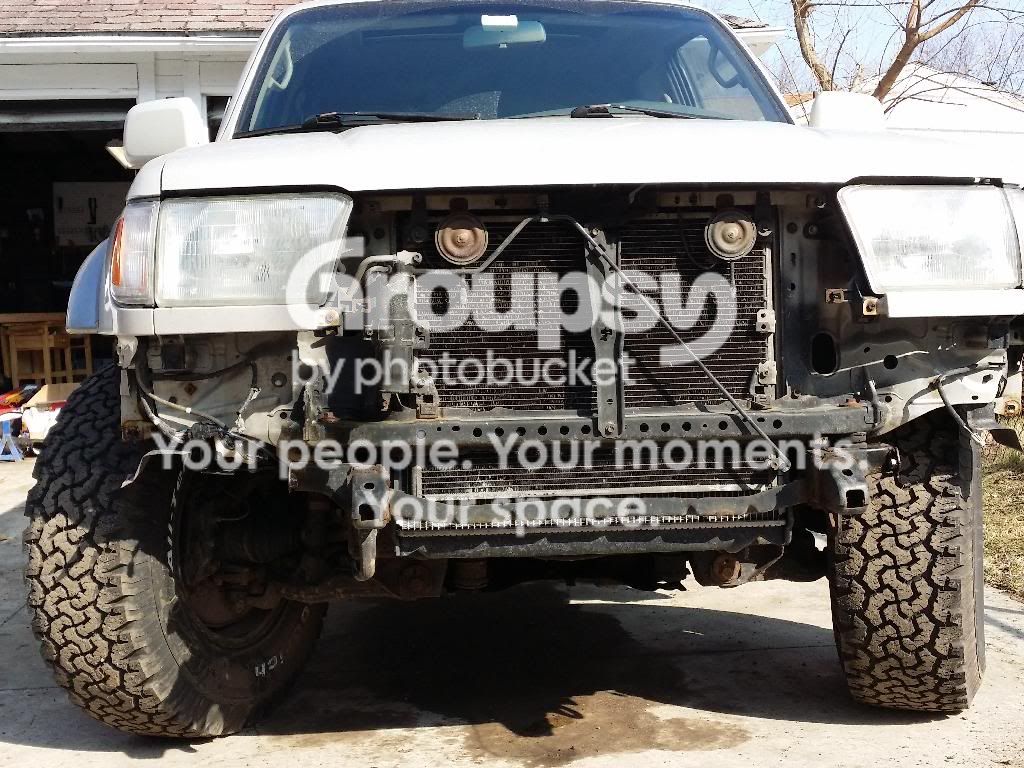

Front stuff removed.

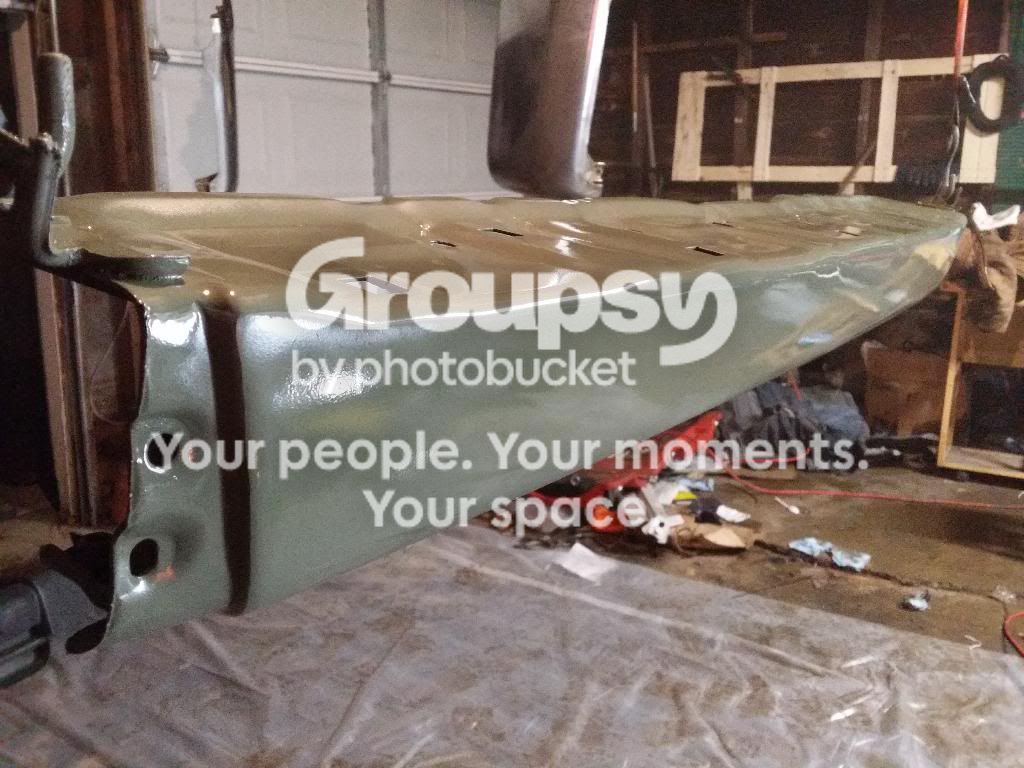

Primed and ready for some bed armor. I've had pretty good experiences with it so I'm going to try it again. Just finished up the painting a few hours ago. Everything's drying now.
Maybe I'll build a real bumper someday. This one feels flimsy as all get out. Can't imagine it would do much protecting in a wreck.

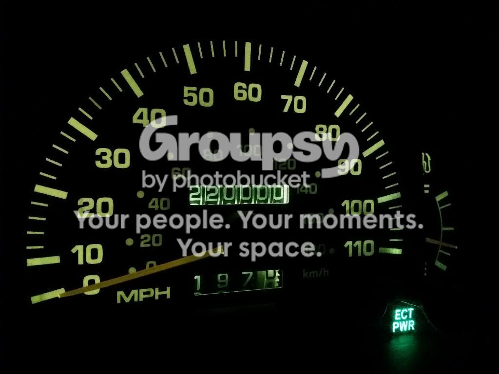

Rolled over 220,000 miles this last week. I've only done one oil change since I picked it up last September. I used to do the oil every 3000 miles or before on my previous vehicles but I've since stopped that and go around 5,000 miles between changes on this one. I use whatever full synthetic oil is on sale at Autozone, and always grab the Mobil 1 Extended Performance oil filter.

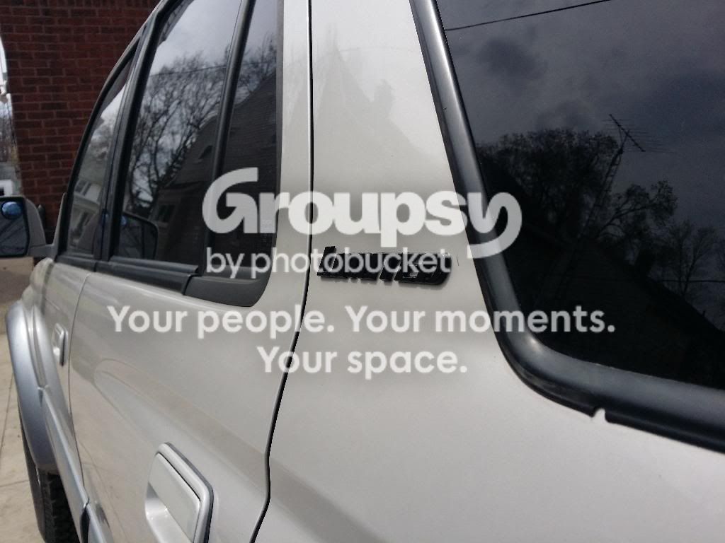

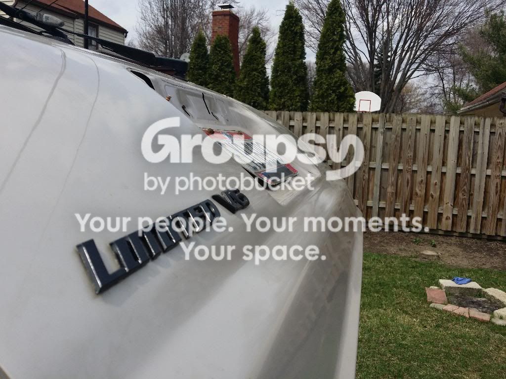

I also had no idea how ugly the gold lettering was until it was gone.

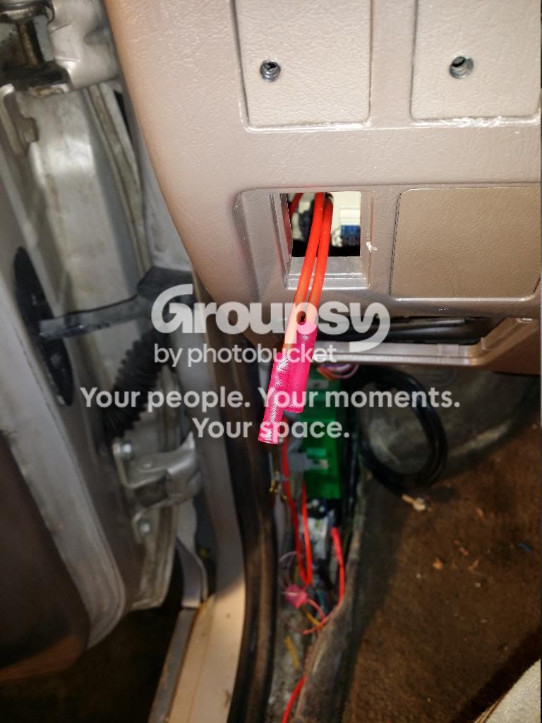

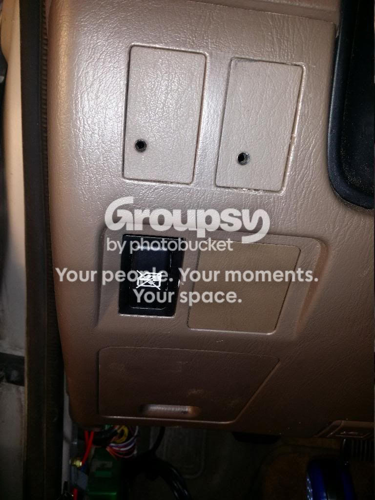

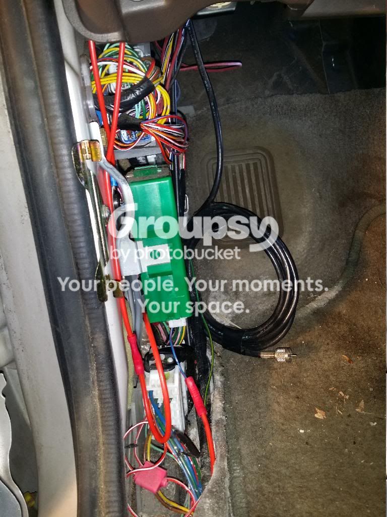

Did the blue wire mod today. It seems that the 97 and possibly other limited models can't use the same procedure as the sr5 models to bypass the 4low safety feature for the e-locker. Possibly due to the push button 4wd. The following is how I got mine to work.
- Remove plastic on the bottom left of the drivers side.
- Disconnect the plug from the 4wd module
- Cut the blue wire with the red stripe on it
- Tape the end that goes into the plug (don't want it touching anything)
- Strip the end that feeds into the wire bundle
- Attach a length of wire to it and run it to a switch (I used a window lock switch from a 02 celica)
- Add another length of wire and run it to the other side of the switch
- All finished
I first tried grounding the wire that comes out of the plug and it activates 4wd as soon as the key is put in the ignition. I also tried grounding the other end of the wire and it causes the funny shift pattern and lack of overdrive. The switch solved it.

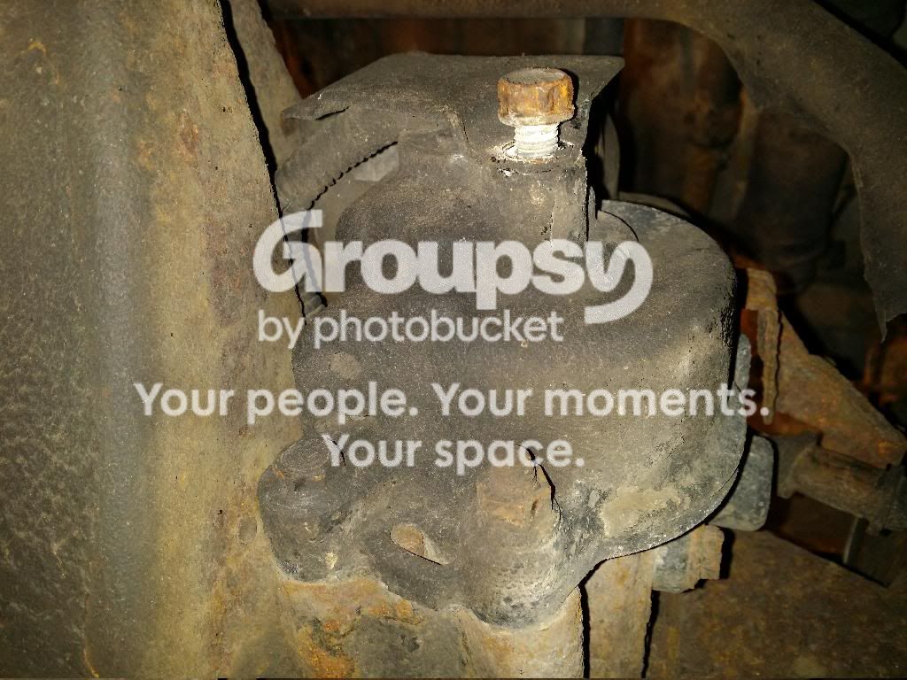

After I got that working I started in on the e-locker. It took me 5 hours to get the thing out at it still cracked the top part by the upper bolt. The motor works and moves the gear, the little lock mechanism inside the diff works as well. Somehow, they don't want to work together. I'll post a solution when I find one. :gun5:

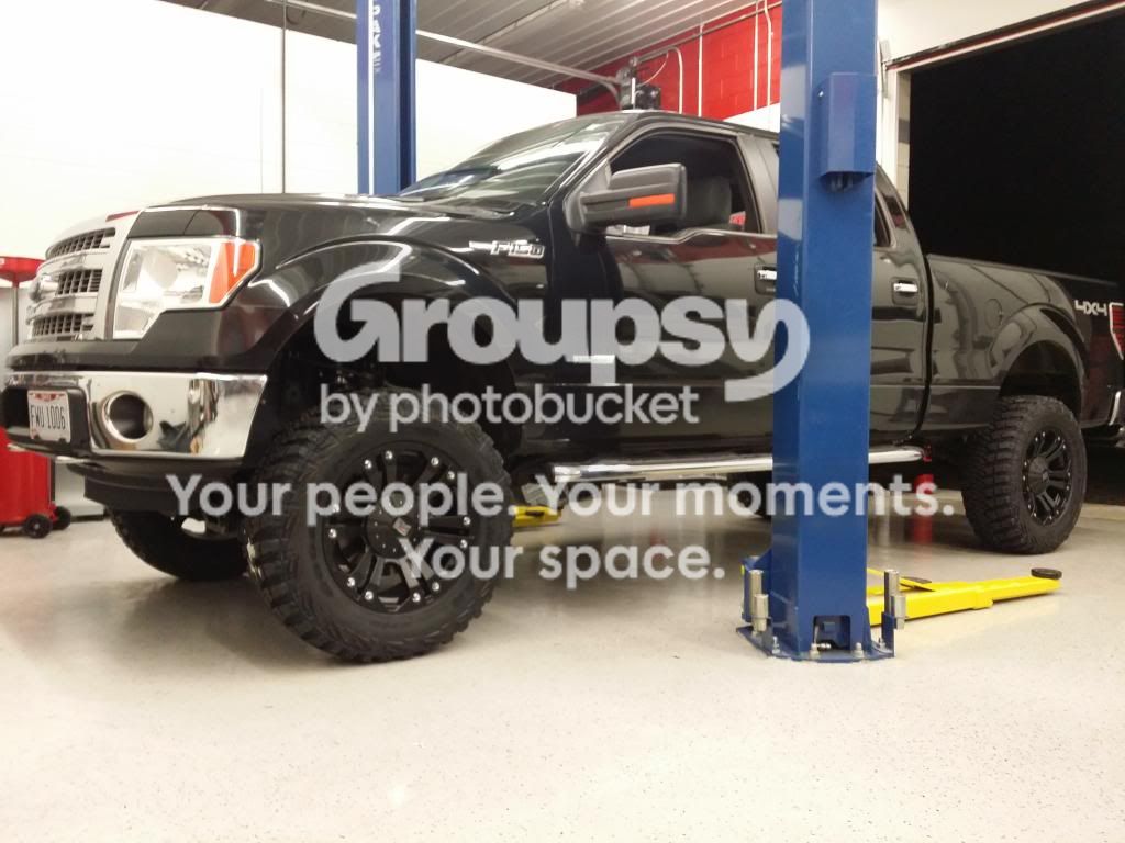

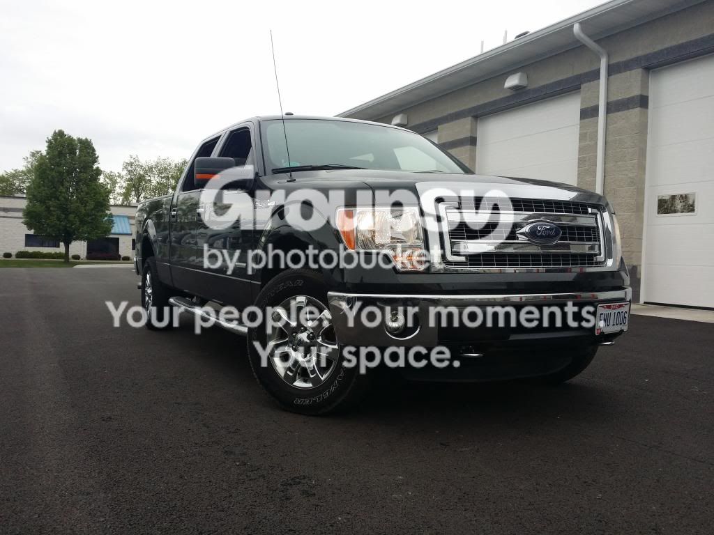

I hate Ford as much as the next guy, but that ecoboost motor in the F150's are really nice. I threw a 6" Rough Country lift on it today. Probably the worst instructions I've ever seen. Here are a few of the pictures.
2012 Ford F-150 4x4 Ecoboost.
Finished product

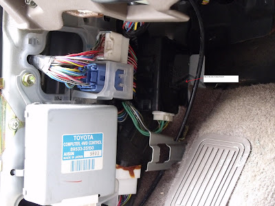

FYI, the reason your blue wire mod didn't work correctly is because you grounded the wire from the wrong 4wd box. You leave the green one alone and cut the wire from the black 4wd box farther back towards where your toes would be. Just wanted you to know.
Good to know, I may have to go back in a check that out. I looked around quite a bit and didn't find anything about the second 4wd box. I'm guessing it's exclusive to the push button models?
Also, just turned 222,000 miles last night on my way to Norwalk. I gave it a tank of Sunoco premium as a present. I think I'll try tearing the e-locker apart again today along with some paint on the flares and wheels. Need to check into the timing belt as well. PO said it was replaced a few months before he sold it but there are no stickers and he pointed to the drive belts when telling me. Pictures to come later today.
I'm not sure about it being exclusive to push button or not. I made the same mistake you did when first doing blue wire mod. My truck was stuck in 4wd. I looked over instructions again and realized I messed with the green box instead of the black one. Its kinda far up in the corner under that kickplate. The harness you unplugged runs right up to it IIRC. I would think our systems are identical considering we're both 97 limited 4x4 w locker. I'll try to take a pic for you.
I couldn't get the forum to work with my phone, but here's a similar picture I found online. The white box w text and a red arrow is pointing at the box you should be messing with. It says TOYOTA. The green box is gray in this pic but regardless should be left alone.
Thanks man, I'll get on that once I get the e-locker functioning properly again. I think the alignment of the motor and the gear is off. I read something about hooking up a AA battery to it and moving it a few degrees but nothing concrete yet.

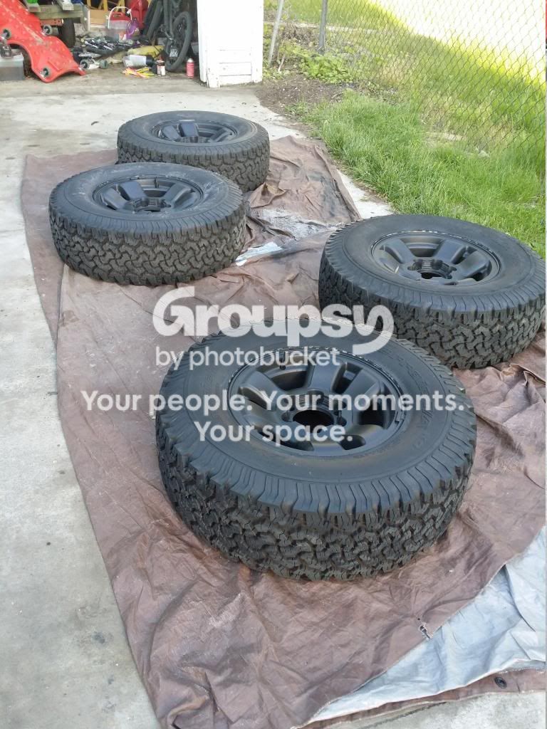

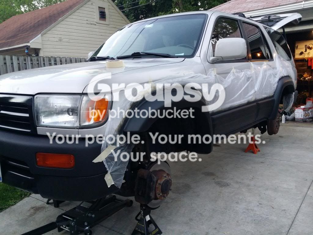

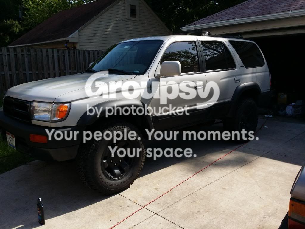

Started painting the wheels and the flares today. Ran out of light before I got the passenger side done. I'll post the photos of the finished product tomorrow.
Materials:
Rustoleum Flex stuff sold at the home depot, I've been impressed so far.
Soft sanding blocks
Masking tape
Painters plastic
Before:

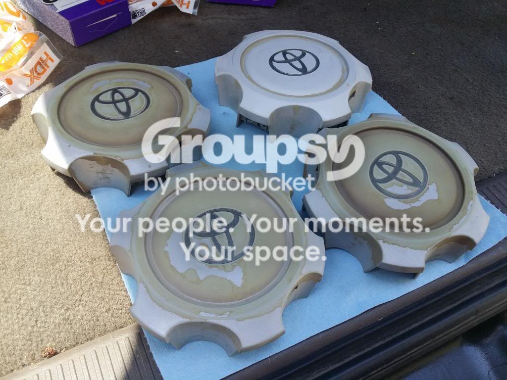

Sanding the center caps:
Final coats on the wheels:
Sanding the flares:
First few coats on the flares:
