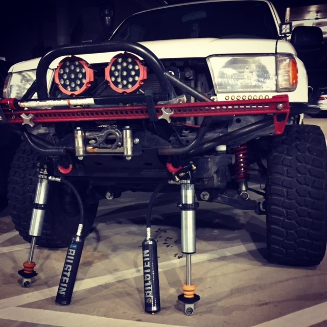

I have compared the valving of different shocks that I have looked at running. My conclusion for my ideal application is part 25-187724 (360/80 Valving)
Bilstein shocks and struts for cars and trucks - Shockwarehouse.com
These have a hair over 11" stroke and with the extended bumps/rear brake lines/Limiting straps... I've decided to run these with the OME 861.
I have also paired the front end with some new goods I just acquired....Bilstein 8125.jpg
