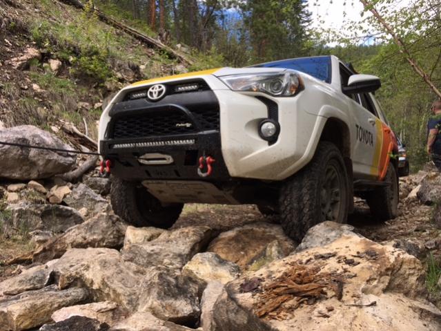

Ive seen both side by side. I compared welds, construction, thicknesses, looks and feel.
HANDS DOWN C4 IS BETTER IMO.
No real choice here. PLUS CALEB IS A GREAT OWNER! And, if your lucky like I was they will take ya wheelin!

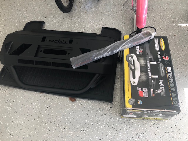

Try this again with a pic. Tomorrow is the day.

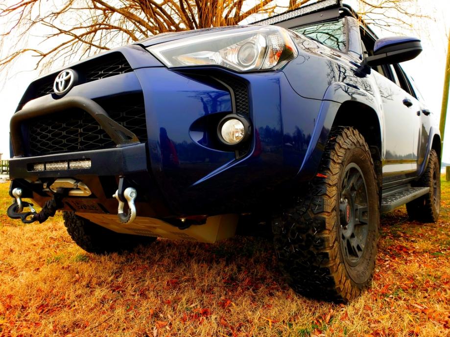

I went with C4 for a few reasons.
1. The shackle mounts are inline with where it bolts into the frame, and inline with the winch opening
2. The cross bar has gussets for reinforcement = more strength
I have a 12k Smittybuilt winch in mine. Haven't had 1 issue yet with the bumper.

I hope you got a little help.
I found keeping the whole front plastic piece off helped.
Also I cut a small portion of the down "L" bracket in front of the radiator and folded flat so it wouldn't hit the cross bars on the winch.
Relocated my control box to the side. (this also allows for better access to the power switch.)
