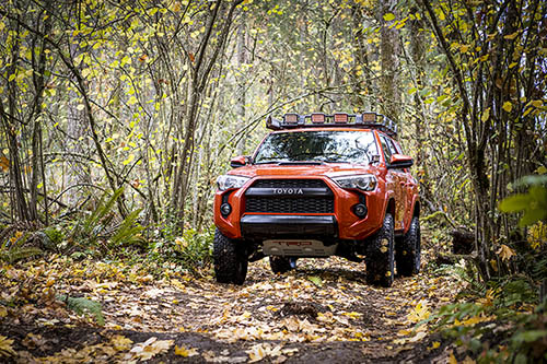

Just wanted to post a photo of my new lift. Came from the stock TRD Pro Bilstein's then to the 6112 Bilstein setup and now this. Absolutely love the setup and feel of the truck now, not to mention the look!! :rockon:
They're still doing the 20% off plus free air compressor and deflator deal.
Highly recommend this, especially for anyone else with an aging 5th gen TRD Pro (mines a '15 I bought new) that's shocks are done/blown. Also, DM me if anyone wants my Bilstein 6112 setup...
Cheers--

I gotta agree with you in recommending the Ironman Foam Cell Pro shocks & coil overs. Quality stuff, built for a tank! At a nice price point.
Would you mind describing how the bilsteins felt over the stock suspension and how the Ironman setup drives? My heart wants the Foam cells, but my wallet says bilstein.
I’m also curious about the difference between OEM TRD Pro Bilstein to the 6112 Bilstein. Subscribed for the follow up.
The TRD Pro stock Bilstein 5100 setup last for about 3 years before I blew a shock. The ride was comfortable with a modest lift and performance, about as expected from an OE setup. I picked up a Bilstein 6112 setup that took the lift up another inch, to about 2.5 front/back and with adjustability up front over the 5100s. I liked the look with the additional lift but the ride quality and overall balance of the vehicle was degraded, especially around sweeping curves at highway speeds (lots of mountain and pass driving for me). I ended up pulling off the suspension after about 3 months because of the killer deal on the stage 3 Foam Cell Pro kit and having heard really good things from friends and reviews online.
What a difference! Super compliant and balanced with an impressive stance. The combination of UCAs, rear panhard bar, end links, etc really helps the truck sit right and the alignment tech commented on how dialed it was out of the box for a lifted suspension. They are built tough and fully rebuildable which gives me extra piece of mind but they are MASSIVE and military spec so I don't see needing to do that anytime soon. Highly recommended!
