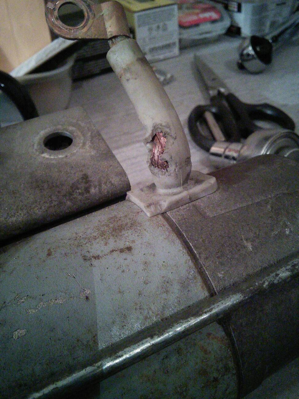

96 with +220k on the clock. Had the single clack non start issue. OK fine I'll change the contacts, no biggie. Start tearing into it and WTF!? Fun, now I get to fight this thing all the way out. Looks like some vermin got hungry and decided that my starter cable looked tasty. I assume this was shorting out on something hence the no start. Wonder how long it has been this way as there is some corrosion on the exposed wire but not much.
I've bench tested it and everything engages/spins, so I guess I'll just clean up the guts, throw some shrink wrap on and shove this thing back in. I'll check the battery cables as well.

Thats not enough rodent damage to cause a no start. Theres more to a starter than contacts as well, while that is a common failure, you could have worn motor brushes or a bad armature. Once a starter motor gets to a certain age it's time to stop screwing around and just replace the darned thing.
