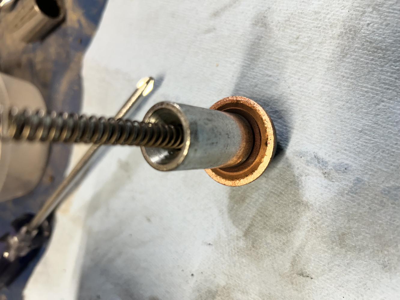

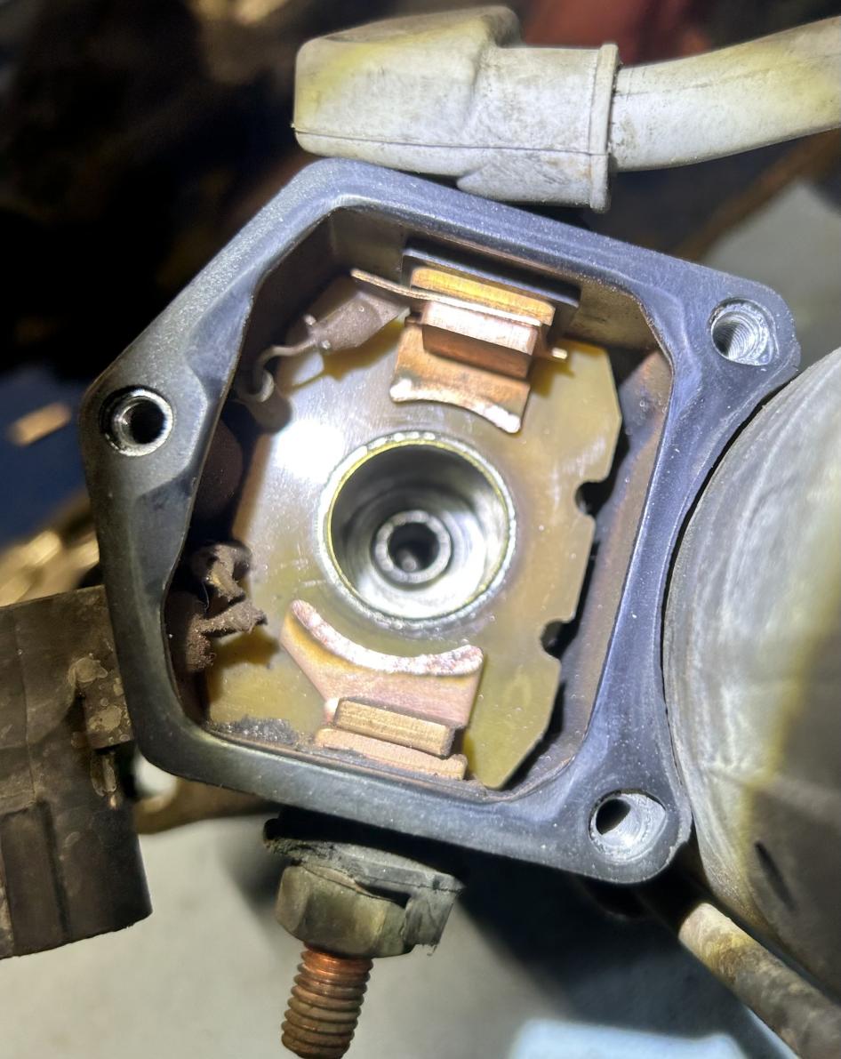

Got the starter out. Contacts and plunger seemed fine other than a little dust. There were some metal shavings and couldn’t tell if they were from the contacts or not. The plunger seemed a little sticky so hoping that was my problem. I lubed the gear shaft which seemed to help. Got it back in and it started fine. We’ll see if it stays that way!
