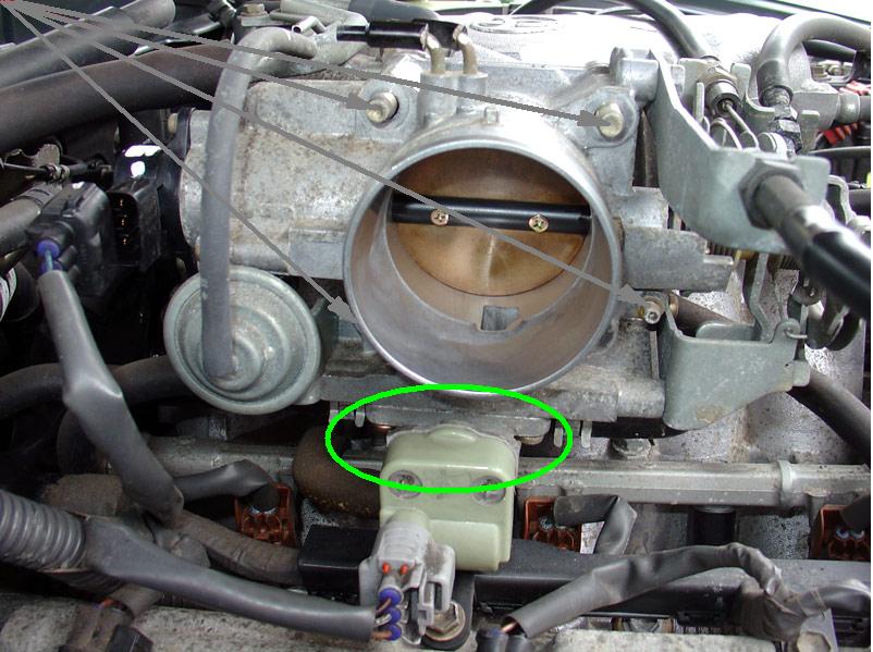

Have you tried cleaning the IAC valve? I don't think thats your whining problem but it may help start up. I'm going to clean mine and see if that helps too.
Stole this pic from a search
Disregard those grayed out lines. I tried to cover them up from the original pic.
What I have circled in green is the IACV? Anyone taken this off and cleaned it without removing the throttle body?

The throttle body has to come off unless you have crazy small hands and screwdrivers.. Have you checked fuel pressure? A clogged fuel filter will usually start normal and idle fine all day long. You notice the filter going bad under a load. If youre capable of testing fuel pressure, check the key on, engine off psi. then check psi with engine running. then shut it off and leave the gauge hooked up over night. See if the pressure is bleeding off which could cause extended cranking time. But first I would just throw the new plugs and wires on.
