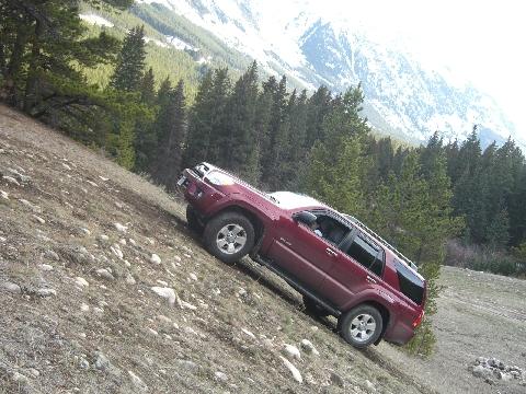

hi,
CORNFED 2.5" lift from jason with 285/70/r17 tire..
airbur said:
I have the stock Dunflops right now, but I'm planning to upgrade to new rubber soon...see my signature below.
Fyi...the picture URL in your signature doesn't link to a 4Runner page.
okay i saw your pics in the other thread. so now after years of not being sure which tp get, i'm 97% sure i'm finally going to be ordering it. planning to do the install myself. wish me luck. o and my cardomain link is correct. 4runner pics are on page 4. i'll be updating that too.
Hi *wishlist*....you'll like it, alot. Let me know if you need to see any more pics...I've got a few others.
already ordered the 2/1 cornfed. if it's not too much to ask, i'd like to see all the pics you have uploaded to the internet. the more i see the i know how mine will look. Thanks in advance.
