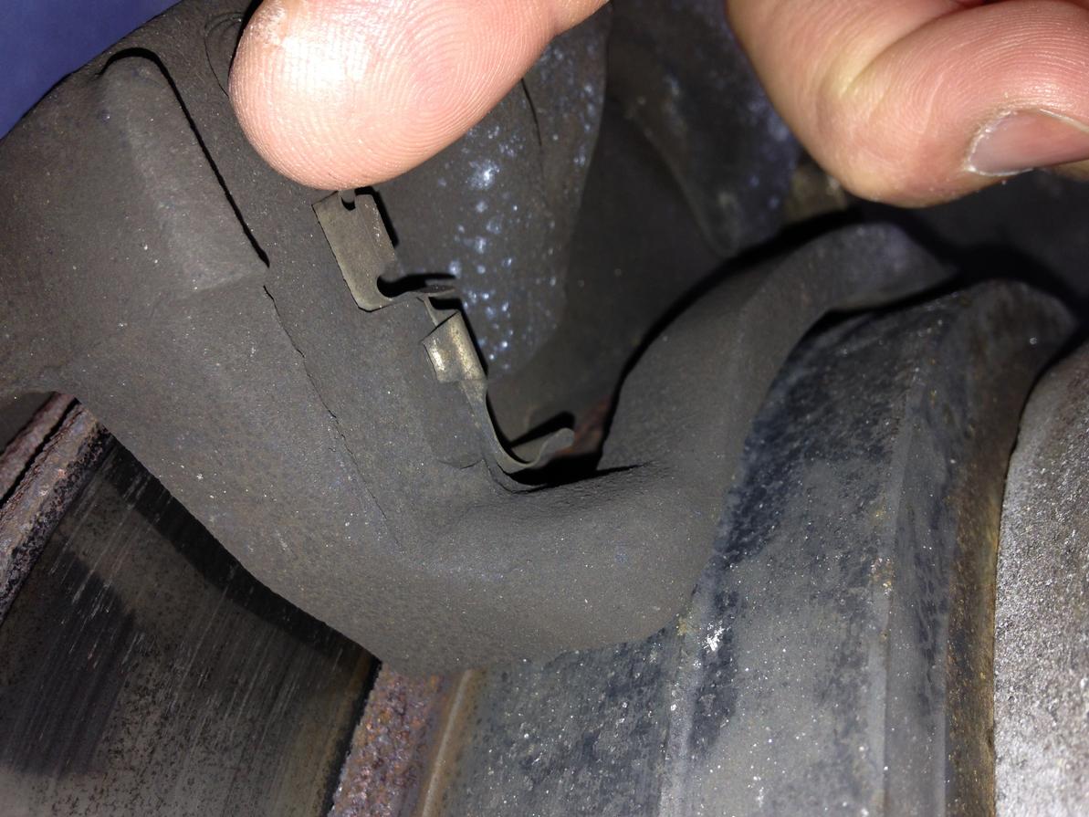

I took a quick look and the clip thing that shows how much pad is left had a nice gap.....but 15k miles and they're done????? I'm hoping this dealer (Huntington Toyota) isn't using aftermarket pads instead of their own
I'm not following what you looked at - what gap are you talking about? The space between the pad and rotor? That is not how you measure pad material. You said they said it had 2mm left. Did you see a brake pad with just 2mm left of material?

I'll take a pic and post the (clip or sensor) that tells you how much pad you have left

I haven't measured the pad material that's left but I know what's left by looking at the sensor/ clip that's on the pad itself (gonna post a pic).... I'm thinking these guys didn't use OEM...... at a Toyota dealership no less

Not sure if it applies to Toyota, but GM uses the thickness of the metal plate and pad to determine change time. Recommended to change if the pad is the same or less than the backing plate. Also they use wear sensors that scrape on the rotor when it's change time. Just look for clearance of the small metal tab to the rotor. It makes a good noise when it contacts the rotor.
All pads are aftermarket, even Toyota pads from the dealer. Toyota doesn't sell the exact same pads used at the factory, they are rebranded from whoever makes them for Toyota. Just like their oil, filters, batteries, most everything like that. I would have walked directly into the shop and said show me. Bet the shit their pants
We all want to know how much pad is remaining before the rotor makes contact with the clip sensor. There is no way that the stock oem rears can wear out at 15k. You can technically baby them from new to 100k if you tried.

Not sure why you are getting so defensive. If you are mechanically savvy and you know cars and you saw what you saw, then change the pads. If you feel there is another issue with your rear brakes eating up brake pads maybe you should raise the issue and have them check your entire brake system.
Don't mean to insult but do you know for sure the rear breaks were done at 45000. Maybe that's where you got ripped and now you need rear brakes at 60000. Just spit balling here
Here's a pic
Pic of brake pad sensor
