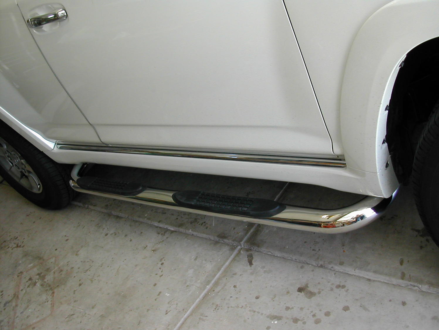

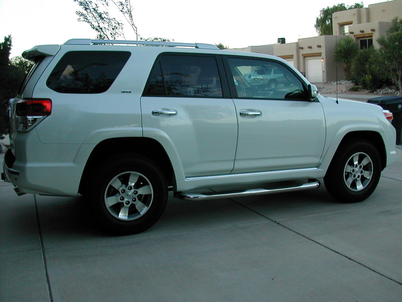

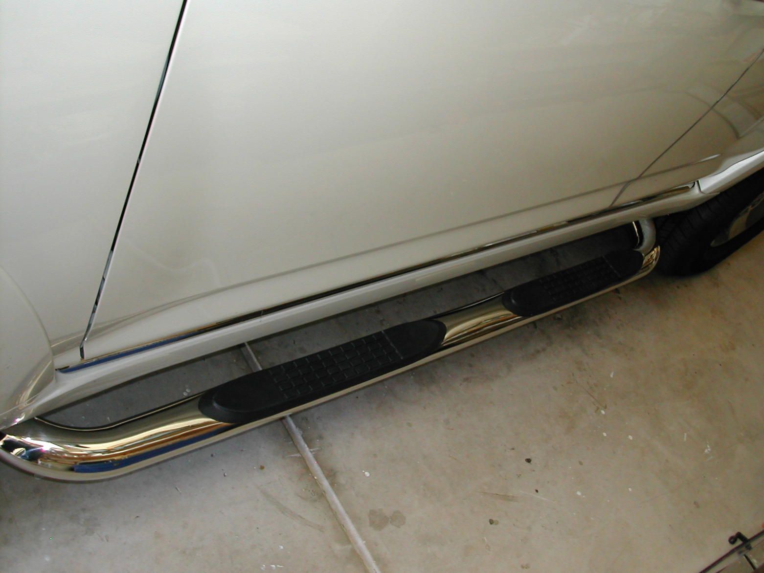

Steelcraft stainless steel nerf step bars arrived from autoanything. Installed in an hour or so. Great product/instructions

that looks great. How does it affect ground clearance? I don't do a lot off off roading (mostly flat trails, beach) but we have been getting feet and feet of snow here the past few years.
Hey Riser, Looks like I lost about 1 inch of ground clearance. The gas tank is almost even with the new installation.

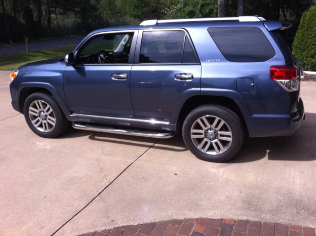

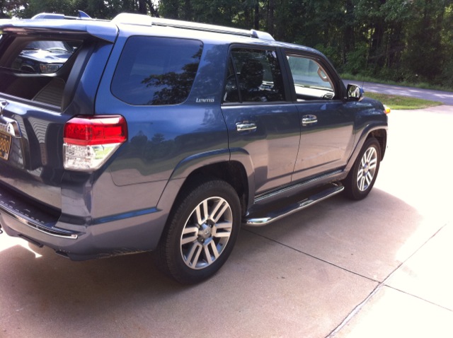

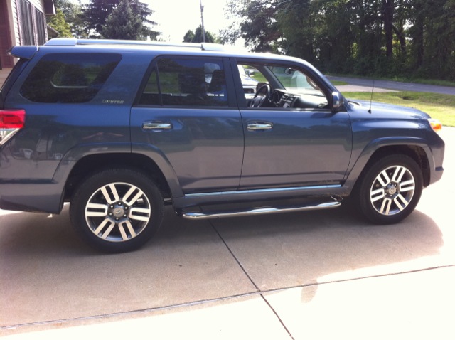

Just installed a set of these on the wife's limited - like the way they look and now my 9-year old has something to assist here when climbing in the car (better substitute than grabbing the leather seats and pulling up, or the pocket behind the front seats).

I was originally going to go with black, but the SS look great.
