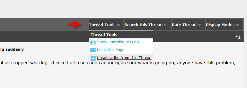

Just FYI, there IS a setting to automatically subscribe to a new post. I guess it's turned off by default but I turned mine on. However, at the top post there is a "subscribe" drop down where you can click to subscribe or unsubscribe.
