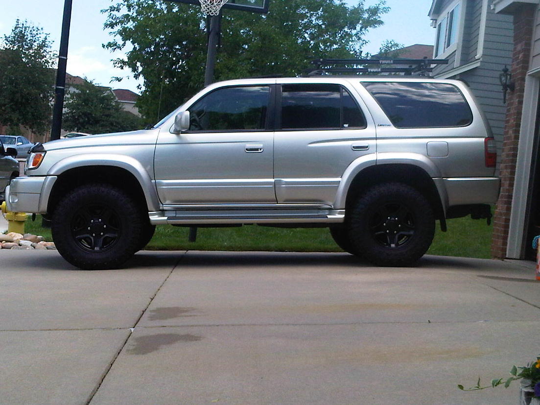

Quick question for folks... I have a 99 4Runner that I just got setup to do some wheelin. I lifted it (OME lift) along with some new Duratracs and hit the road. I've noticed what I think is something steering related that is causing an annoying issue.
When I go over moderate bumps with the front wheels, I can "feel" and hear the steering wheel make what I can best describe as a clunk... clunk sound as the wheel travels over the bump. I don't suspect it is suspension related (i.e. struts etc), and think the culprit is likely in the steering box, or related components.
Any thoughts? What do the poly bushings on the steering components help with? I suspect my issue may be as simple as the old rubber bushings being rotted / shot.
Oh, and the obligatory picture of the Runner. Not great quality, but shows the progress so far.
