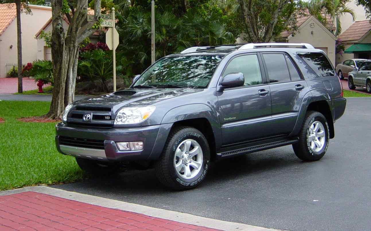

The dealership made 4 unsuccessful attempts to resolve the steering vibration at highway speeds with my 2005 Sport. I filed a MV defect notification with Toyota and am scheduled for a final repair attempt next month.:(

Don't get a bad impression of your new 4Runner. After I swapped out my Dunflops, no more steering vibrations and no more drones. It kind of felt like I was driving a different vehicle. BTW, your truck looks very nice in that picture! :D
