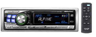

The Alpine CDA-9851 (sold on Crutchfield) is the only deck right now that actually has OEM Steering Controls integrated into the stereo.
This is true integration, not the cruddy PAC-SIWX (or whatver it's called) that uses infrared.
The Toyota to Alpine steering control box should be available through PAC in about 10-14 days.
You can also go to www.alpine-usa.com to view the specs on this unit. Crutchfield doesn't mention the OEM controls on their site, but it does on Alpine's site. I have verified by talking to Alpine's technical support.
Alpine CDA-9851
I forgot to mention that not only will the Alpine CDA-9851 work with your OEM steering controls, it will also run Sirius or XM.
I almost installed it but did not for a few reasons:
1) The unit only takes up 1 din (I prefer the factory look)
2) The unit is silver, not black
3) The OEM control box is not quite ready, but will be in about 2 weeks according to Alpine and PAC

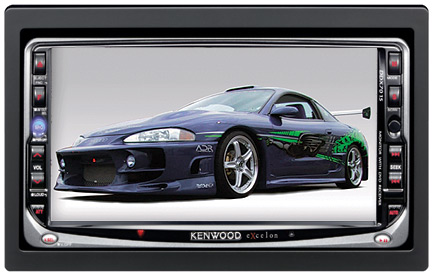

If I wasnt going to do a full carputer, I'd eyeball something like
THIS
double din...nice touch screen....all the good options :)
