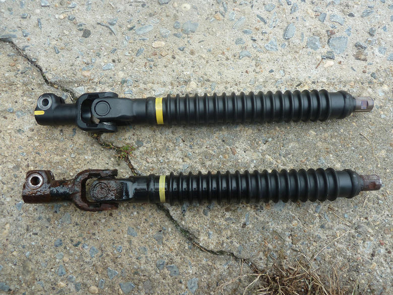

Spray the steering linkage u-joint with white lithium grease. Can be seen from driver side wheel well.
The u-joint and linkage as seen in this pic.
^^ If you live in the rust belt area(which is why it failed in the first place) , changing the joint is stupidly a pain in the arse. Everything is seized up.
Tip. When installing the new one in. There is a dot on the steering spline shaft where the joint slides over. The white or yellow line on the new u-joint shaft needs to align with the dot. The rust and corrosion will hide the dot but it is there.
