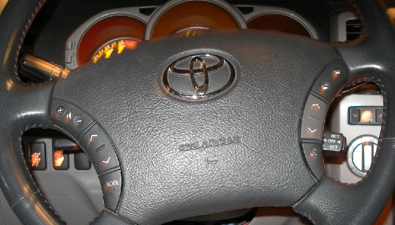

Hey guys, I happened to swing by a junk yard earlier and picked up a steering wheel switch out of a Toyota something out there. Anyway, a lightbulb went on over my head and this was the result.
Notice anything different?
Well, if you didn't notice, look at the right side switch bank. I took the center switch from the left side and put it on the center position of the right side. I know it looks goofy being a different color, but it may create two more button functions for aftermarket systems. I honestly doubt it will have any affect on OEM systems, however that is a possibility too.

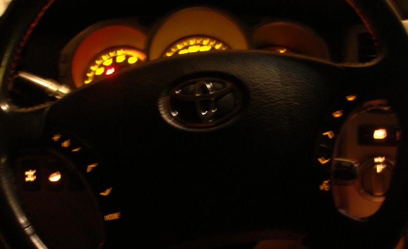

Here it is illuminated.

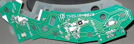

I removed the right side switch bank and completely disassembled it. This picture is of the circuit board for it. The two center positions are labelled "display on" & "display off". There is also another position on the board which is unused on our vehicles labelled "acc". I am assuming it is for the cruise switch on the Siennas. This may also be developed for another function for us as well.
When I reassembled the switch bank, I installed two white pieces which are used to transfer the pressure applied to the switch, to the circuit board contacts. I got these from the extra switch bank I just bought, and are needed for the switch to function. The switch does not fit 100%, but does work & I can feel the button press to detent & return. It would definitely be nice to have the intended switch installed there.

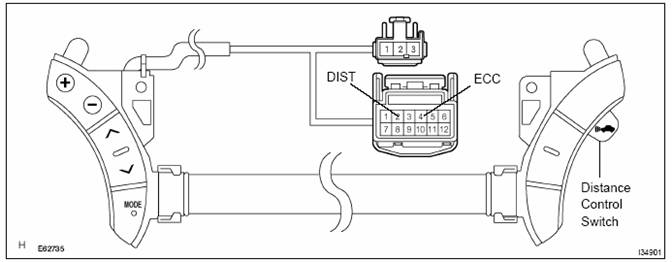

Anyway, Here's a diagram of the Sienna's steering wheel switches. The Distance Control Switch is the one I believe uses the "ACC" position on the board.
