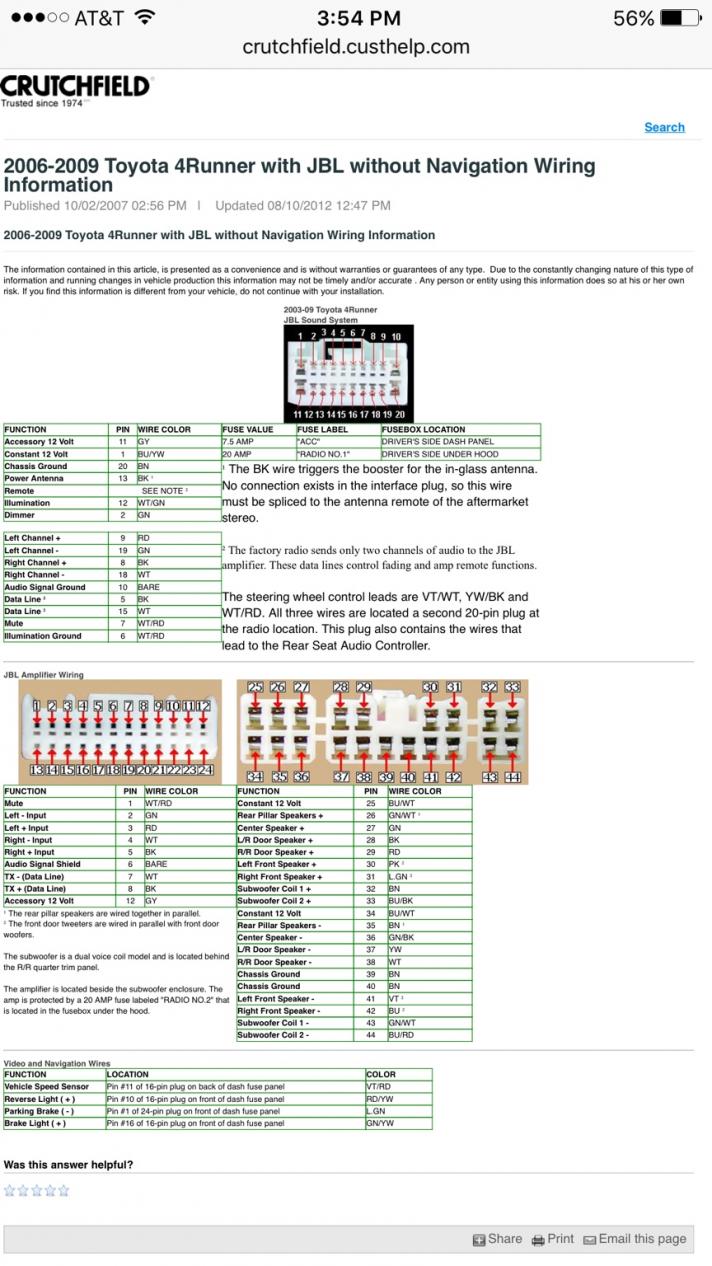

If you got the NIB radio you should have the diagram of the wires and what each one is. You know the JBL has 10. So you would have to match the new radio wires where you can. Here's a wiring diagram from Crutchfield for one without the NAV, which is what you have in your 2007.

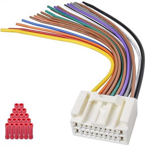

I found this harness on Amazon. It might be better than cutting off the one from the JBL radio
Amazon.com

Thanks for the solid advice and especially for the wiring diagram. This is a huge help. It wouldn't bother me to loose that center dash speaker. I think what makes the most sense is to see what a local shop might charge me as they do this stuff everyday. Then check out Crutchfield and see what they have that would make for a far easier install. It seems having Navigation in the head unit isn't a big deal any more as everyone just runs off their phone. Thanks again for the replies and I hope y'all have a great day. NCH
