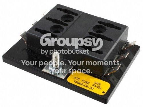

Are you trying to amplify the speakers as well I will consult with crutchfield to finalize the wiring. I want to use the 5 channel amp for the 4 speakers as well as the subs on one channel. That was the amp they suggested. I got it quite a bit cheaper elsewhere. I really like Crutchfield and buy all my radios there. Speaker tend to run cheaper on Amazon or ebay as well as amps. I bought from Sonic Electronix and will report on their customer service. I have bought battery terminals and wire from dell city, a great source for solder on battery terminals preloaded. I will bore a new hole with grommet installed for my additions to the engine bay. I picked up this fuse block and will add 12V outlets under each front seat for phones, etc. Radio came today from Crutchfield!

Are you using that fuse block in the engine bay or exposed to the elements? I'd reconsider using that particular block if that was the case as it allows water to short out the circuit if you are not careful. I used them in the past for aux installs and they work well if covered. Now We only use blue sea system covered fuse blocks. I used to order stuff from crutchfield when I was younger and they have great service, I'd highly recommend them if you need help and info on stuff. I've since moved to custom audio builds and generally just buy the units from BestBuy if its something I need right away or order from amazon. Also out of the brands I've dealt with I think the one I prefer most is Alpine for headunits. Very nice interface and great value for the money. Only draw back is the option to change color of the face if that's something that is important to you. All of their headunits are blue colored interface with the exception of a few red ones.

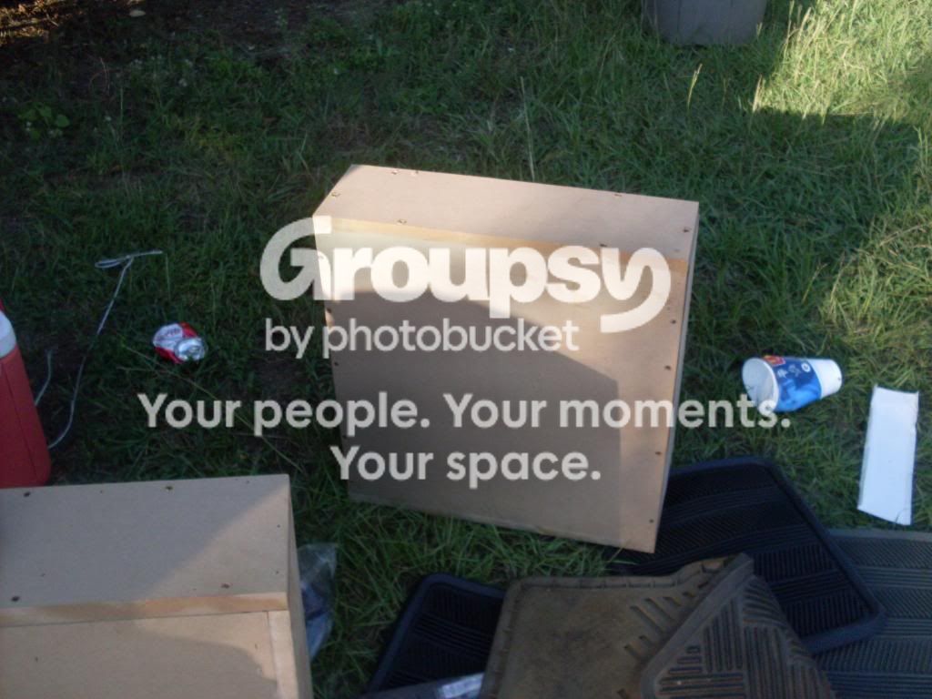

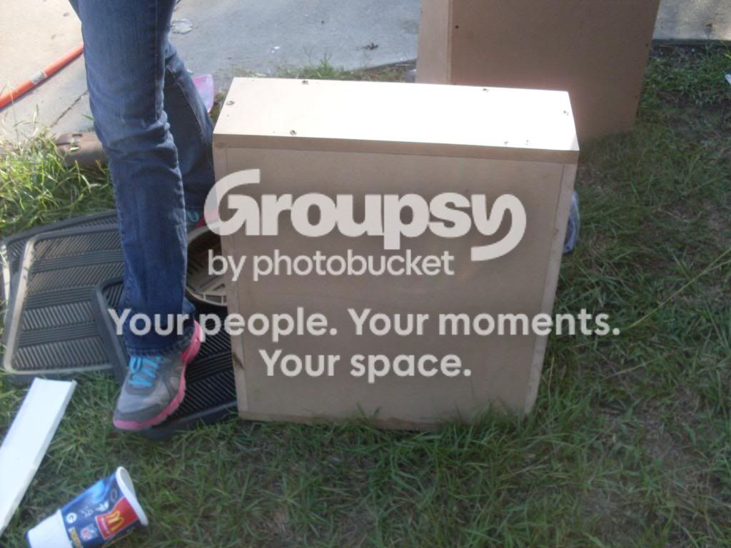

Have to spend some time on the link. Built the sub boxes tonight. Got hurried and didn't research and measure enough but they will punch bass. A little tall and could have done better. Pictures to come.

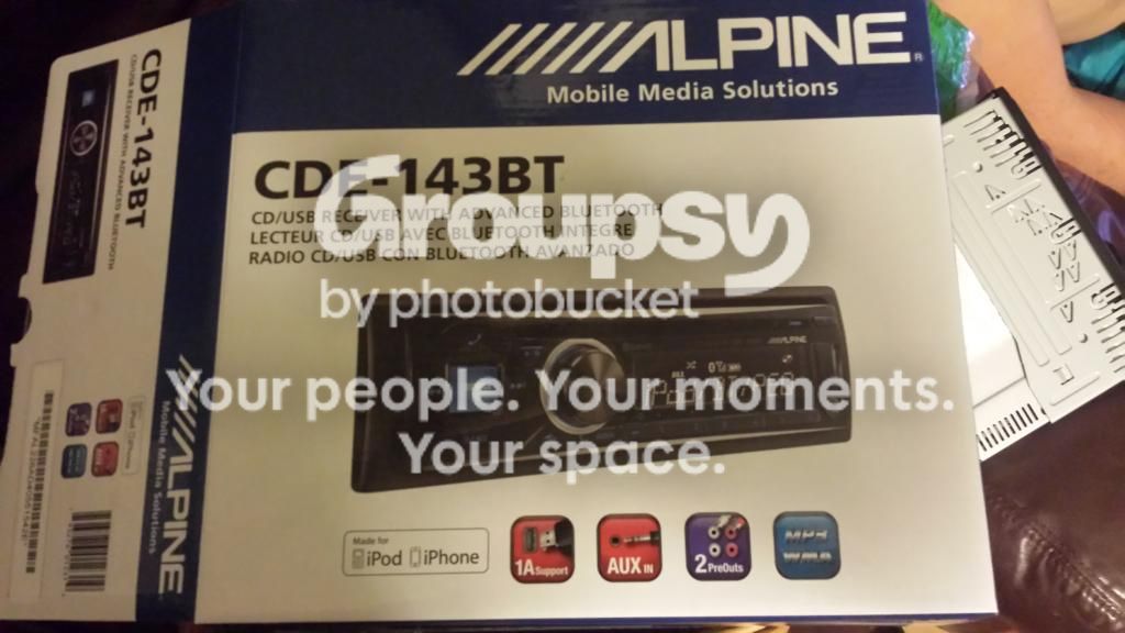

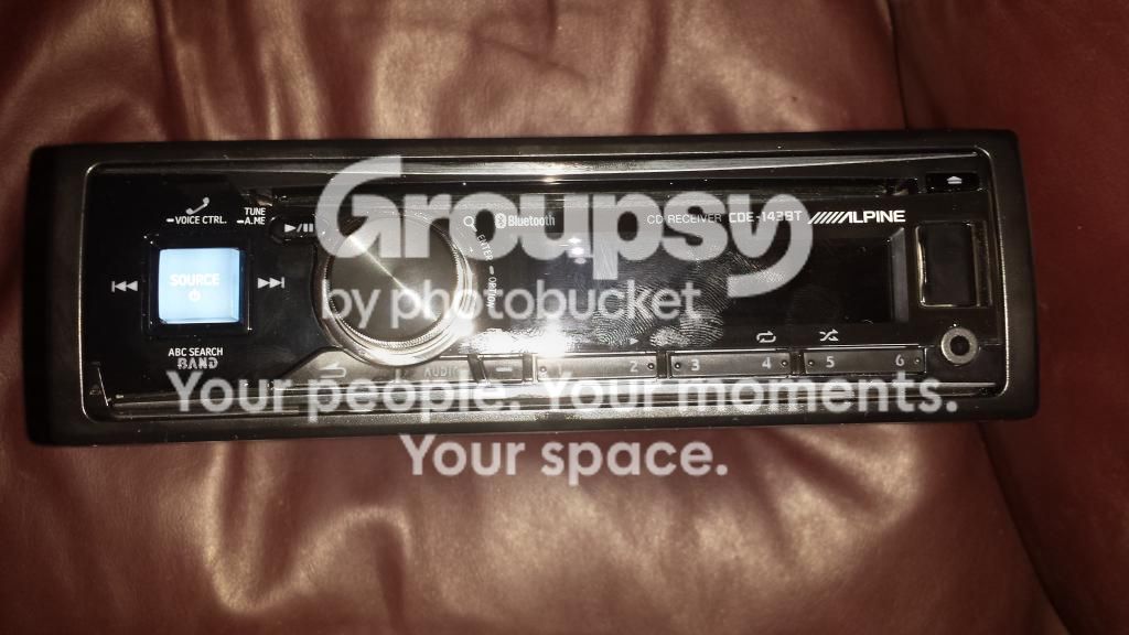

The Alpine receiver I purchased only has two pair RCA out jacks but the JBL amp can sense the signal that needs to go to the sub and directs it to the sub automatically. Pretty cool. It also can turn itself on and off based on its realization of any signal coming to it. If you kill the radio it times out and shuts down. Also cool.

Waiting on the amp and some cables. Here are the boxes I constructed with an old friend and a few buds the other night. Much easier in his cabinet shop.

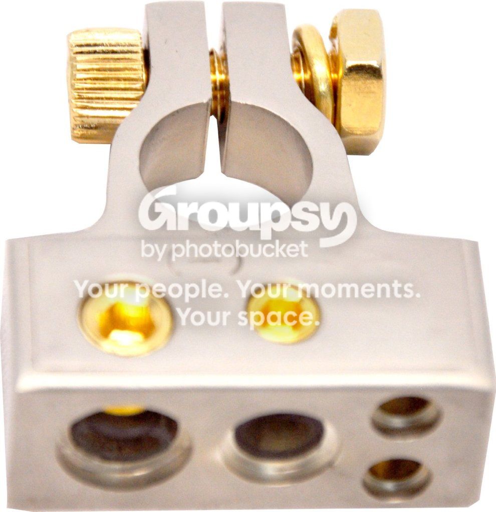

I also bought these battery terminals.
