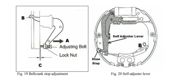

-The rear dums: ever since I replaced the bell-cranks/shoes/hardware a year ago, I have always had a struggle with the adjusting bolt/lock nut, and their respective clearances from the backing plate. I have lost the Driver's side adjusting bolt and lock nut, twice now, and currently have neither on the driver's side, so the rear shoes could be out of whack.

The brake shoe adjusting "bell cranks" (not the one you mention about the park brake bell cranks) are specific to a side. Since you replaced the two, probably you got the two switched. When installed incorrectly they can push the brake shoes towards the drum to apply brakes or no adjustment at all.
