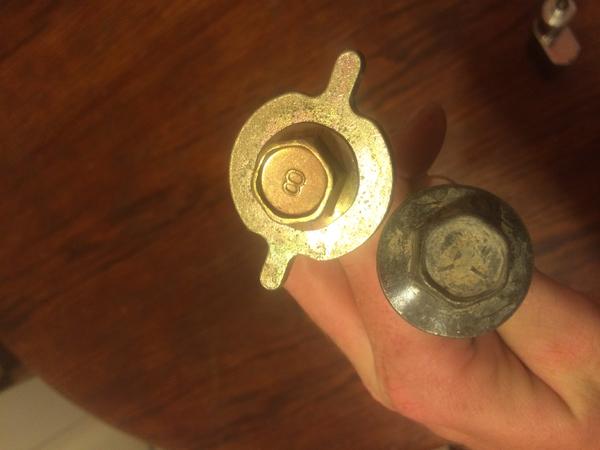

Hi guys ! I would need a good guy who would tell me the lenght of the stock body bolts for a 4th gen Runner. I wanna remove my body lift to run 32s. Thanks

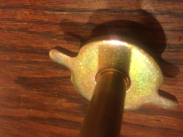

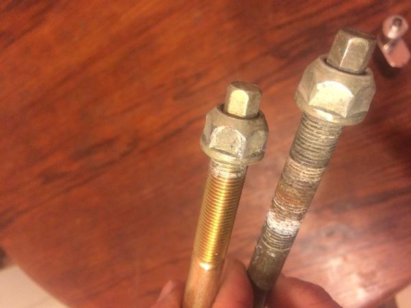

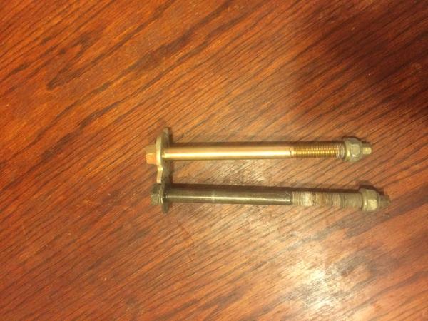

The bolts are all M12 x 1.25. Length of one is 6.5 in, other is 7in from the base of the head. There are 4 of each.
These are actually some interesting bolts... The stock ones have pretty serious flanges/washers that I doubt you'll find anywhere (the gold ones actually have teeth that lock to a washer. And the bottoms are hex pattern. But, I know the ones for my body lift just have big washers. Should be fine if you just go that route.See photos below.
