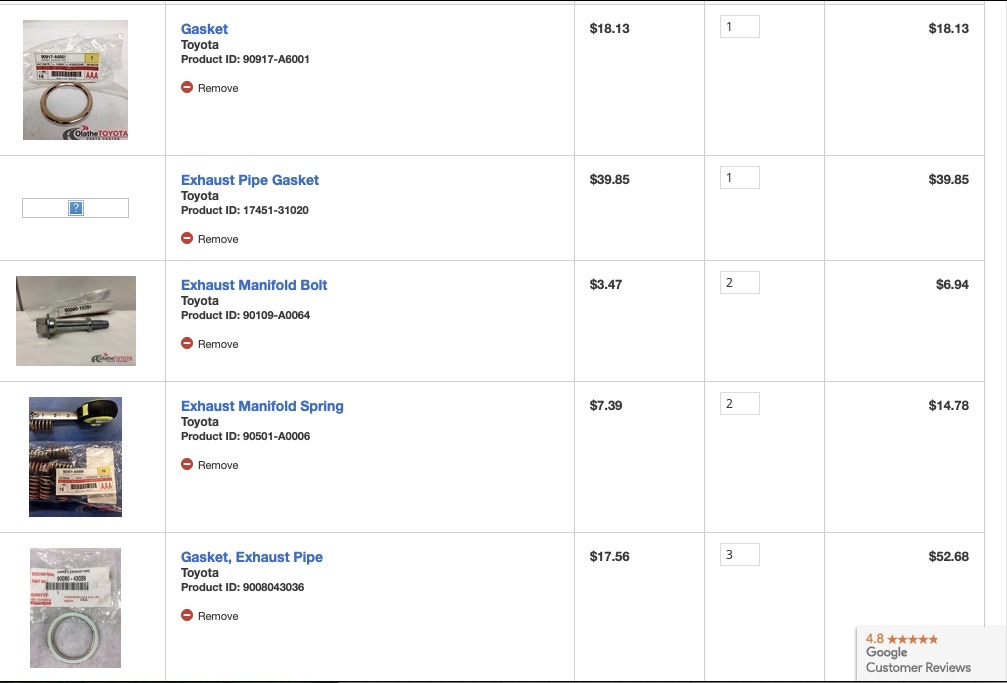

I'll answer my own question here, at least as far as I can tell from research anyway.
I referenced Parts via Toyota parts website and cross referenced part numbers. Everything matches as far as muffler and tail pipe. I'll have to get the donut flanges and am working on a parts list for that.
Adding the parts list here in case anyone else decides to do this service at some point. So if you just do from cats back then you need the top parts. If you do the gaskets at the other three joints you'll need three of the last part number gasket. I'm just doing the two from in front of the muffler back. It's recommended to replace bolts if they're rusted out.
