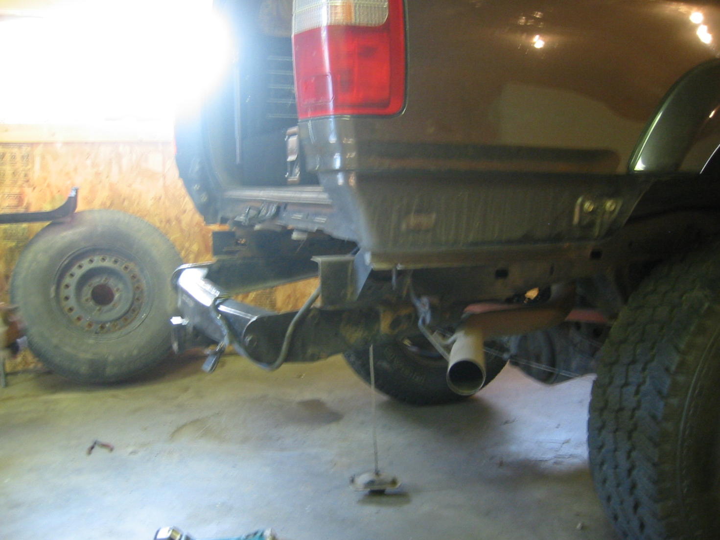

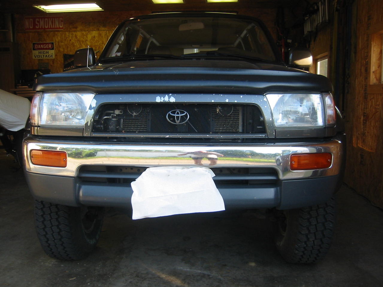

Here's the before pics

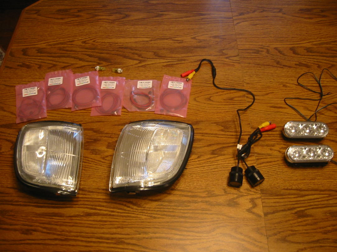

Some of the new goodies showed up today. Front and rear cameras, backup led lights and the clear corners that I will make into blinkers with the led's I ordered. I might get a start on it tomorrow depending on the weather.

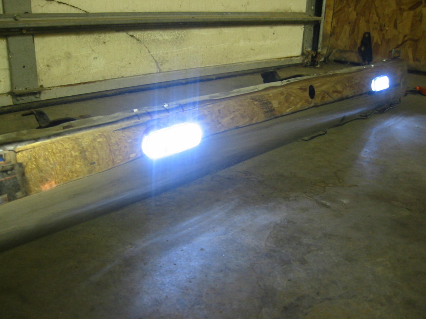

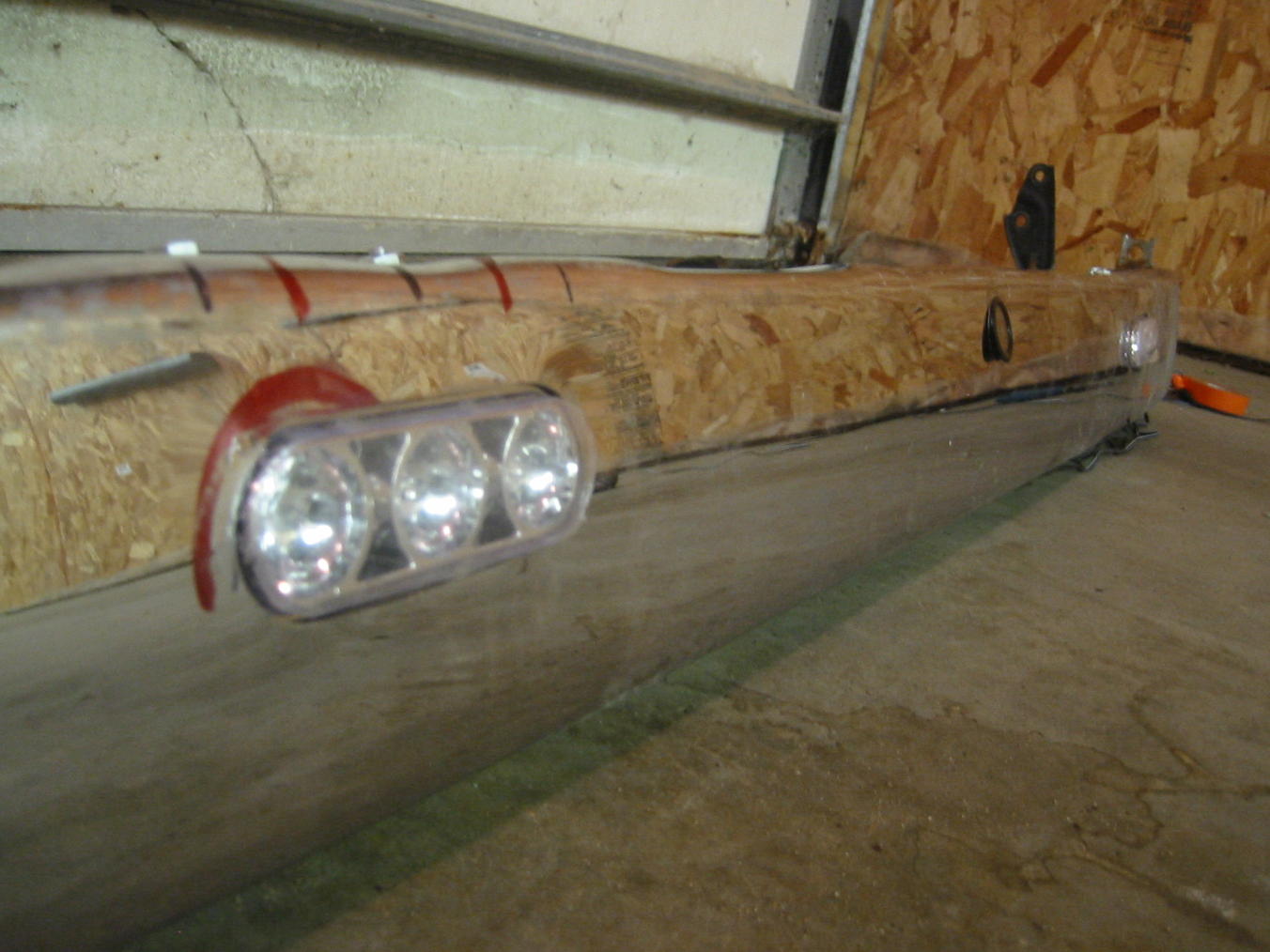

Well I had a little progress tonight. I got the Led reverse lights cut in and also the back-up camera. Still debating where the flush mount 4pin trailer connector will go. I think the light will be plenty bright for reverse lights.

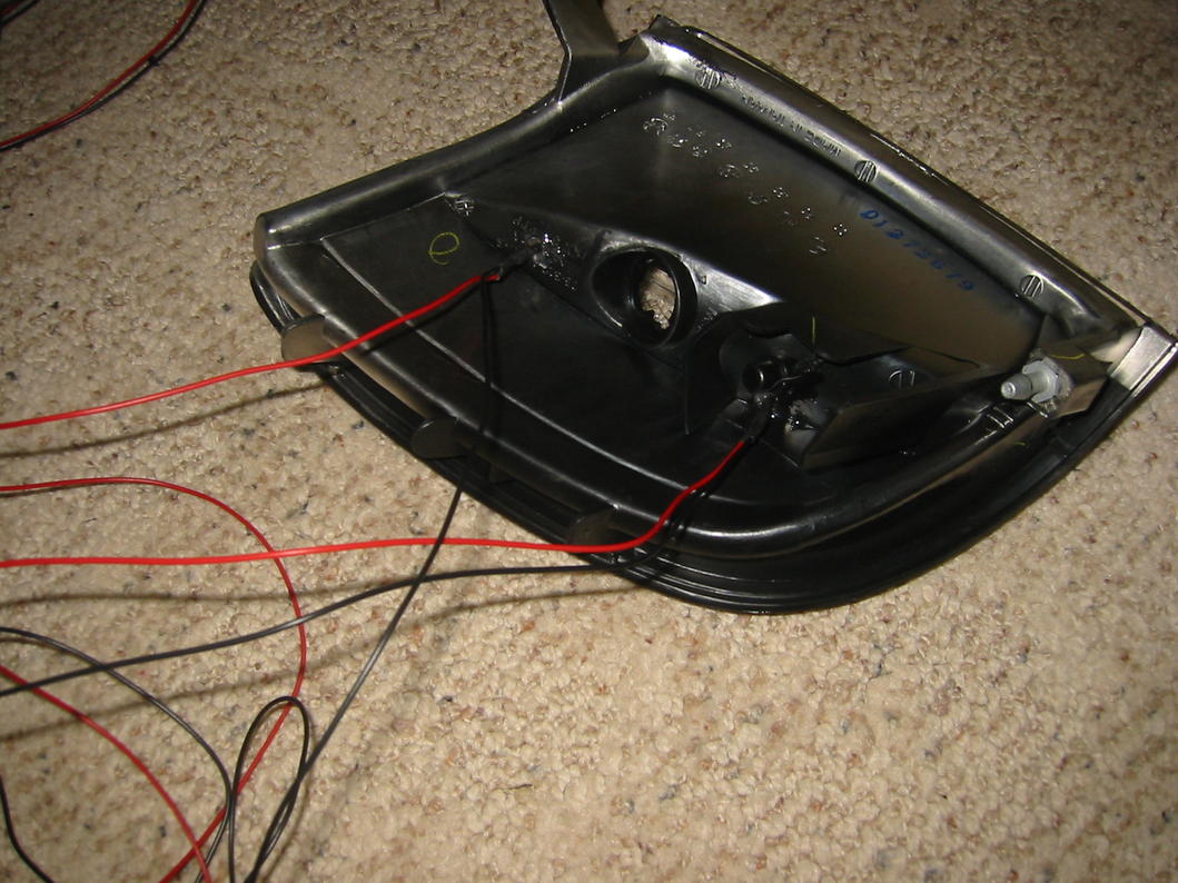

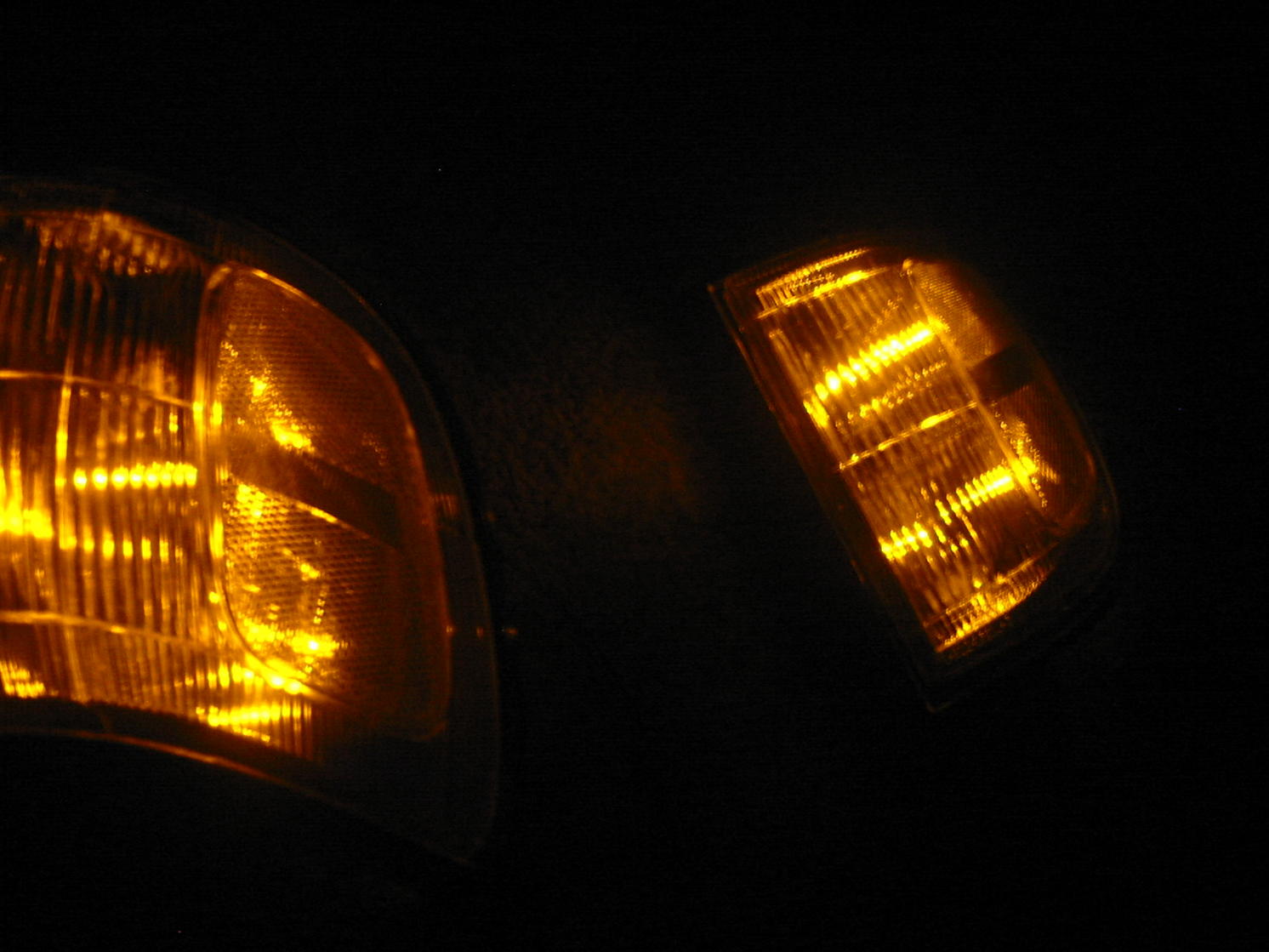

My new clear corners didn't stay new for long. Drilled a couple holes in the back for yellow led's. They will be hooked up as the marker lights. I ordered 4 for each side but used only two. They were plenty bright. Can always add some. I held them in with one minute epoxy. Work Fast!!!!! They 194 light will now be the blinker. I got 45 lumen 5 smd led's in yellow for the blinkers! They will definitely do the job.
Oh and don't worry about the chrome. It will be truck bed coated and painted the same color as the flares and rockers. Finally no more bling left

what kind of LED reverse lights are those? im lookin for something similar? they look pretty bright . . . how are they in 1st person @ night?
Are you going to remount the lower section of the front bumper? I realize its only plastic but it seems it would help protect the lower section of your condensor and radiator. Without it seems very exposed.
Yep front and rear cameras. More a novelty than anything. Going to have a switch in the console to toggle between the two. Going up hills when you can only see the top of the dash you can flip the front cam on and watch whats going on. i have 7" touchscreen indash dvd player that has cam inputs.
The lights are fairly bright. not like 55w fog but for reversing up to trailers and such they will work great. $16 ebay specials. haha.
