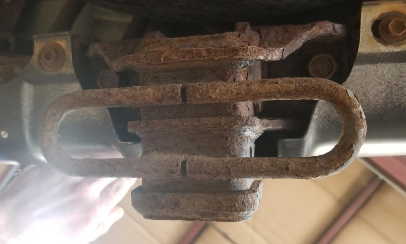

I have a 2004 4.0 Sport. The vehicle is equipped with the stock hitch and 7 terminal wiring. My question is whether or not I should upgrade the hitch to a frame mount style. The boat and trailer is well under the max of 5,000 lbs, coming in at 2,225lbs. I have not been able to find a tongue weight yet but would estimate 150-165lbs.
My only real concern is that the stock hitch and rear frame section do have some rust. I have been descaling the entire frame and treating it section by section.
I imagine tapping the holes and mounting the frame mount hitch will surely have it's headaches with a vehicle this age from New England. But, at the end of the day if its going to be much safer I will definitely do it. Am I being paranoid or should I upgrade? Thanks in advance.

If it were me, I'd go with the bigger hitch.
Is it overkill for the boat? Absolutely.
Will it be safer and is it worth doing? Absolutely.
My $0.02, I'd rather have the bigger hitch because There's no telling what I'll end up towing. Most of the time it's a small 5x10.utility trailer, but I've pulled some pretty big stuff previously and it was nice not having to worry if the hitch would be sufficient.
Ignoring the rust for a moment, I would trust the factory hitch receiver over anything else up to and including the limits of rated tow capacity. Taking the rust into consideration, it's a judgment call. If you have any reason to believe the receiver is compromised you are better off replacing it. I can't really advise beyond that without looking at it myself.
On another note; if the total trailer weight is 2,225# and your tongue weight is only ~165# the trailer is going to sway like hell and be extremely unstable. Tongue weight should be no less then 10% of the trailer weight, with a target of ~15%. Generally heavier is better as long as you don't exceed the maximum rating of the hitch and receiver. It's usually pretty hard to adjust tongue weight on a boat trailer because the load is "fixed", but they are usually designed to have the appropriate weight distribution. If the tongue weight is significantly low it's a sign the boat isn't loaded properly. If it's close, but you wan't to improve it a little you can add a cooler, or some other boat-y type accessories to the bow.

I have driven the trailer before with a Cadillac Escalade and its fine. I do not know the actual tongue weight. I took a calculation from a website online that used 7% of the total weight. I did not come up with that formula but saw 5%-10% for single axle trailers listed on multiple sites. I may try the bathroom scale method mentioned on E-trailer to calculate the actual tongue weight when I get a chance.
I do not think the hitch it compromised beyond safe using. I'm just more of a better safe than sorry type person. I have been an ASE cert. tech for 16 years and am definitely capable of the work. It was more of a "is this really worth it" type things.
