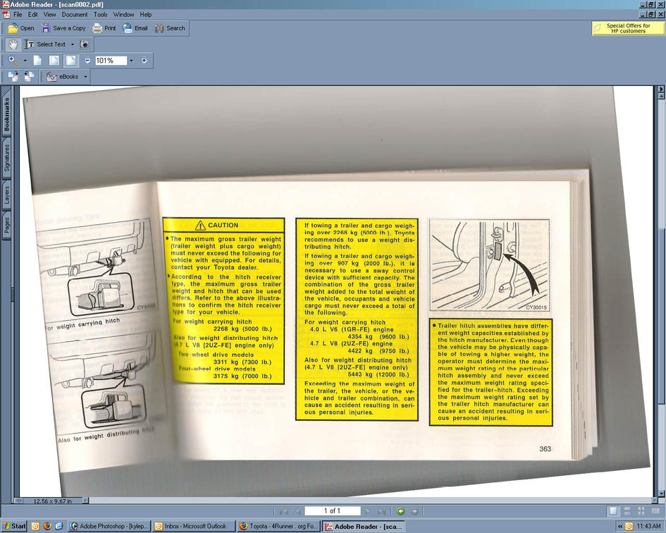

To the best of my knowledge, a WD hitch was not available from the factory with the V6. The stock weight bearing hitch is bolted to a crossmember just behind the rear bumper cover. It is not designed to take the load of a weight distributing hitch setup. If you actually have a weight distributing hitch, it will be a tube (round or square, which spans across both frame members, and is bolted directly to these frame members, not the rear crossmember.
I don't have the book in front of me, but I think the max the V6 can tow is 5000 pounds in any configuration.
According to my owners manual, my '03 V6 is rated for 5K with the factory installed weight bearing receiver, but the rating is increased to 6.5K with a weight distributing receiver and weight distributing hitch properly installed.
see attachment...
