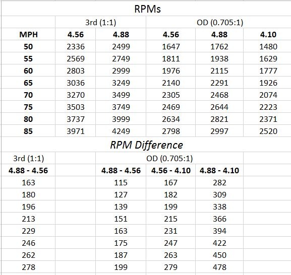

I am on the tail end of doing my research for differential regearing, having lost too much torque after a lift and tires. My 04 DC TRD auto Tacoma is lifted ~3" and wearing Cooper Discover ST/Maxx 255/85R16s. Cooper has the true tire diameter listed at 32.8".
Maybe my search terminology is terrible but I have googled my brains out for the stock powerband for the 3.4 with zero success. I am hoping to use the numbers to help me decide between the 4.56:1 and the 4.88:1 gears. The only thing I have found is a generic statement about the powerband being narrow but I want to pick the gear ratio that lands an average cruising speed in that RPM window. If anyone has that information in any form I would appreciate the share.
I used the gearing-RPM calculator at csgnetwork.com that includes a final-drive input so I could compare RPMs in 3rd and OD between the gearing options. I also verified the accuracy to my current setup by noting GPS speed and RPM and inputting those values to confirm. I found the calculator to be around 20 RPMs different from what I could eyeball from the in-dash tachometer. See those numbers in the attachment.

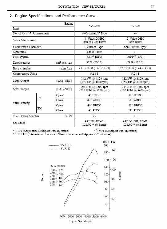

The 2000-2600 RPM window pretty much covers a 65-85 MPH window in OD with factory gears and tires. Are you aware of any dyno curves that support the effectiveness of that RPM band?
Here's an engine dyno chart of a stock 5VZ-FE as compared to the old 3VZ-E.
Peak torque of the 5VZ-FE, is at 3600 RPM, peak HP is at 4800 RPM.
That's probably the crappiest power band I've ever seen. Explains why I have to drive the highway in 3rd gear to maintain 70mph on flat ground.

Like many others I've narrowed it down to the 4.56s and 4.88s and have no problem going either way. I realize at this point it is only a game of +/-200ish RPMs but if the efficiency window for cruising speed is only 600ish RPMs wide the difference in ratios is 33% of that window. I'm still looking for the technical information to make that decision.
