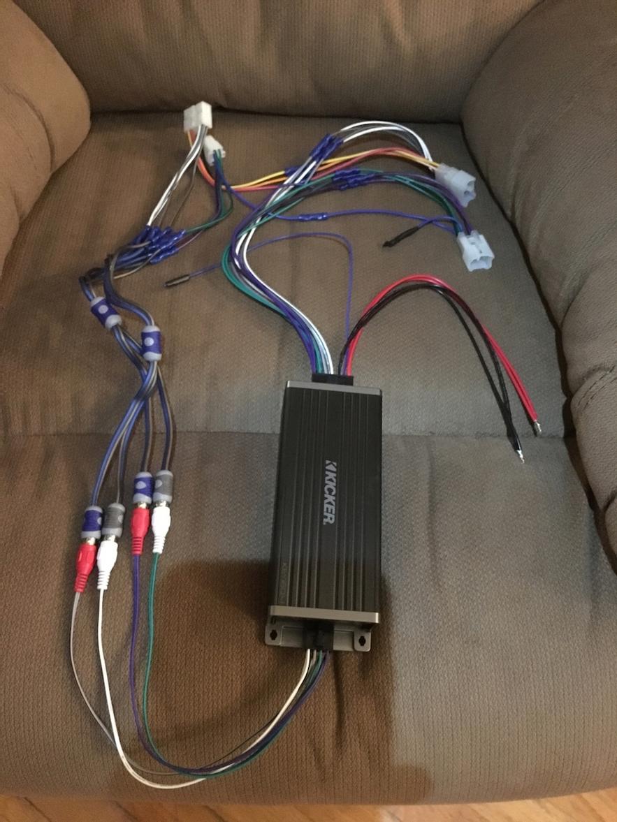

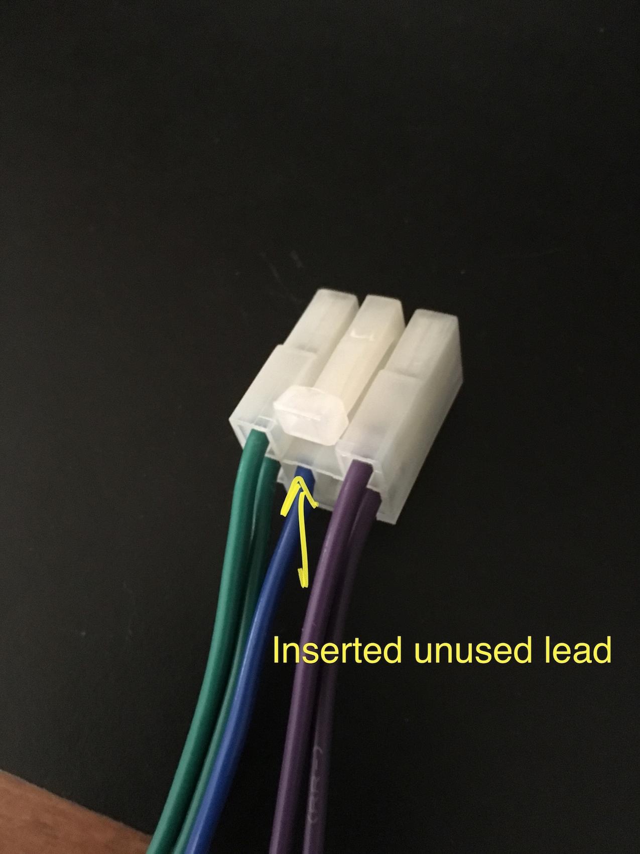

I ordered this amp from Crutchfield and have to say I'm thoroughly impressed! I bought both radio wire harnesses to avoid splicing and it went in very smooth. To set up, you plug in the mic and place it on the top of the headrest, play the pink noise generator from the Kicker website (I did it via my phone / bluetooth), turn up the radio and get out of the car. It ran through a series of beeps and tones to each speaker, played the pink noise, and within 3 minutes it was done (plays a "happy tone"). Adjust the two gains on the amp and you're done. For anyone wanting to keep the factory radio look, but add power and fix the terrible EQ, I highly recommend this amp! I have Alpine components in the front and Rockfords in the rear doors (have not replaced the tailgate speakers). I don't have a sub, but there's plenty of tight low end from the fronts now. I didn't want it loud, just tuned, and the amp does it incredibly well. Note: I did the Party Mode Mod a while ago, so this EQ was factored into the tuning.
You have the product numbers you ordered from Crutchfield (incl amp and harness). Any pics of install?

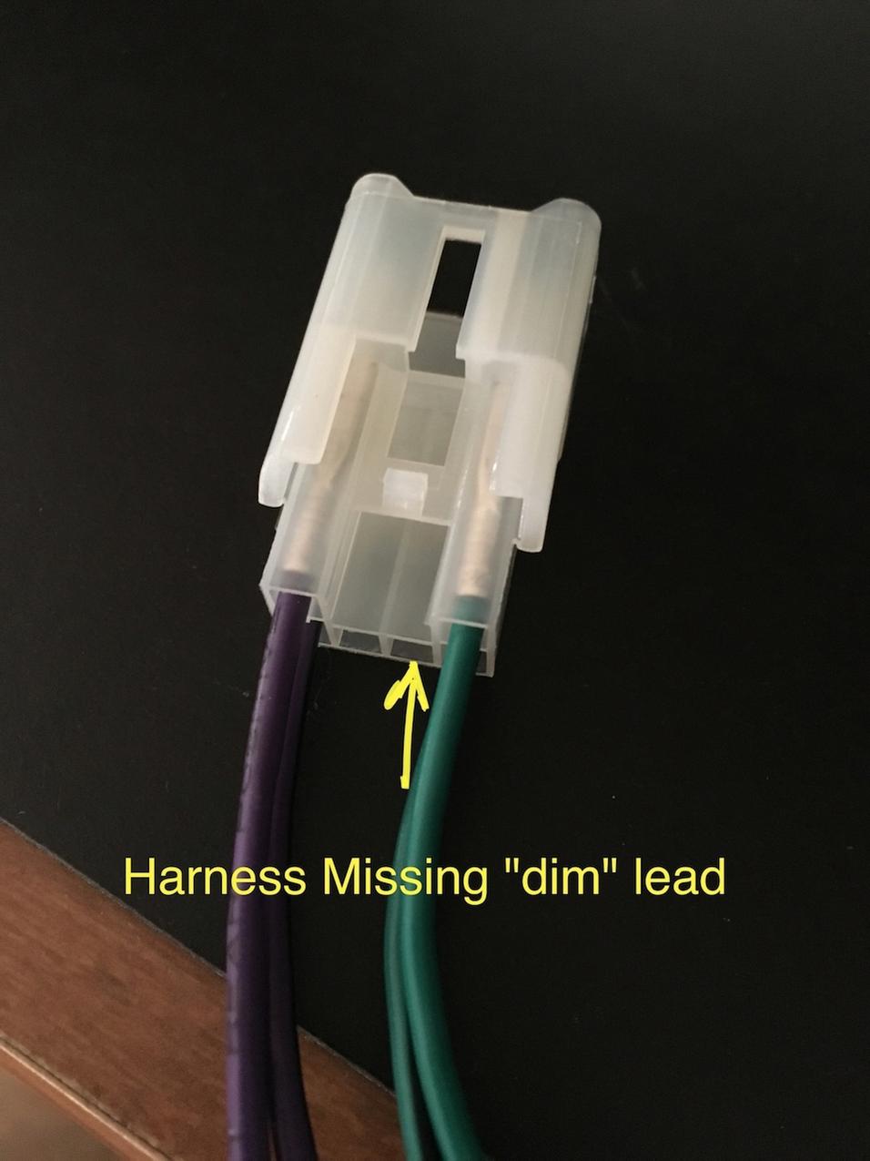

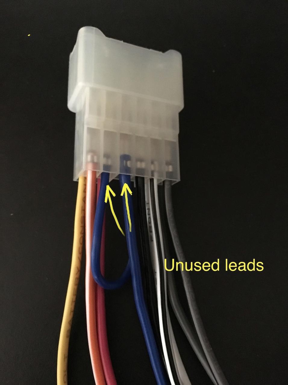

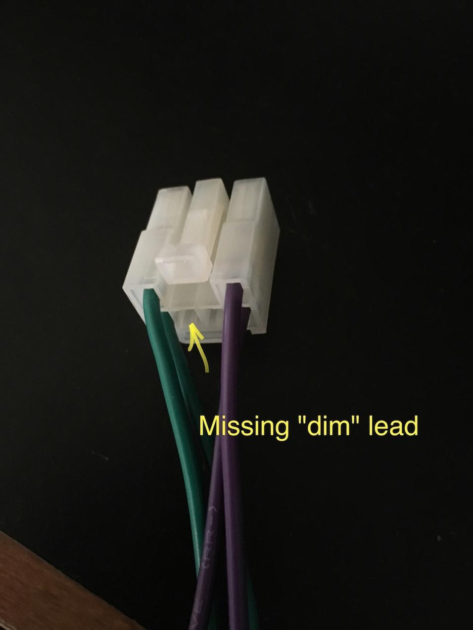

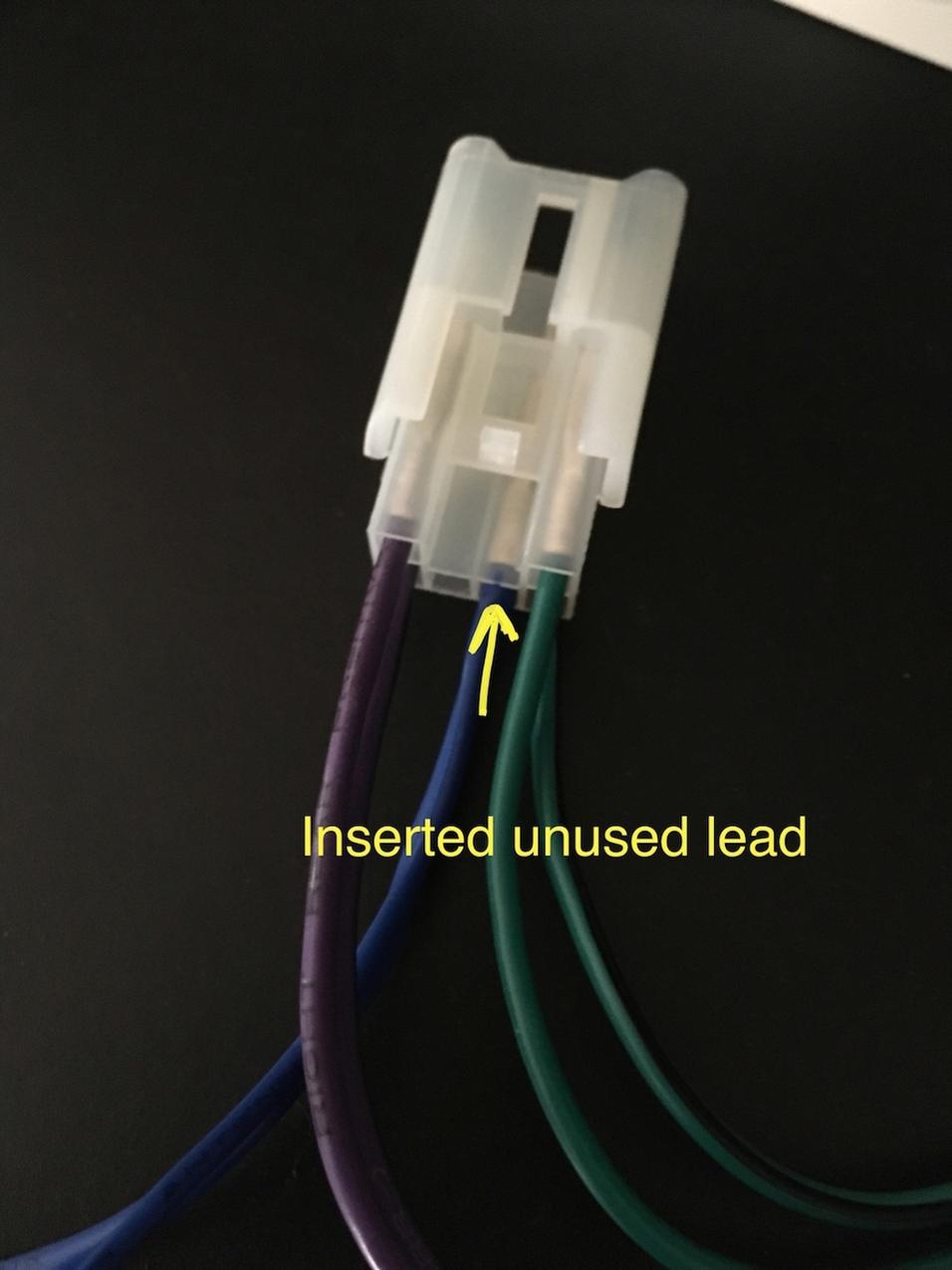

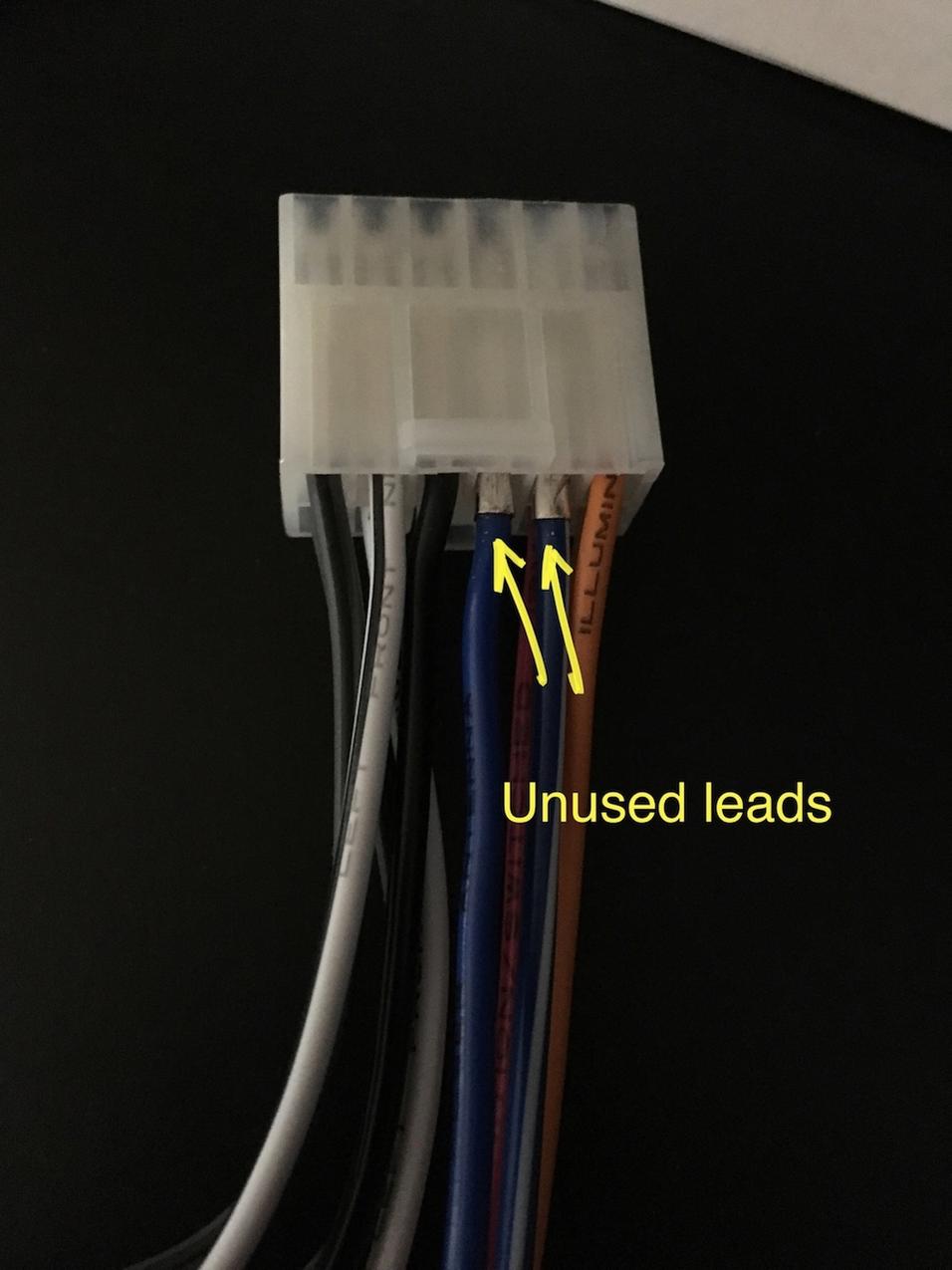

The amp is the Kicker Key180.4. The harnesses were purchased through Amazon because Crutchfield didn't have both of them. They are Metra brand part # 70-1761 and 71-1761. I took pics of the harnesses because I had to make a slight modification to accommodate one wire (dim wire, according to Crutchfield). Fortunately, there were antenna motor wires not being used, so I pulled them and moved them to the other pins, where needed. No pics of the actual install though. Too hot here in SoCal, so I didn't want to spend any more time in the car than I had to! Pics of the harnesses to follow soon...
Here is the harness setup for the 5th gens (although the packaging indicates that they'll work on much older T4R's). The harnesses are well labeled and appear to match everything with the factory harnesses (balance, fade, radio dim with lights, all work as expected) The larger one includes the constant power, ground, remote, etc. The one exception was the 'dim' wire.
