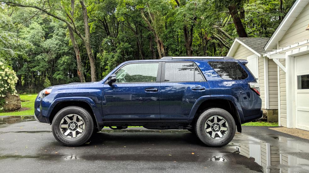

I know this post is about a year old, but just wanted to confirm that it seems like it's normal for the factory rake to be 2.5" higher in the rear. Just got a 2018 4runner TRD ORP w/ KDSS and just seemed a little much. Measured on a fairly level surface from the center hub to wheel well. Same side to side, but between 2.375" and 2.5" higher in the rear. Not planning on leveling it, but might upgrade the suspension shocks, next spring.
If that difference is normal than it is what it is and I'm fine with that, but just wanted to check. Visually looks a bit much. Thanks.

Normal. The rear springs are lower rate than the front, so adding passengers and cargo will progressively level it out.
Rear rake helps right age-related sag as well. So over the years it'll come down some.
Last, just carry a lil cargo and itll have less rake. The ride seems softer with weight in it, too!

Right on! Thanks for the quick reply and good to know it's normal. I think I've been looking at too many photos of lifted 4runners with upgraded shocks/springs. Makes the rake more noticeable on my stock 4runner. Doesn't really bother me so I can definitely live with it until I decide to upgrade the suspension.
