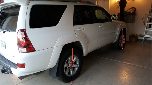

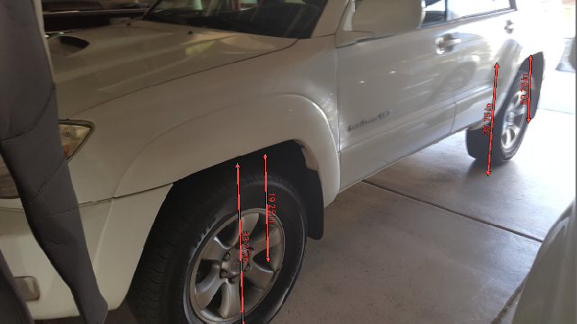

Would anyone happen know what the stock ride height on a 2004 sport with a v8 is?
I'm putting coil overs on one that has a spacer lift on it currently and I've looked here on the forum but haven't been able to locate those measurements. I'd like the hub to fender measurement if possible.
Here are some pics of my measurements before my lift. But, my suspension was sagging a lot so my 3/2 lift was more like a ~4/3 before tires.
My current ground to fender heights are around 38" in the front and 38.5" in the rear with 275/70r17 tires (32" tall) after my icon stage 2 install.

How much sag do you think you had?
Great looking truck by the way
Thanks! Probably about .25-.75"
The front was closer to .75 and the rear closer to .25
My new tires added about .6-.8" to the ground to fender heights.
Sent from my SM-N920V using Tapatalk
Dammit man, I've looked and looked and not seen those, it appears that the 19/21 is going to be close enough for what I'm looking to confirm, I just didn't want to get much past that 3".
