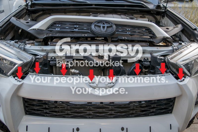

Now you need to remove two retainers and a 10mm bolt seen here. For these clips you need to raise the center portion rather than pushing it down. I use a small blade screwdriver to pop it up and then they can be pulled out.
Front%20Bumper%2010%20of%201_zpsn8b1xydg.jpg~original

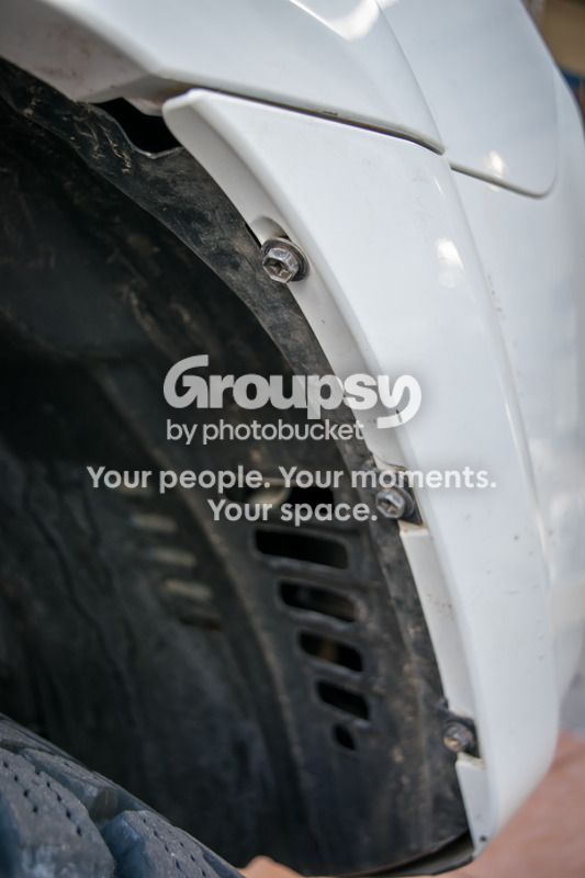

Next you use a 10mm wrench or socket to remove the three screws in each wheel well as seen here
Front%20Bumper%207%20of%201_zpsti2thgm8.jpg~original

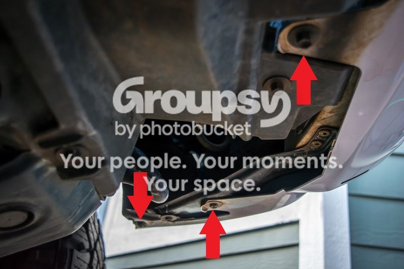

Now you need to crawl under the front bumper and you will see there are six bolts/screws holding the bumper on. This picture is looking towards the drivers side and you can see three of the bolts/screws. They are the exact same on the passenger side. Again they are all 10mm

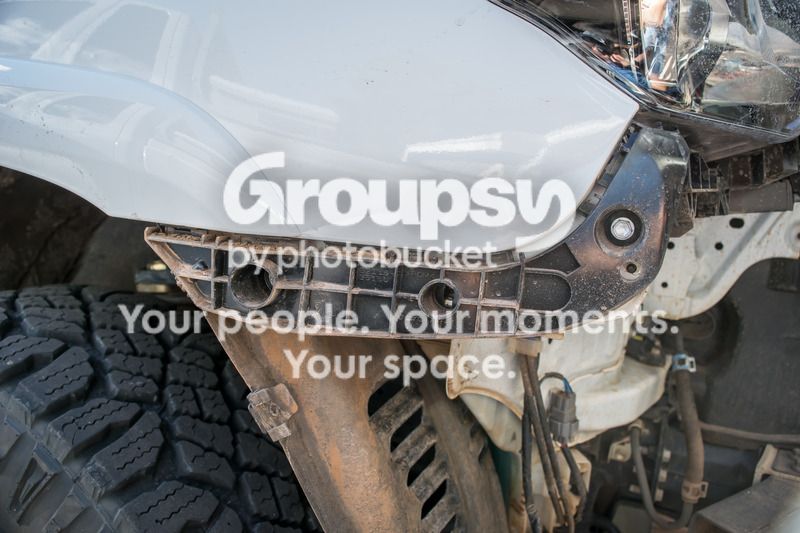

The bumper is now loose and can be pulled off but keep in mind that on each side where it meets the fender, you need to pull out rather than pulling the entire bumper forward. So start on each side and pull the bumper out towards the sides to get it free before pulling the entire bumper off the truck. Here you can see the ledge that the bumper sits on, on each side of the truck

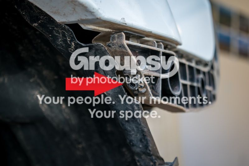

When pulling the bumper to the sides, another thing to keep in mind is the top wheel well screw, screws into a protrusion that the bumper sits around. So you need to lift the bumper over this protrusion to be able to pull the bumper out to the sides. You can see the protrusion here
Front%20Bumper%206%20of%201_zpslfig4hxx.jpg~original

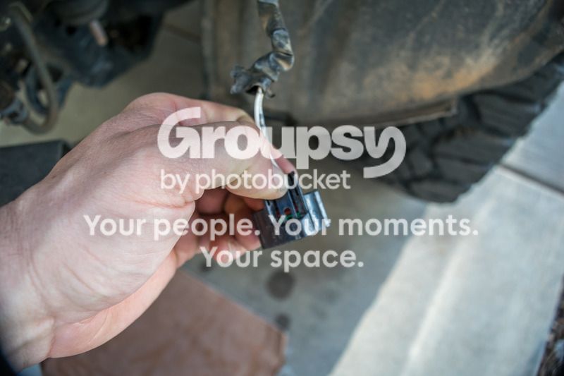

With the sides of the bumper pulled out, you can now pull the entire bumper forward and it will come off the vehicle. However, the bumper will only hang as the fog light wiring is still attached. They are simple snap connectors that you need to remove to get the bumper fully removed

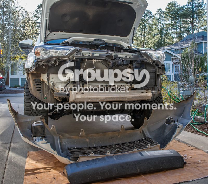

Now you have the bumper completely off the vehicle
Front%20Bumper%204%20of%201_zpsxfiezhxb.jpg~original

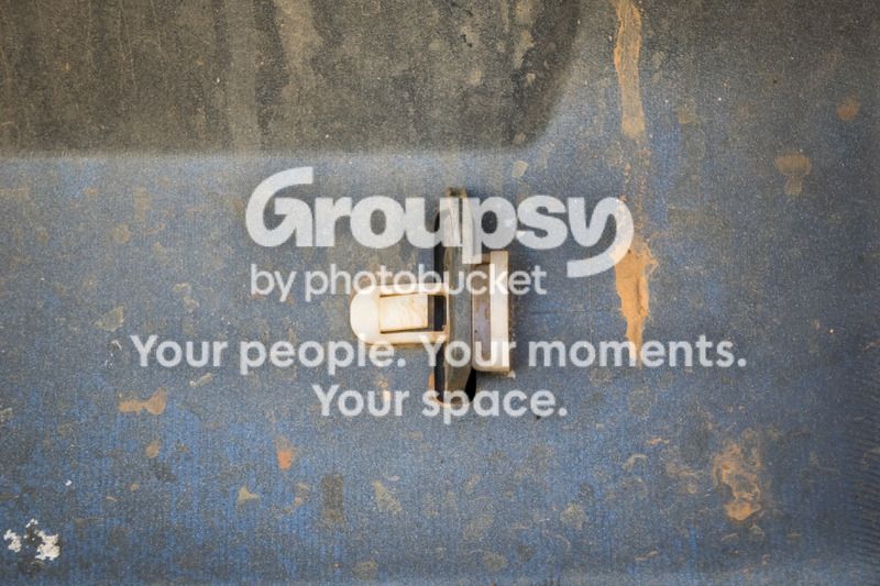

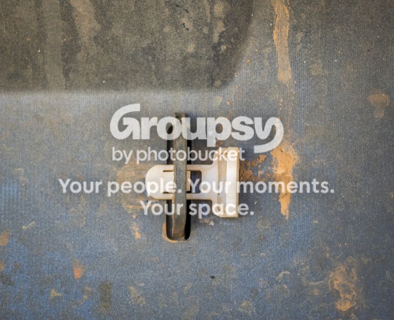

If you also want to remove the front valence from the bumper, there are 13 retainer clips holding it onto the bumper. You just need to depress the clip and slide each one out the to side as you can see
Front%20Bumper%202%20of%201_zps2mz1eb8o.jpg~original
Front%20Bumper%203%20of%201_zpsdcfsww3r.jpg~original
