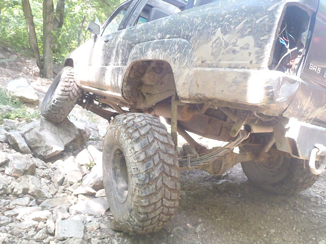

Heres one of those imaginary off road trucks.
Its all fake, believe nothing! hehe.
My SAS cost about $2500 total, for front and rear suspension and shocks, not to include any shop fees.
Coils are better, however, dont think that leafs wont get you by. There are TONS of people running leafs. They cost less and are much simpler to set up.
