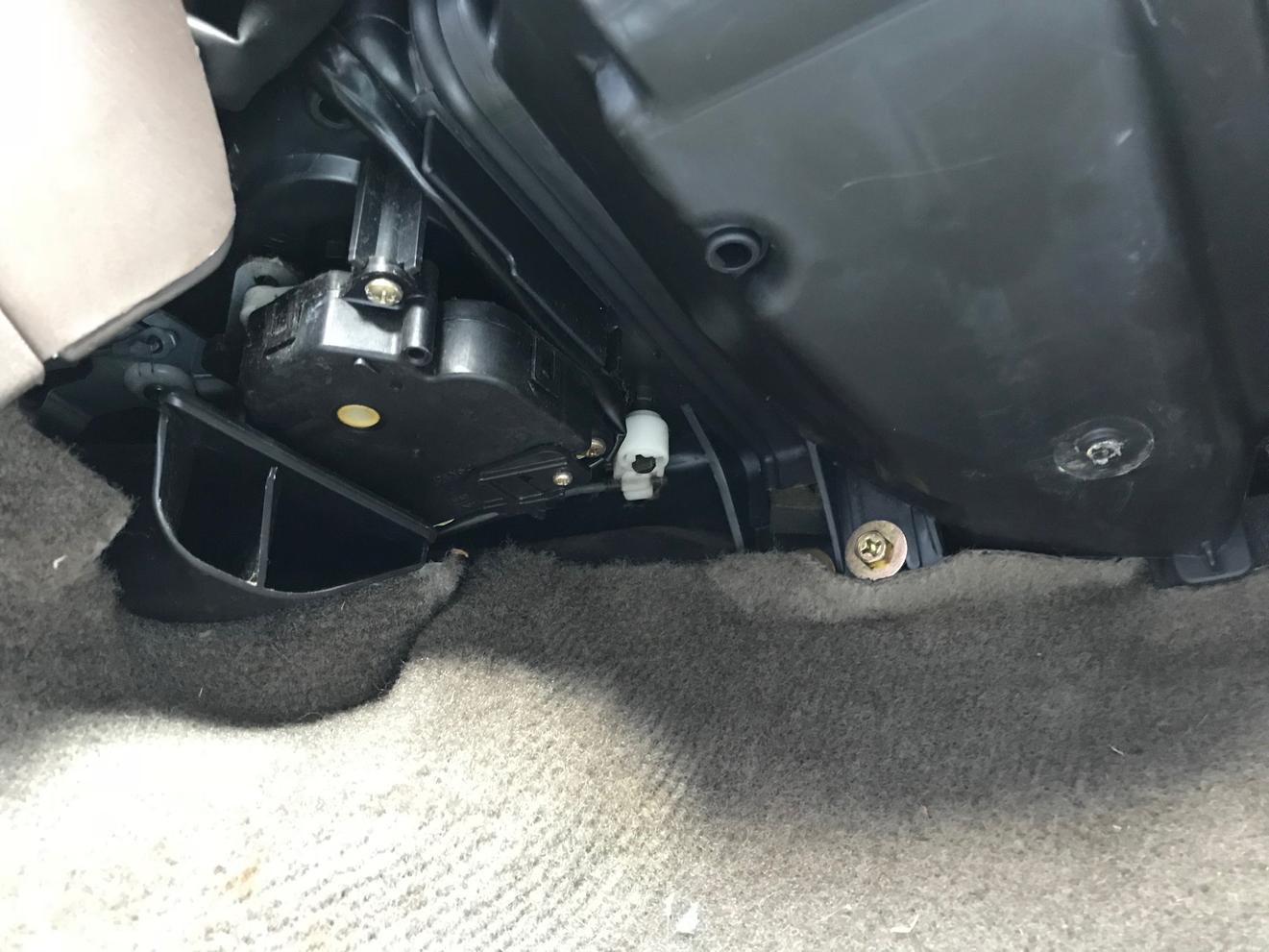

2002, 271k miles.
The part in this photo with the little yellow sticker started buzzing about a month ago. If I knew what the part was, I could diagnose and fix it but don't know where to start. Can someone simply tell me what this is and why is it buzzing?

If this is a Limited model I would imagine that is an actuator for the automatic climate control (for controlling where the air is directed)
I have a 1999 with auto climate and that part is called or at least from what I understand is the blend door actuator. It's simple to remove just a few fasteners hold it in. And it has a big gear inside that strips out. If this is the problem like it was with mine all you do is take it apart flip you gear around 180° and use the un used side. Try that out and get back to use.

Could be something rattling around in the HVAC fan. If that's under that thing. Can't quite tell from the image. Pull the screws and empty it out. It's pretty simple if that's what it is.

Thanks Jeffh, looks like a blend door actuator, never knew what that was. The Haynes manual has nothing on it. I hate just unfastening things without a guide but sounds like its easy to flip that gear with minimal trouble. Also, an awkward place to get at. Thanks for the lead. I will take some photos and post when I tackle it.

It's either a air mix servo motor, or the mode select servo motor.
Try changing the temperature and if it makes the noise then it's air mix, but if you change the mode (face, floor, defrost) and it makes the noise then it's the mode select servo motor.
That is the blend door actuator for the automatic climate control. I purchased a new one a few years ago after mine went all haywire. Before I bought the new one I did the "flip over the gear method". That lasted a while but now I'm just going to replace it all together.

Cable lube for dirt bikes should work. And there is a rubber gizmo to aid in spraying/getting the lube into the cable jacket.

I just picked up some TriFlow lubricant today. It is a teflon base, so similar product. I am going to head out and clean all the gunk from the linkages and cables, and apply some of this TriFlow to everything a few times.
Ok well the TriFlow worked well. I'm going to start a thread of my repairs for those interested.
